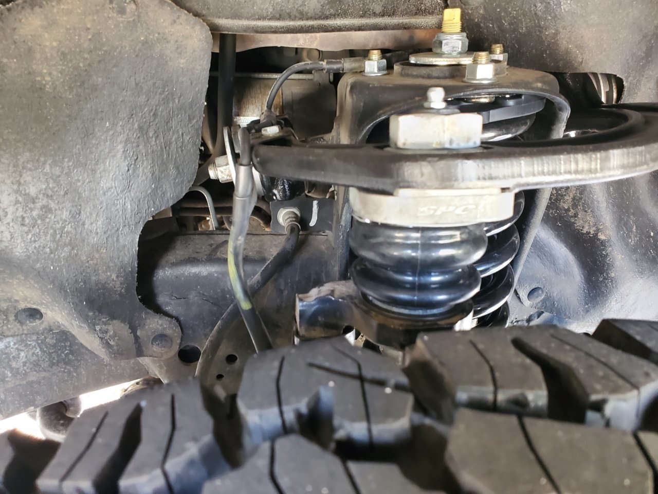

    I have spc on mine

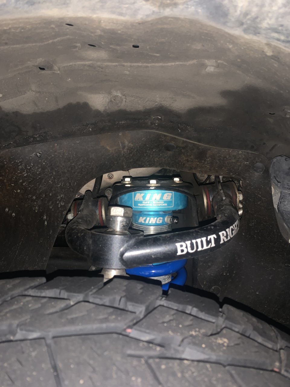

    I picked up some TCs before Christmas and plan to install this weekend. I’ll try to post up some pics

    I went Total Chaos with my King set up. Couldnt be happier.
  19. Jan 28, 2021 at 5:17 PM
    #19
    jbrandt
    jbrandt Made you look
    Feb 12, 2011
    #51038
    17,612
    Justin
    El Dorado, CA (NOT El Dorado Hills)
    '04 TRD Tacoma 4x4 DC
    Kings, J59's Total Chaos UCAs Custom skids Sticker mod
    Those look identical to Total Chaos, except black.
