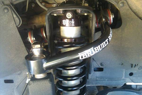

    all pro's long travel arms, and Icon's mid travel arms have what they call dust caps over the top of the uniball. if you can weld, you can make your own bolt-on caps.

    but the bottom is still exposed. regardless, a good uniball shouldnt be affected by the elements. Many have reported rust, and corosion, in the snow belt. My self, Im on 5 years of the TC's without a rebuild, and have had concrete dry on them, had then submerged continuously for hours, mud, etc., and have no noise, or other issues. I lube and clean them once a year.....if that.

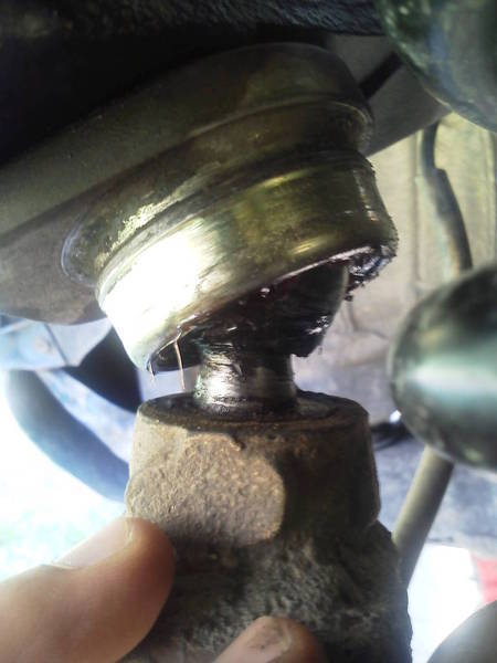

    yep, but you don't have gravity holding debris in the puttom. only real reason stuff would stick to the bottom is becasue of overlubing.
    salt is a who other issue though. stainless replacements for that.
    as for the balljoints, Light racing just recently redesigned their balljoints and the grease boots. the boots fit a lot more snug than the old style, but it's never a bad idea to check the grease every once in a while. as for the joint itsself, one of the wear compontnets on the internals of the joint (i forget the technical term) was swapped from a natural material to a synthetic, that they say is supposed to last longer.
