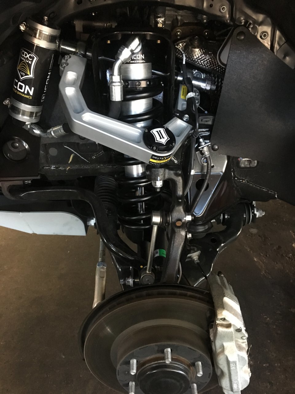

    I have not had any issues with my ICON Billet with Delta Joins...But they are pricey...IMG_3205.jpg
