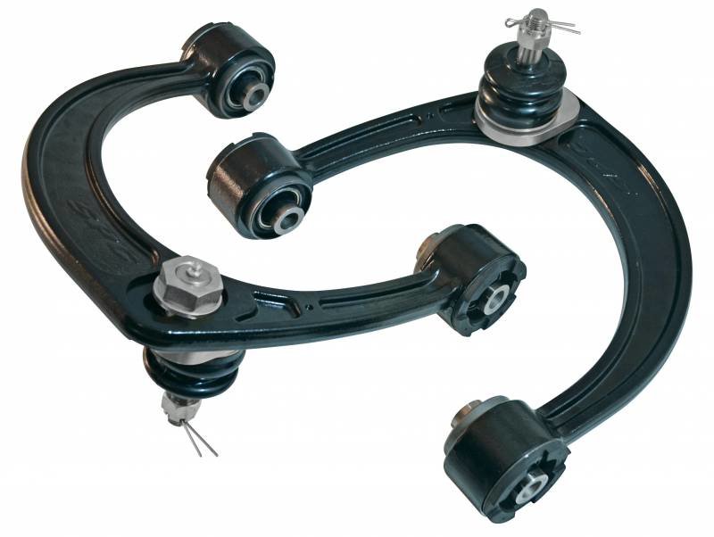

    Regarding SPC arms. They redesigned the arms, anyone know what the difference is between the two? Any have a part number for the latest version? Trying to shop around for a price but making sure I get the latest version arms.

    Part numbers are the same (25470). The arm is fully forged now versus partially forged with a tube section welded on. Headstrong has the newest version.

    They have been forged for a while. The difference is the bushings.

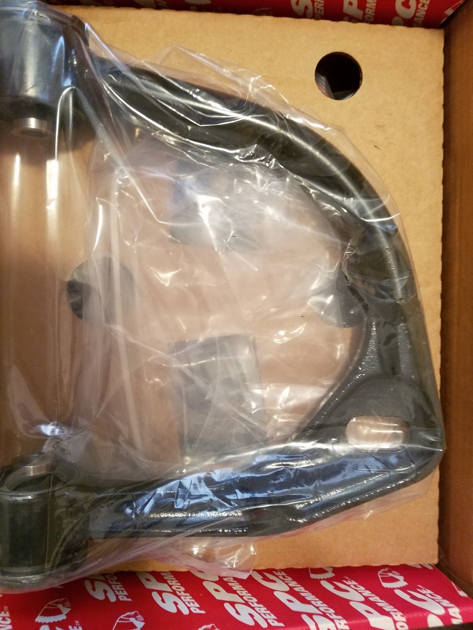

    The bushings did change a year or two ago. The arms also changed to fully forged earlier this year. At first I had a hard time getting the newest version. I had to send a few back then ended up ordering from Headstrong.
    Hard to see but this is the partially forged with the tube welded on.
    Here is the newest version.

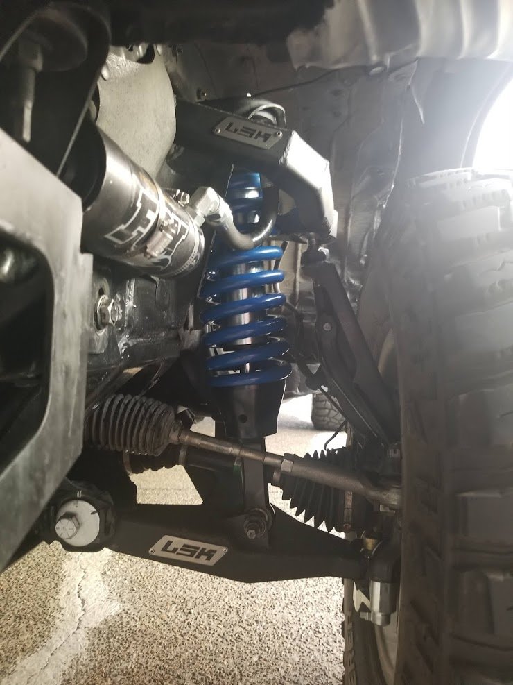

    I talked to LSK suspension and they are willing to do a 10% discount for TW members. Dont know it that is just for me or everyone on here. But thought I would spread the word. There boxed arms look so rad.

    Bushings changed in the last several months. My SPCs are only a year old and don’t have the new goochie bushings.
