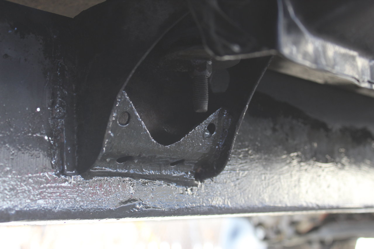

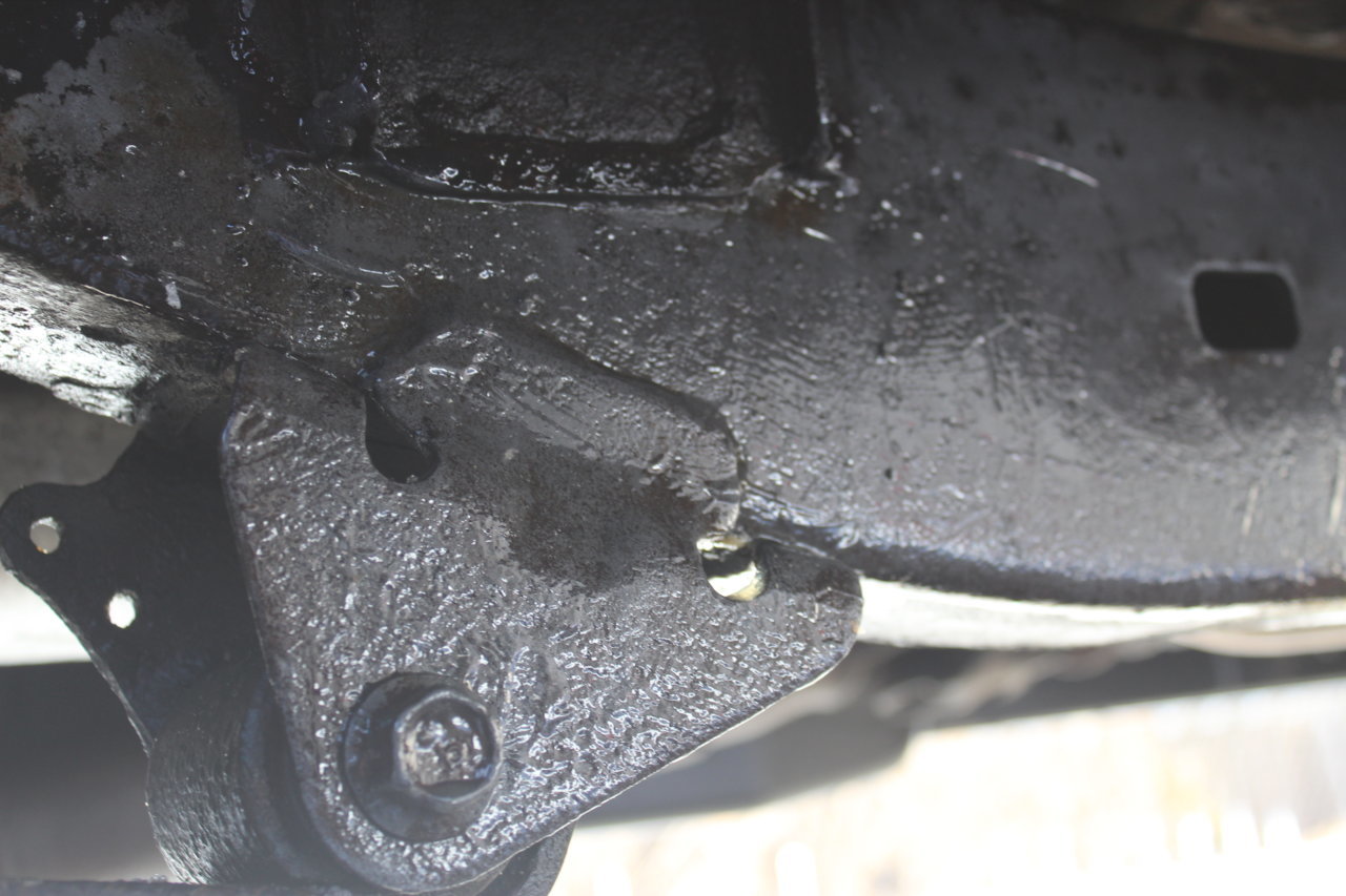

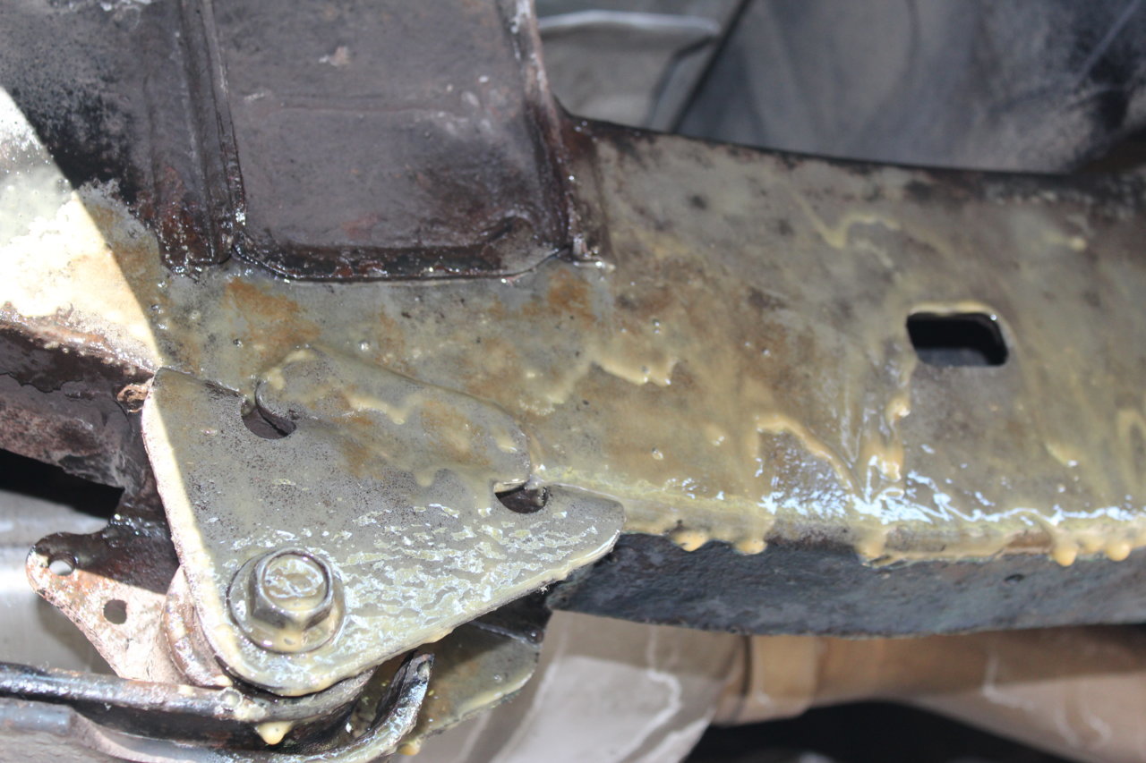

    the FF is not so durable in my pressure testing, i don't know what went wrong!?!
    it failed the big time to protect my clean(ish) frame from flash rust :bananadead:
    the FF on the bottom of the frame seemed to be ok, not really exposed to heavy washing or splashing yet, but it definitely did not protect the side from undercarriage washes months ago, i let it go to see if flash rust developed, and IT DID!
    and i was most upset FF just washed right the hell off when i was hosing my wheel wells out from the winter slop buildup as i have always done

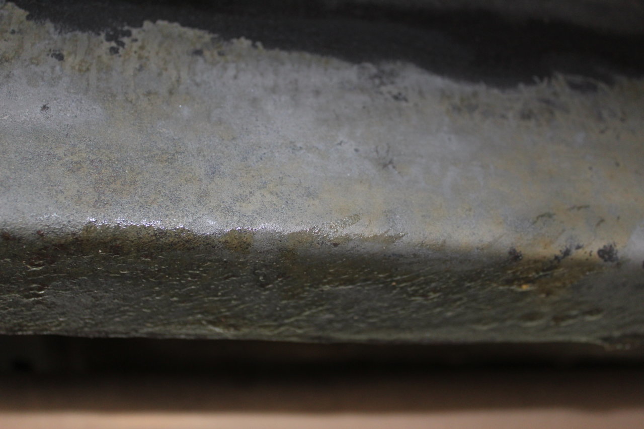

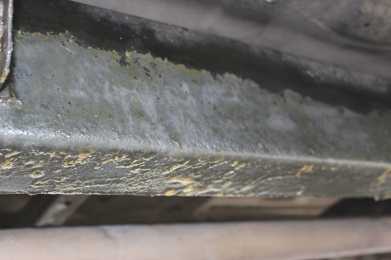

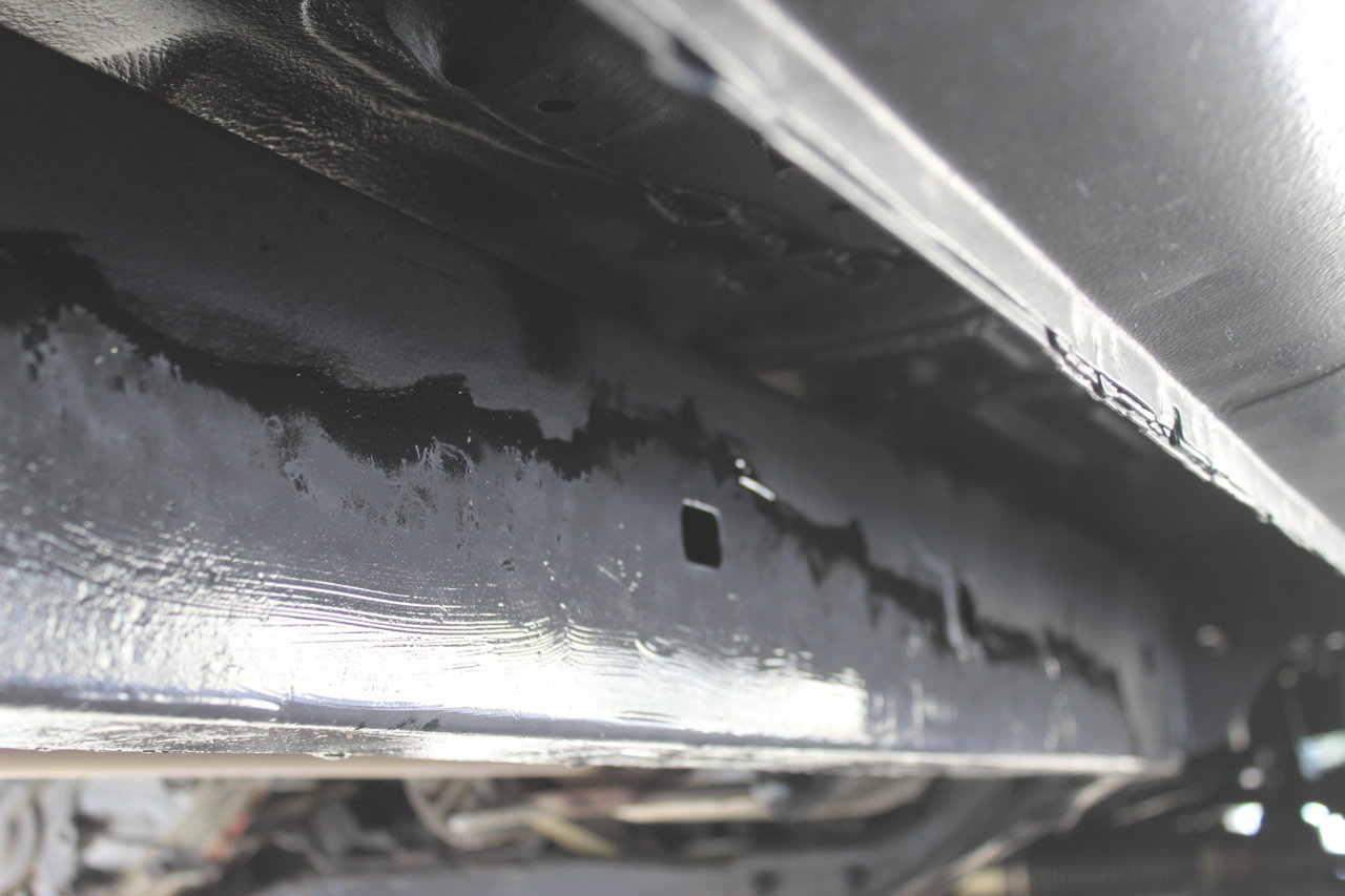

    going to give CF 3000 a try for durability, it went on smoothly with foam brush, very clean and clear, no drip and no funky smell!
    cleaned flash rust off with phosphoric acid afterblast, but the area by the perch in the wheel wells was toasted and the rust had started etching the metal and was not able to be just wiped off clean
    ^^^^ there is mild rust under this gel that would simply not wipe off like the other section did, so hoping it stays put until spring/summer
    only time will tell once i have to hit the power sprayer at the ghetto wand wash
    below is what the FF looked like last fall after heavy application...
    here it is, the FF already starting to come undone through the under wash
    after another wash below
    where the heck did the FF all go?
    crap, it just melted right off and flash rust starting it looks like
    the bottom of frame stayed on well, but not the side for some reason
    this does not seem durable at all for the sloppy mid west winters, not at all!
