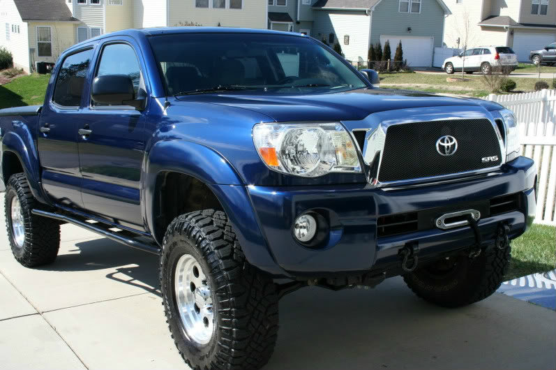

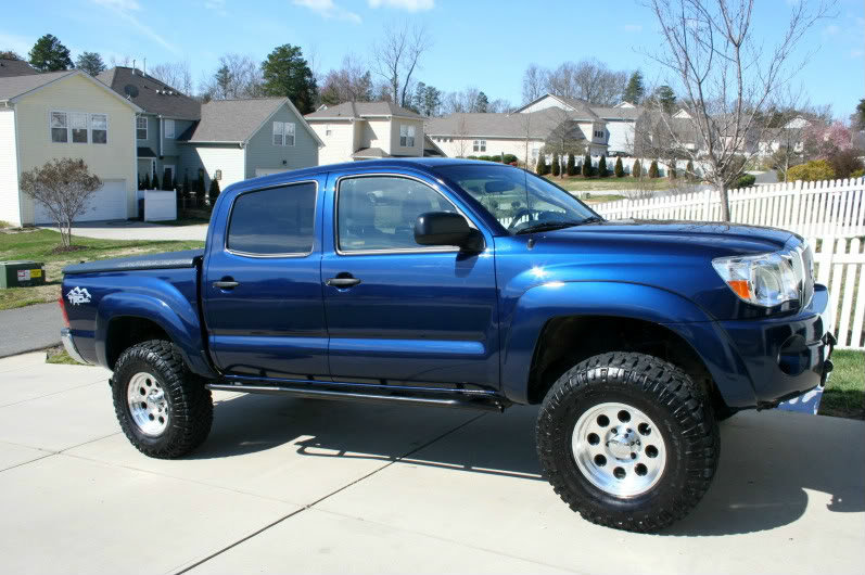

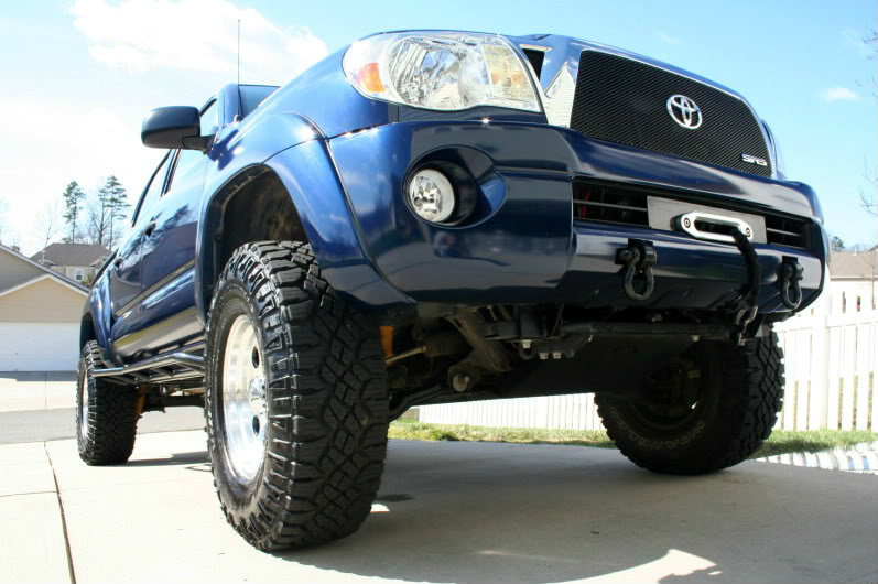

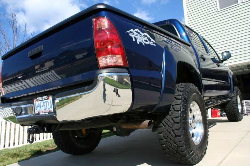

  7. Feb 25, 2012 at 4:22 PM
    MadToy
    MadToy Well-Known Member
    Nov 19, 2011
    #67334
    824
    Nick
    Huntersville, NC
    07 Midnight Blue TRD
    OME 886, Dakar leafs, LR UCA's, 16x8.5 Level 8 ZX, 315 MTR Kevlar, All-Pro sliders, BudBuilt skids, Undercoverhwms winch mount, Warn M8000 with synthetic rope, ATO Hi-Lift bed mounts, Diff locker override, Hitch harness relocated to bumper, Undercover bed cover, Gromm Aux adapter, Grillcraft grill, DT pipe bombs, Custom Magnaflow exhaust, Brute Force HC bumper, TRD Supercharger
    Huh? They have a 4.5" backspace just like every other aftermarket wheel. They don't stick out much past the fender unless you use spacers.

  9. Feb 25, 2012 at 4:38 PM
    MadToy
    Nov 19, 2011
    #67334
    824
    Nick
    Huntersville, NC
    Yep. Basically, most aftermarket wheels are going to be 8" wide with either 4" or 4.5" backspace. The less the backspace, the more the wheel will stick out. If you're putting the stock size tire on, and want it tucked under the fender, you'll need to find a wheel with 5" or more backspace, which will limit your choices.
    If you want a deep dish, that would mean less backspace - in the 4" range, or wider wheel - both of which will stick out quite a bit more than what the Zuma's do.

  11. Feb 25, 2012 at 4:52 PM
    MadToy
    Nov 19, 2011
    #67334
    824
    Nick
    Huntersville, NC
    I agree. But 8" x 4.5" backspace is the most common aftermarket size for us. There are much fewer options though for narrower or positive offset wheels. Stock FJ TRD wheels would be nice. But there's no way of getting a deep dish without sticking out some. And the Zumas don't have a very deep dish.
