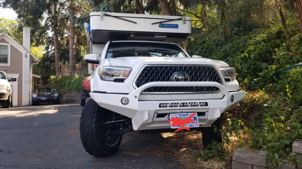

    I vote Warn as well. Here’s mine hidden behind the hinged license plate in a CBI T3

    That's a horrible picture of your winch.

    That's exactly the point, its hidden from view. Driving around the world I want a understated a truck as possible
