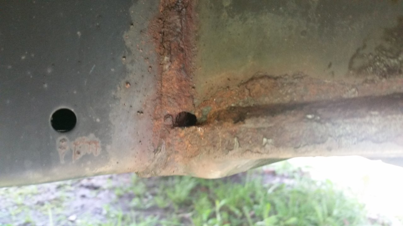

    These are rust holes on my 2012. Of course now that I posed these some one here is going to start laughing at me. All I can think of is recycled steel.
