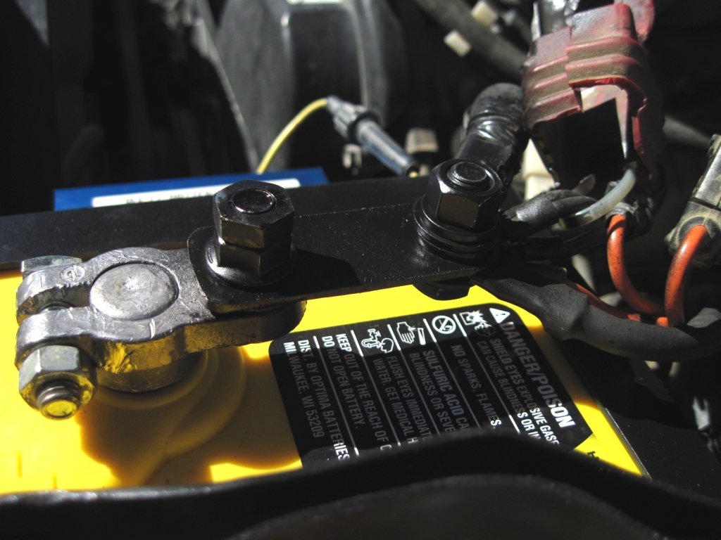

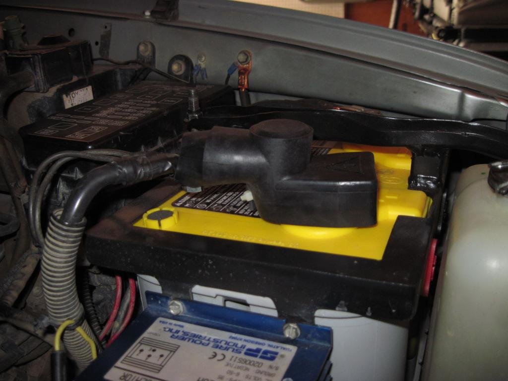

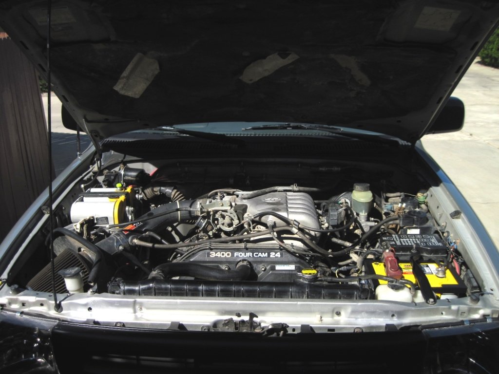

    I like my 34/78 YT's...
    I did have to modify the upper hold down
    for the house battery...
    and extend the cables slightly.
    the cable extension is due to the fact
    that the 34/78 positive terminal is on the opposing side
    then is what the oem battery is.
    so in other words...
    a 34/78 would need be position 180*
    and tho now the terminal is on the correct side...
    The Pos + cable will be too short to reach.
    I needed replace the battery's ground wire with a longer one.
    The cable to the fuse box was long enough, if I remember correctly.
    The positive terminal extension was the most difficult...
    and I thought I remember making a splice so as to extend that.
    I also ended up using a copper buss bar
    because I must have measured a little short...
    and needed a little more extension to reach.
    buss bar...
    boot covered...
    because two are better then one !? :D
    I was committed to the Optima YT's
    because I altered the original mount to fit the house battery.
    And scratch built my Aux. mount.
    Didn't want to do another for a different battery.
    But if I were in the market for some other AGM battery...
    I would look at the re-badged Sears Diehard platinum battery...
    it is after all... an Odyssey with a different skin color.
    I'm not sure... (and someone else who has these can chime in)
    but I think the group 34 Sears Platinum
    also has the terminals on the wrong sides.
    So might still require making some cable extensions.
