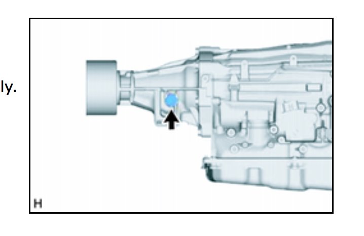

    While checking the ATF level, I dropped a small (~.5" long, tapered from ~3/8" to ~1/4") cork (natural, not rubber) into the ATF fill hole:facepalm:.
    How did this happen you ask? I was using a pump with a tube attached to it to pump the fluid from the bottle into the transmission. While I was getting set up, I put the cork in the tube to keep it from dripping all over. Got all set up, got it to temp, hopped under truck, removed overflow plug and in my haste I just put the tube in and started pumping until it came out the overflow (it needed ~1/2 quart) . It wasn't until I finished and torqued the plugs that I realized that I had forgotten to take the cork out.
    I'm not sure what I should do.
    I'm having trouble finding diagrams and/or descriptions of where this cork is going to end up?
    Does the fluid just drop down into the pan?
    Does it drop into the filter/screen unit?
    Would it be safe to just let it bob around in the pan or filter/screen until I replace the fluid (which I planned to do at 30K)? Currently has ~1K on it.

    You haven't run it yet have you? Please go get yourself a pan gasket, drain the fluid, drop the pan, and hope that the cork is there. Let us know when you find it. I'm no expert, but I'm pretty sure a cork clogging up the intake for circulating the fluid would be a bad thing.
    EDIT: actually, I believe the fill flug is on the extension housing so I don't think that plug just dropped down to the fluid in the pan. I'd recommend getting an expert's opinion to see where it actually might be. I'm just shooting from the hip, it might be easier to get a small tube with some suction on it to grab the cork. Ugh, but that's getting to sound like a sketchy situation.

    It doesn't look like that would have just made it to the pan.

    renau001: I have run it... was running when I checked/filled it and also took it for a test drive before cleaning up and realizing my f*up. I do not have an inspection camera. I have some small mirrors I will use to see if it is stuck within reaching distance (seemed there was a 'wall' not far behind the fill hole where it could be wedged). Also.. as the diagram you provided shows.... it doesn't look like a straight drop into the pan. If not in the pan.. that is the next question really... with the pan removed am I going to be able to see the path from below up to the filler hole to try to fish it out?
