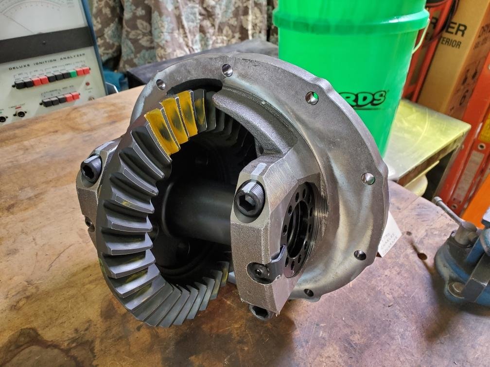

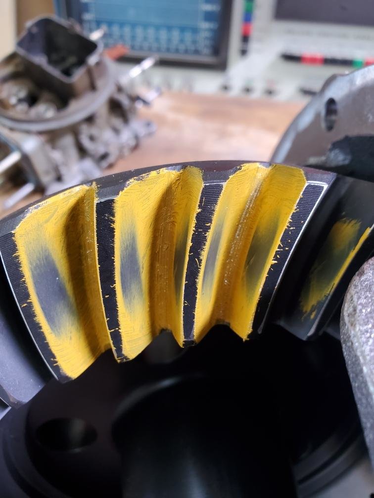

    This is my very expensive Ford 9" center section for my Camaro . The gears are a High Performance Pro gear , notice the contact patch in the yellow grease
    That is a perfect pattern and to make sure the gears are properly broken in it requires a break in procedure
    10 -15 minutes of driving gently followed by 45 minutes of cool down
    Repeat 5x's
