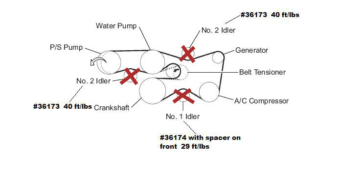

    So just recently, I can hear some whining noise coming from the front of the engine. I did some searching and came up with the idler pulleys as the possible culprit. I replaced the two upper and the one lower but the noise is still there. See attached diagram for the ones I am talking about.
    Anybody has some direction for me as to what it is making the noise. Is it harmful to run the truck like that? Will it leave me stranded? The truck has 131k miles on the clock.

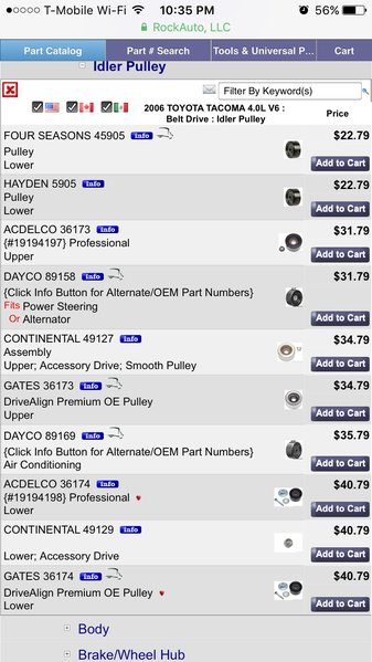

    Do some inspecting before you go and replace your alternator. Rockauto sells replacement pulleys for every part on your truck. (I'm looking at replacing a few of mine now)
