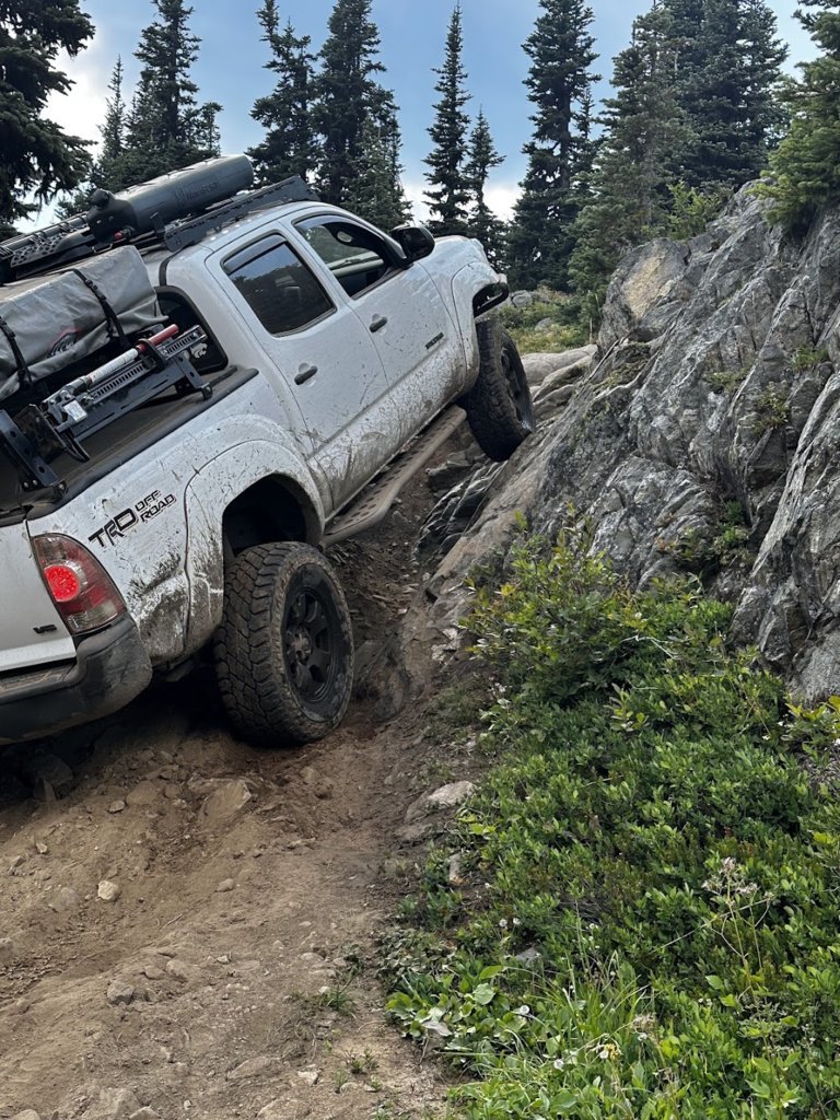

    I ended up winching up this obstacle. Video in album.

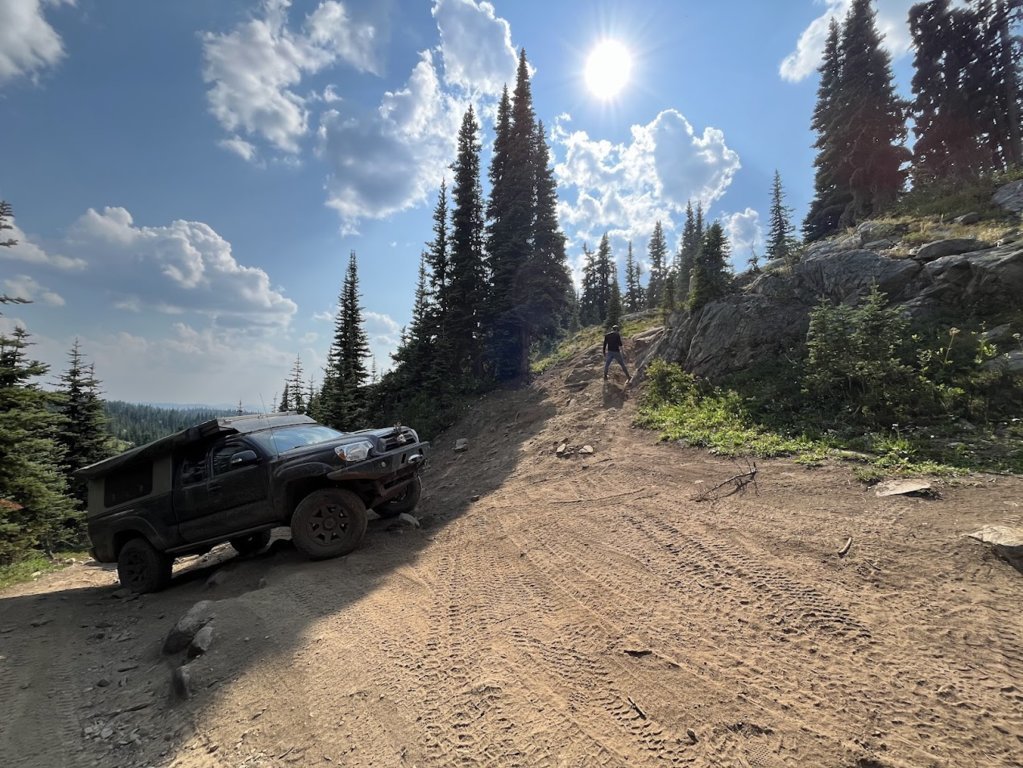

    @TomHGZ - Scoping out his destiny.

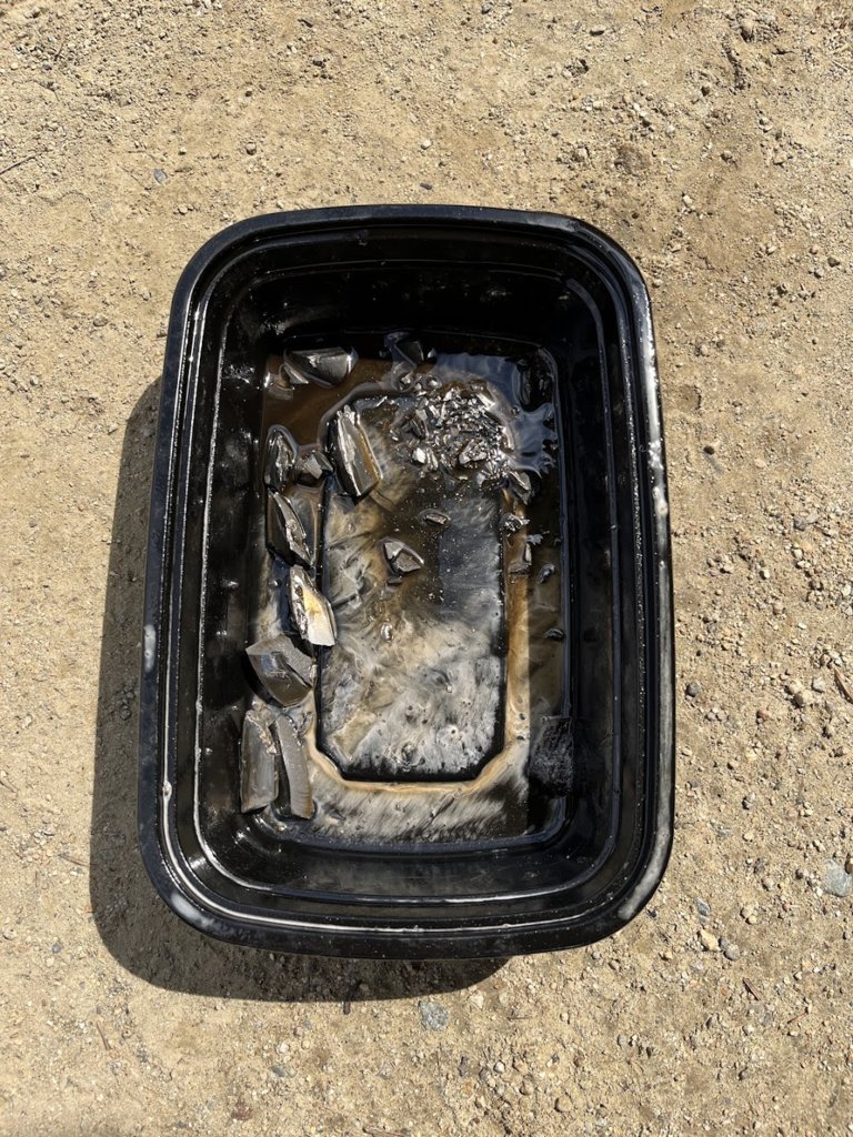

    Skip to 3:45 of this video: :nuclear:
    https://photos.app.goo.gl/TLAtcSLKtY9LSY6t5

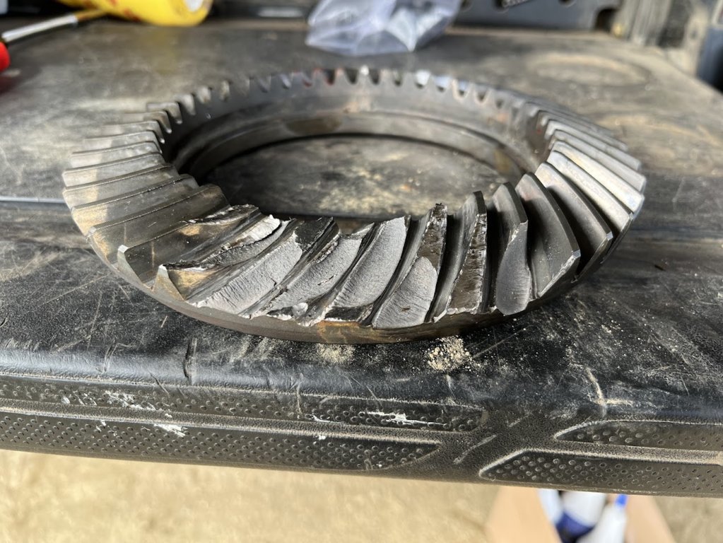

    Did @TomHGZ just limp out in front wheel drive?

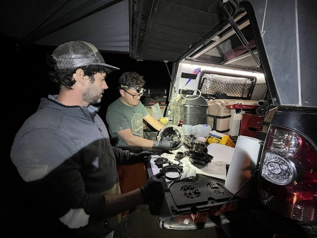

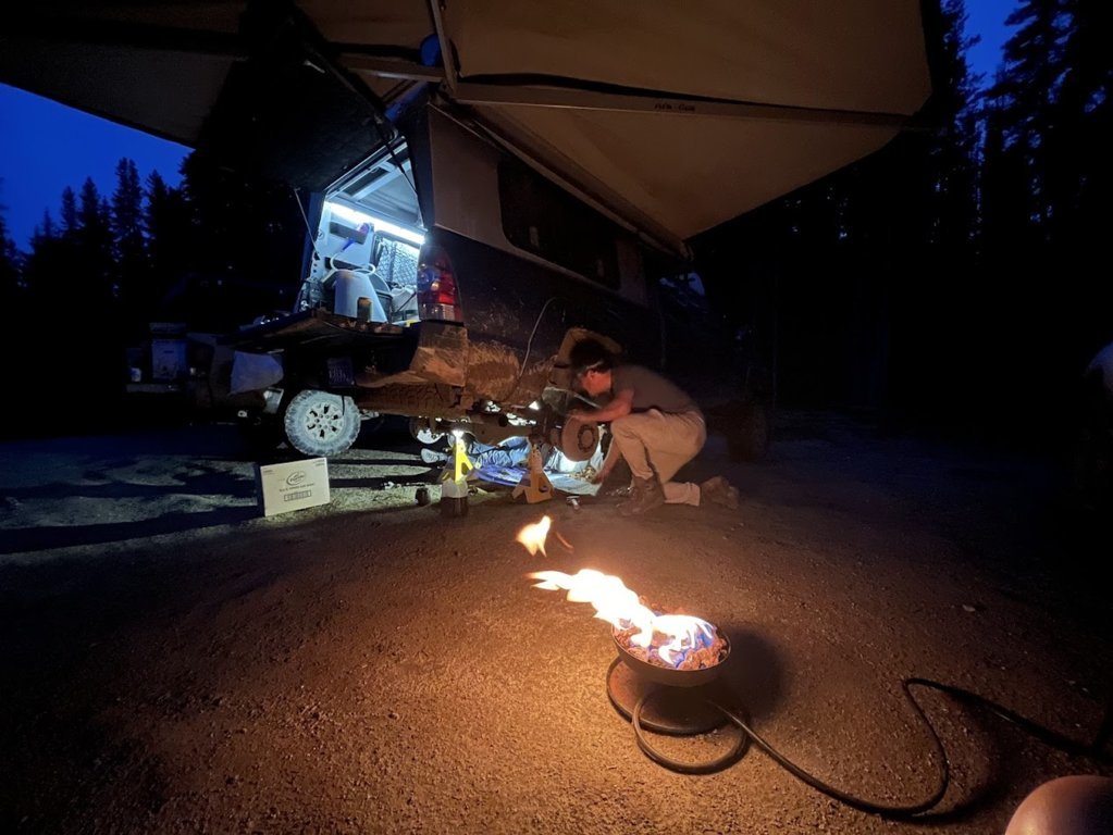

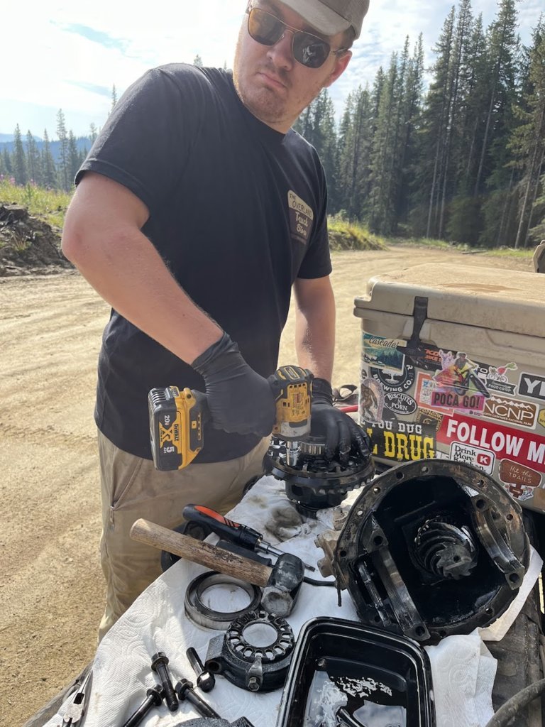

    Damn....you guys rebuilt a diff on the trail/at camp? That's epic. How was setting the preload/backlash? Never touched a toyota diff before.

    Yep!
    Lol, we hadn't touched one either before then. We just took off the broken ring gear out and put the rest of it back into the housing. I don't even know what preload/backlash is. :rofl: A put it together the same way you took it apart situation.

    Just installed a 3rd gen OR axle with the 8.75 diff and 4.30 gears under my 2nd Gen Tacoma. It turned out to be a direct swap!
    @Shadowhunter came to the rescue with his knowledge of brake drums to fish out the 3rd gen e-brake ends and reconnect mine to the new axle. All in all, the swap was pretty straightforward.
    I also worked with Josh at Freedom Locker/ Experimental Designs (@ExpirementalBiz on IG), who developed a custom wiring harness for me to operate the 3rd Gen locker in my 2nd Gen truck. Stay tuned for details — he’s going to offer this wiring harness for sale soon!
    While we were under the truck, we installed Bilstein 5160 shocks for a 2021 Tundra in rear, to maximize travel and provide increased damping for my heavy truck. These turned out to be a huge upgrade from my B110’s. Also threw some @ARCHIVE Hammer Hangers under there and some chopped bumpstops from a Ford F250 to fill the gap until/ if I decide to get something different. Again, big thanks to @Shadowhunter for the help.
    And yes, I limped back from Canada to Seattle in front wheel drive, with a front autolocker to boot. @JasonLee
