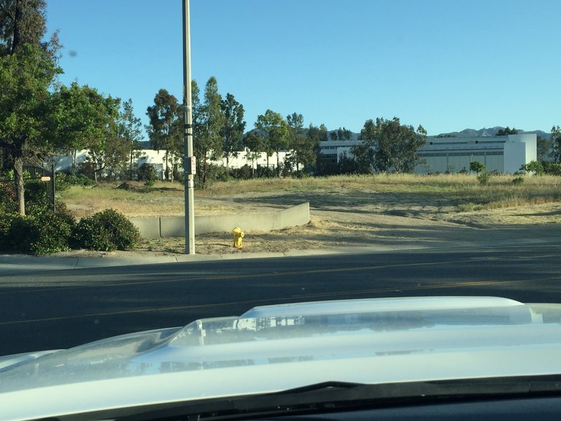

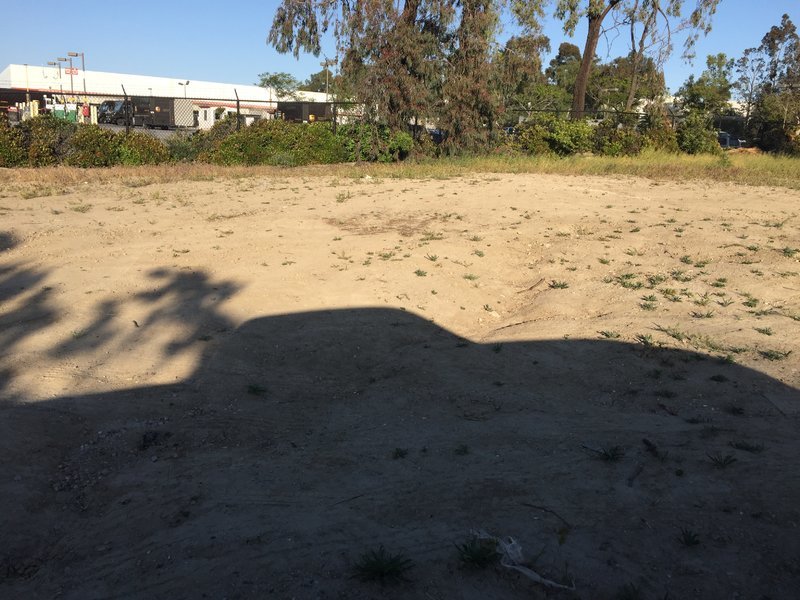

    Right, it's some kind of bearing making a noise. And btw, this is the surface I drove on when I first heard the noise.

    I'm just checking back in to say that I have listened intensely yesterday and this morning for a noise, mine makes no odd noise, or at least I can't hear any noticeable change in frequency. Tested it while driving around town and while going through a drive thru (windows down too).
    I don't think that road you posted would have done anything to your truck. If your truck couldn't handle that, something was already broken before.
