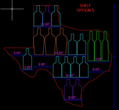

    The main issue I have with using pallet wood is my shelving design is all over the place and my fall between some seams.
    My current design:
    It's a bit random, but this fits the most bottles within the "border" of the outline. If I had a bunch of Wyoming distillery bottles this would be a lot easier. :rofl:
    Yeah... I modeled some Texas distillery bottles to see how they'd fit together. The two smaller empty shelves would host distillery glasses or similar type items.

    Spelling is overrated ... and I'm totally digging the design still.. It's likely going to be some trial and error with the process and finish. Excited to see how this turns out! Also.. I feel like you can squeeze some shot glasses in over in the El Paso area

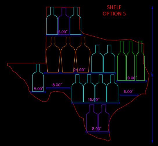

    There we go... lined it up with the main shelf, too. I imagine I'll have french cleats on the back of wall hanger directly behind the top 12" shelf, the main 24" shelf, and the lower 16" shelf. Should be plenty secure on the wall there, and spread it across a few wall studs... think that'll work out?

    I think that will be perfect! What is the wall construction that our hanging it on? By that I mean drywall, open , plaster and lathe? Hopefully finding the studs won't be too much of a pain.

    So to hide L brackets completely you have to cut the drywall over the studs. Mount heavy duty steel to the stud put the drywall back patch and paint. Then you slot the wood either with a long router bit or cut a slot out then reattach the a lot you cut out and fill/sand seams.
