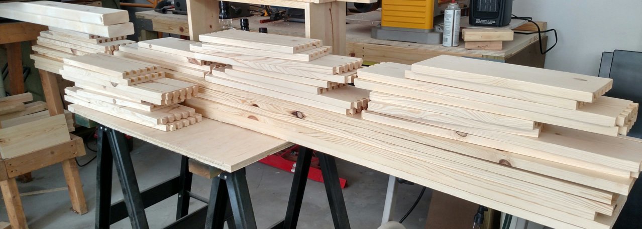

    32 boards.. sanded 3 times each 80/120/220 grit... Ready for some stain...IMG_20200609_130951.jpg

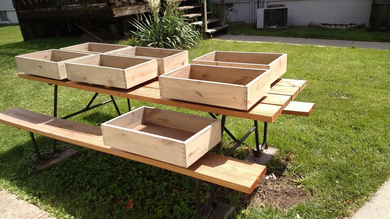

    Got the insides of all the boxes stained. IMG_20200609_140404172_HDR.jpg IMG_20200609_142418.jpg

    if you wipe witha damp cloth it will raise the grain some when it dries then sand again. This will reduce the raised grain when you apply the stain

    Too late for that!! Plus...these aren't cutting board so I am not too worried about it being perfect.

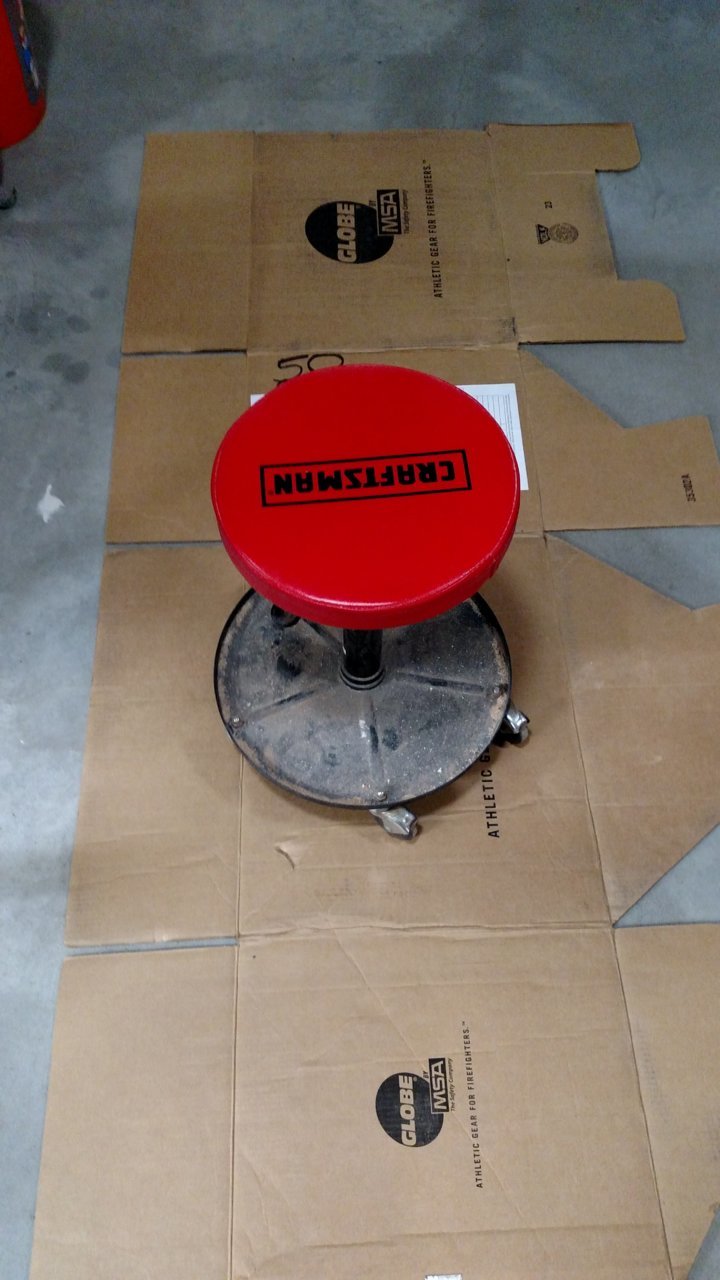

    A Craftsman stool that spins works pretty good as a base to set things on when painting or stainingIMG_20200610_100908410.jpg

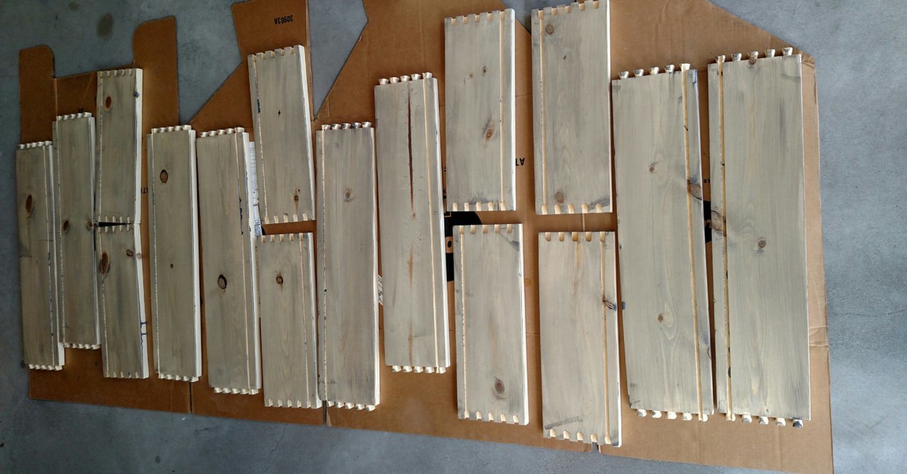

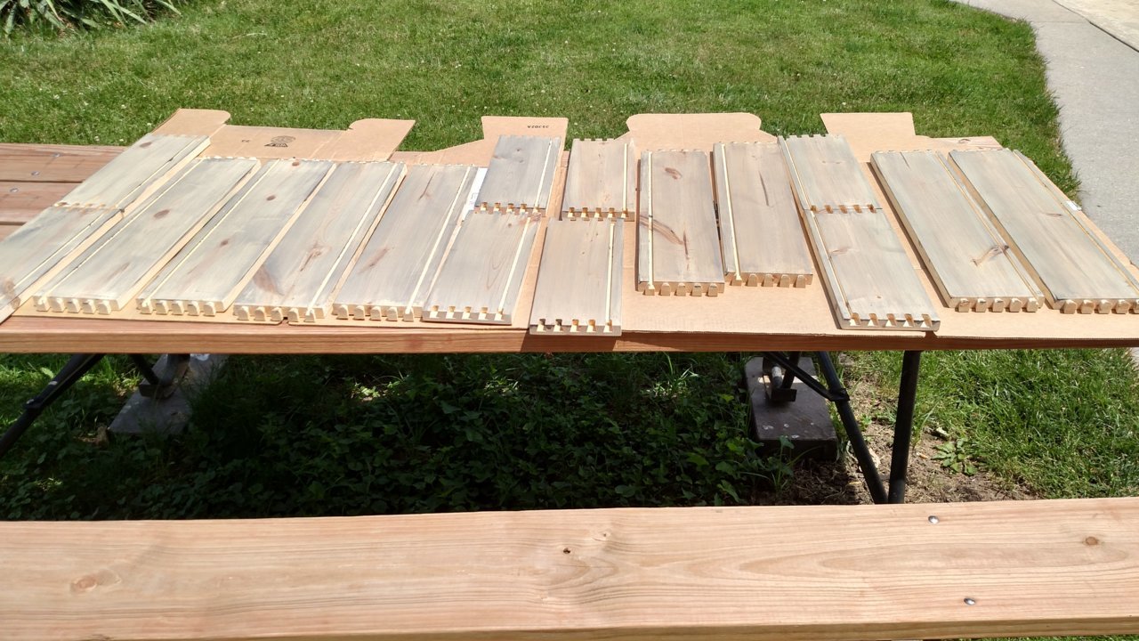

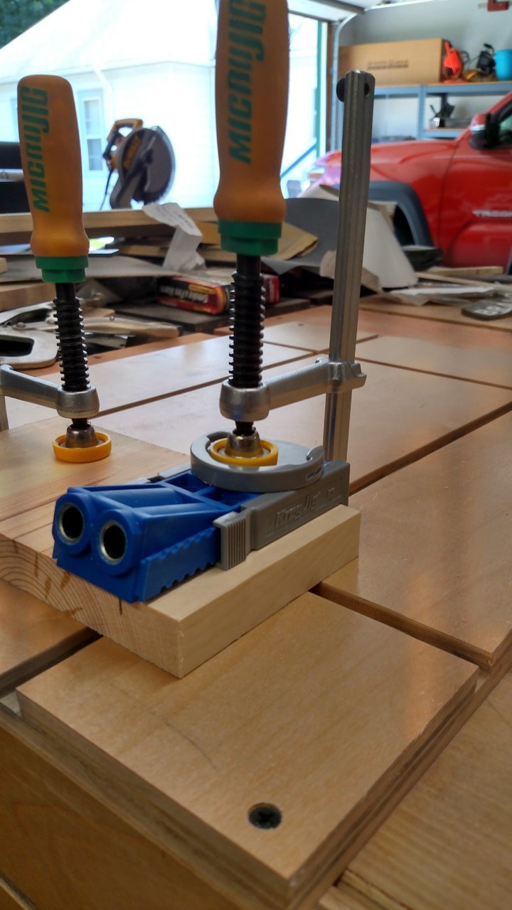

    Micro jig and Kreg jig working together

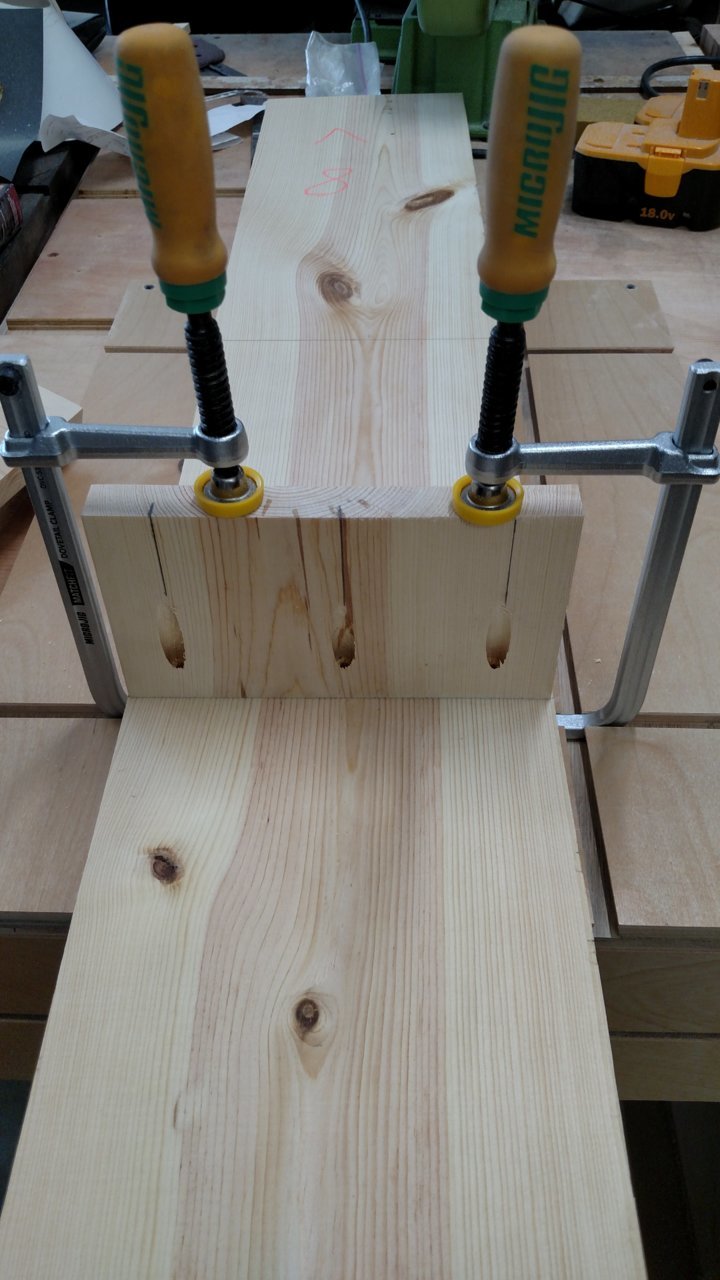

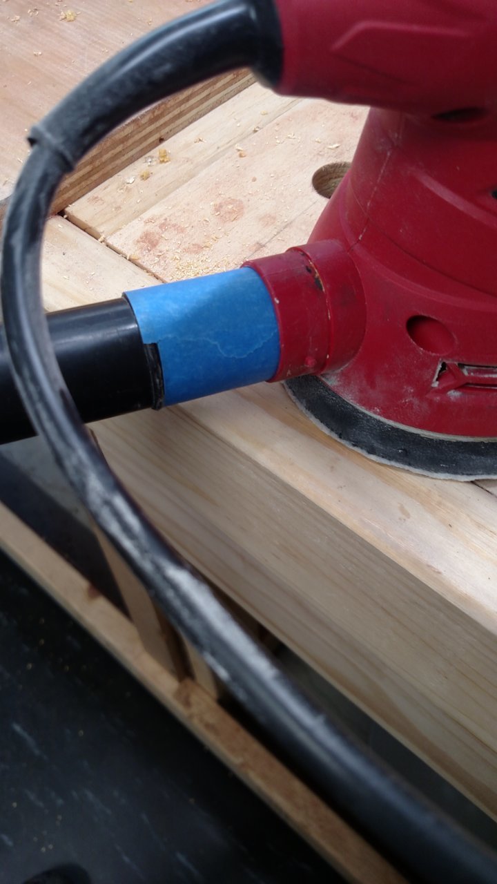

    Seriously need an adapter from the shop vac to the orbital sander.IMG_20200610_132632635.jpg

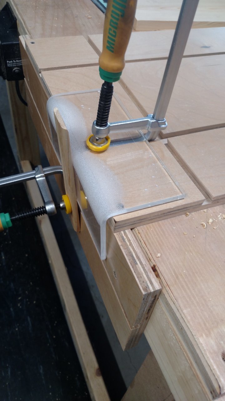

    A clamping area and a blow torch helps bend 1/4 inch plasticIMG_20200610_172338548.jpg

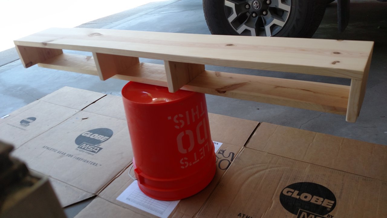

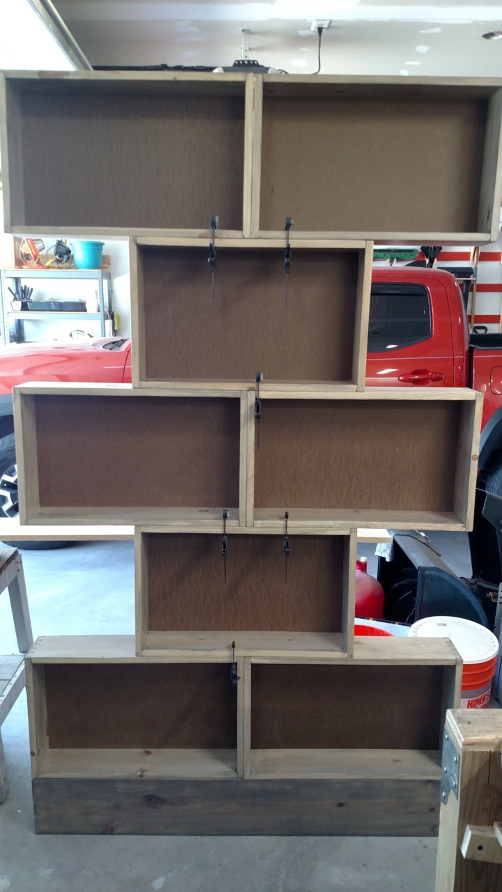

    Finally! Something other than a box! How about a base for the boxes! IMG_20200610_134411039.jpg
