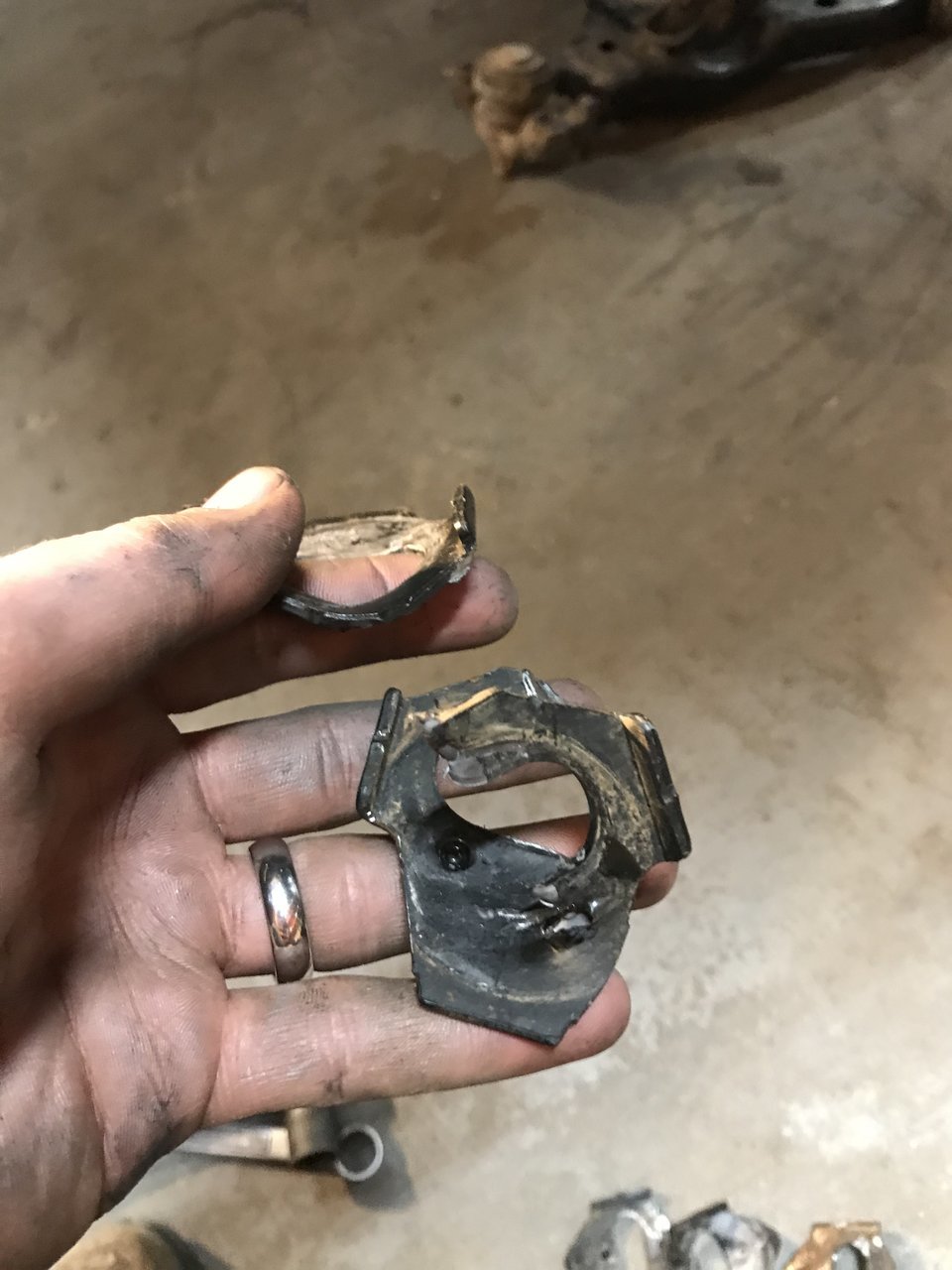

    One of the cam tabs on the passenger side is flattened for sure. I'm pretty sure if we try to bend it back it's just going to snap.

    I did the weld reinforcement thing on my tabs, worked well for me. TC tabs are the better solution.

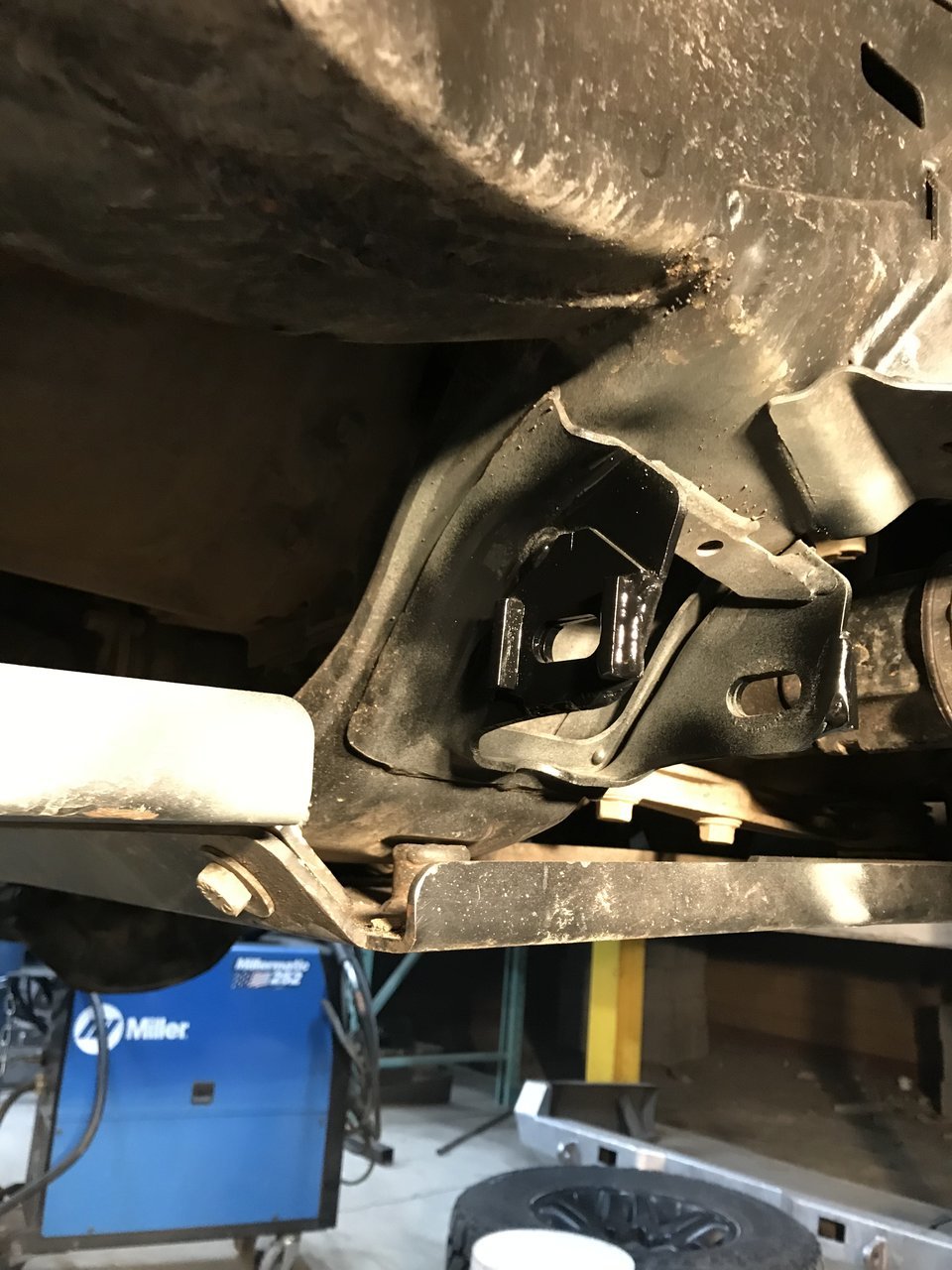

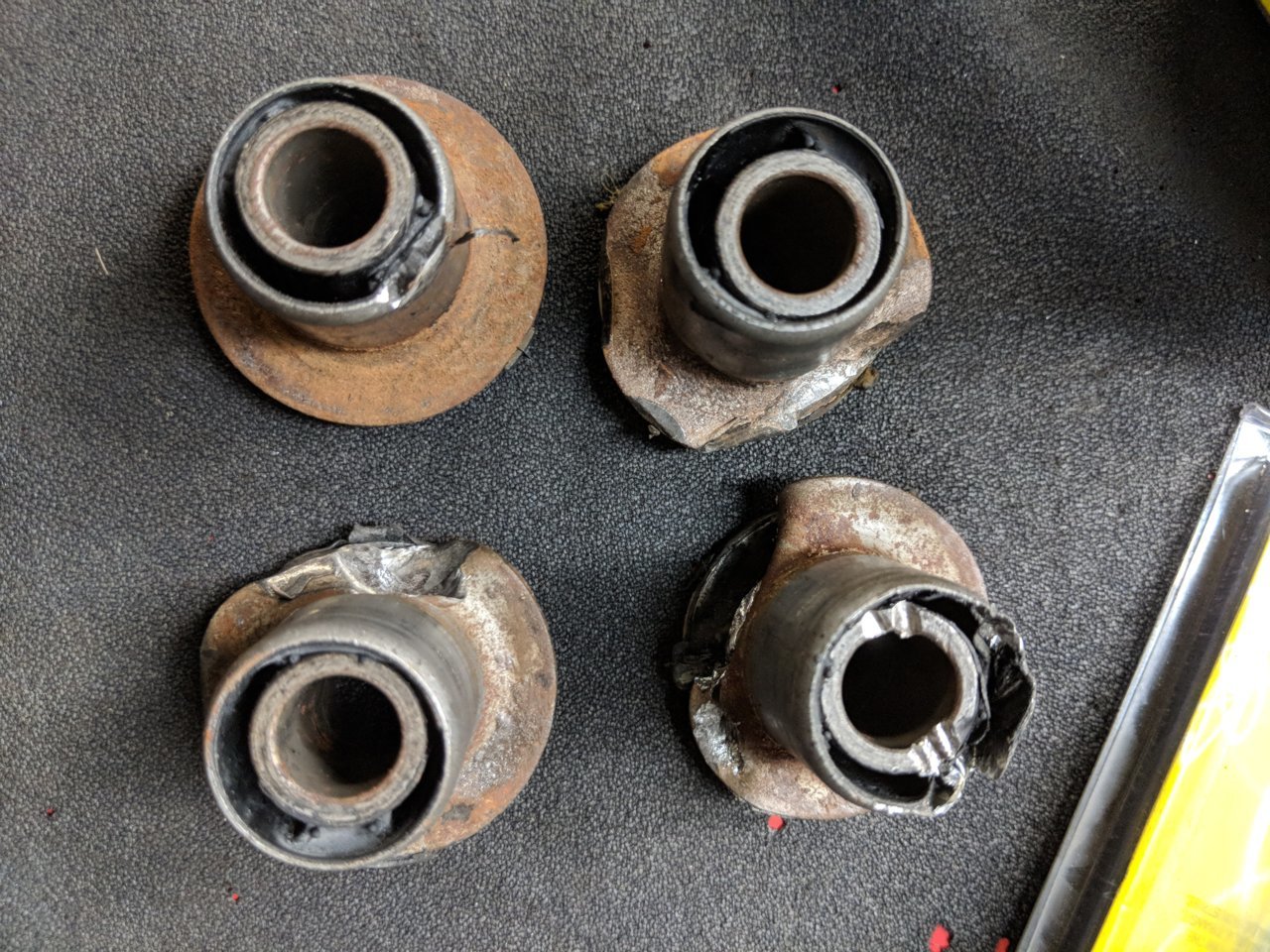

    I was unable to seperase the steering shaft and didn't feel like taking out the AC compressor. Took my mechanic (and a couple other guys) almost 3 hours to get the bushings swapped, including the use of a pneumatic hammer. Old bushings barely had any rubber left in them.
    Anyway here are a couple of pics. When I replace my struts this summer I'll have a shop weld in the Total Chaos alignment tabs. So far so good, except that the alignment tech didn't give me enough forward caster so I'm still rubbing a bit when I parallel park.

    Nice man! Glad it worked out.. Those old bushings are trashed I bet it drives a lot nicer..
