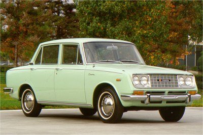

    It could be an intake leak that seals once it heats up. I had a 1966 Corona that did that. Intake gasket. Drove it for years like that.
    RA4--1-9q2vU_cQmyLhYo0-6n2LD3n-8-NaUD7Ld_fc7fa5fde2bfe65cbc81c23a1b06a37ebd201cd7.jpg
