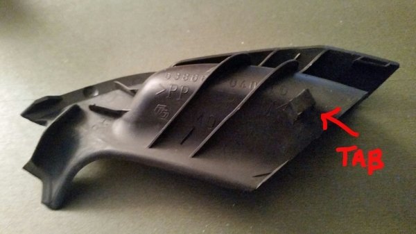

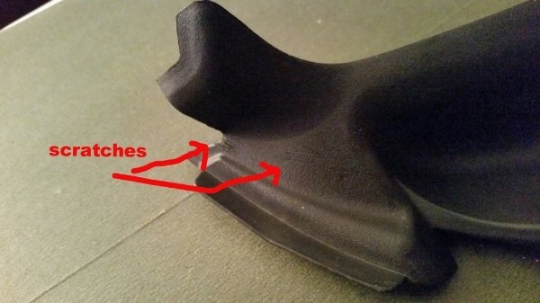

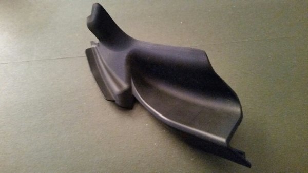

    EDIT: Ignore this post. I was dead convinced this was the solution to the kazoo. It wasn't. Seems to be the seal between the A pillar and door. Still trying to solve it.
    If you have the kazoo noise that seems to come from the passenger mirror area when a hard crosswind hits the truck, do me a favor and pull this corner plastic piece off the window trim:
    I played with taping the window seals and all kinds of things. I pulled this piece off and haven't heard a peep since. Pull yours off, throw it in the glove box, and see what happens. It will take 3 seconds. It is held in place by one tab on the inward side.
    My theory is that the wind lifts it under certain conditions and the outer side of it vibrates like a reed, possibly against the underside of the hood. Mine has scratch-like grooves that match the underside of the hood as if it was hitting it.
    Like I said, I pulled mine after much experimentation and I haven't heard the kazoo since. Nothing but blissful silence. Give it a shot a report back.

    Yep. Time for me to eat crow...I took a trip to southern MN this weekend and the first good side blast of wind made the kazoo noise. I thought that corner piece was it. I'll go back and edit my post so future readers don't get led astray. I taped the window seal and it was still doing it. My wife was riding with so I made her try to figure it out. She said it sounded like it was coming from the A pillar. It has to be the seal between the door and pillar. Sorry guys and gals.
