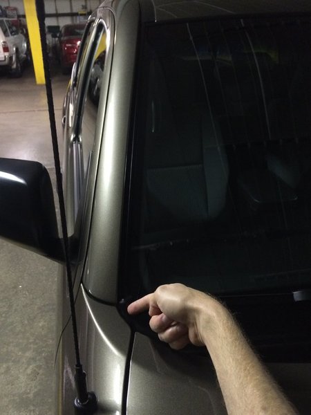

    May have found a potential culprit for the Kazoo noise. Don't know if it's been mentioned yet. I noticed on the lower corners of the windshield there is a loose thin plastic piece. It seems like it's just snapped in there. No question air is gonna get under it at highway speed. And at just the right angle, it could vibrate just like a reed in a clarinet. I have a 2014. Check for yourselves to see if you have the same plastic piece. See if it wiggles. There's significant play in both sides on mine when I just press it with my finger. Something tells me it can't be this simple, but it makes perfect sense. It should be able to be tested easily with a little packaging tape.

    Harp, check out post #115. Is that the piece you're talking about? If so, he later states in post #126 that it was not the problem for him. I suppose it could be in some situations though. Just letting you know.

    Well, shit. I appreciate the heads up :) Ha I thought maybe that had been addressed as it's a pretty obvious loosely fitting piece. The search goes on. I did however find a fix for the annoying noise by my ear. For me, it was just the window rubbing on an inner rubber piece. The piece you can "dimple" with your finger from inside the truck with the door closed. It's a soft rubber, not one of the harder seals. It just needs to be lubed with some 303 from time to time.
