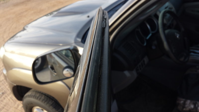

    I can confirm the weather strip fix (from autozone) works. I did this about 2 weeks ago- My truck used to make the god awful kazoo wind noise every day on the highways. Since putting in the extra padding in the front window seals, truck has been back to normal. Even drove into the plains of windy Oklahoma last weekend with insane crosswinds, and no more kazoo! I will post some photos of where I put the adhesive stripping in the front window seals for clarification on what worked for me.

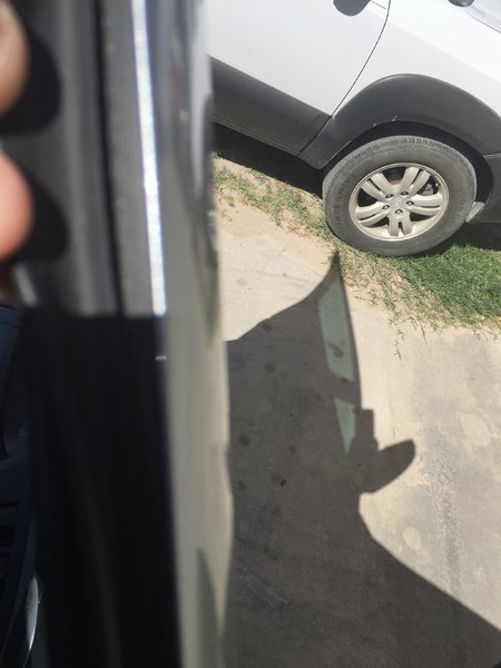

    I placed the sticky side towards rubber seal. Started it from front by mirror area where seal starts to top rear of door like on 2nd picture.

    Material I bought was little over half inch so I trimmed it a bit so it wouldn't stick out past door and be visible. About 3/16 or so.
    Hope the pictures help.

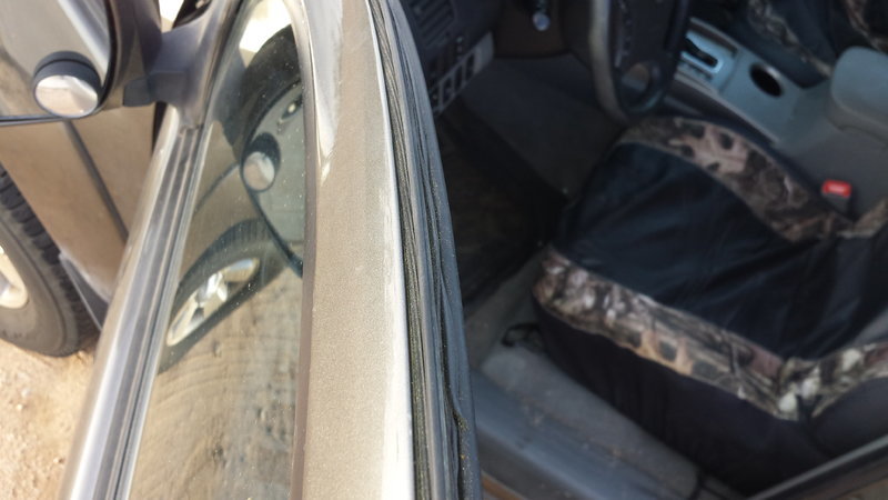

    Here is the main channel of the door seal with the weatherstrip in it (near top of pic). The weatherstrip looks haggard because I cut it up trying other fixes. Works all the same.

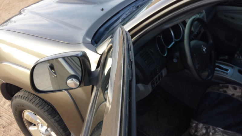

    Here's another angle showing the outer channel where I put the screen spline. (Spirally black material between seal and door)
    I don't think the screen spline makes a difference as I only have it on the driver side and not the passenger. Neither one makes noise anymore. I'm leaving it there nonetheless.
    Really I think all you need is some kind of foam material or similar, roughly 1/4 inch thick stuck in that big main channel to help tighten the seal up. Shouldn't need adhesive either, mine doesn't have any and hasn't moved since putting it in. Probably depends on what you use though.
