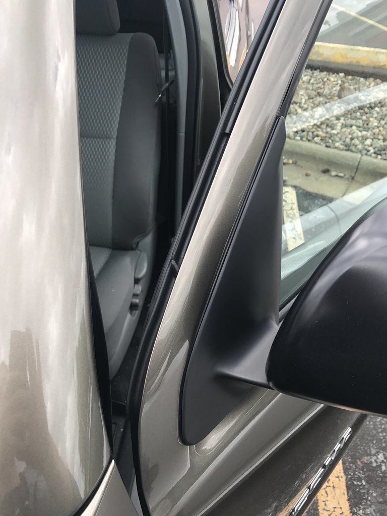

    After living with this annoying vibrating reed noise at the top of the front door seals every time I drive into/against a cross wind for 18 mos/25,000 mi. I decided to fix this myself.
    Toyo has yet to extend their TSB for 2014/15 for the same issue on 2016s. ( sounds like 2107 do the same ). It was a 5 min. fix and cost $3.50.
    If you look at the front door seals along the top and roll them away from the door just a bit you'll see a big gap behind them.
    Run down to your favorite hardware store and find some 3/8 or 1/2" round tubular closed cell weather striping with the adhesive tape attached.
    Cut a piece long enough to run from the top rear corner were the existing door seal is glued to the door frame down to about even with the mirror.
    Peel off about 6" of the adhesive tape cover and fit the new seal into the channel behind the door seal allowing the glue edge to stick to the door frame.
    Work your way down the door 4 to 6" at a time until done. This eliminated all door squealing for me and has no door leaks. Easy fix.

    I did the same with about 38k miles on mine (without the adhesive tape) and it solved the problem, and I had the Weathertech window deflectors. Haven't heard a peep since.

    How far down do they go on the other side? Can you take a pic from the other side of the door?
