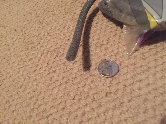

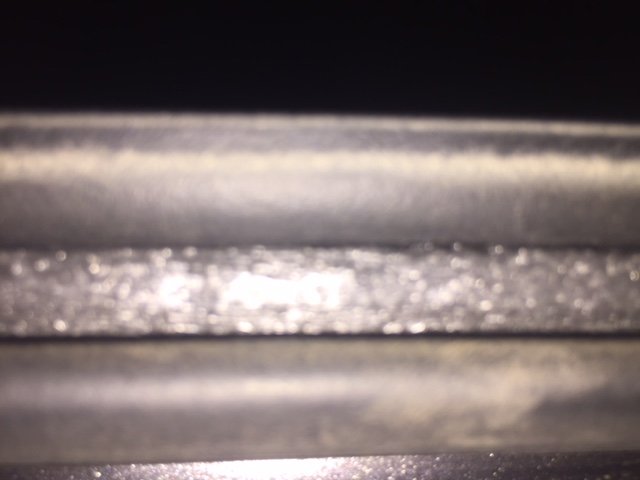

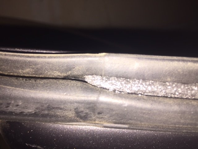

    Well I fixed my Taco, its a 15 access cab, and since I got it new 70,000 miles ago anytime I get a cross wind of 20 mph + you cant hardly hear the radio little less your self think. I saw this and saw the cure everyone has said has come from the new molding from Toyota for $70. a window. so before I spent $150. to get it stopped I was gonna make Damn Sure it would work! Sorry the past has made me want to make sure. I had some 3/8 round foam rubber, that I would try first to make sure it worked so right at Thanksgiving I put it on just like the people had shown in previous post. I strung it in the front over the top to the back, and glued it on with plain old super glue! Well I had forgot about it till today, because I haven't heard it since, and today the wind is blowing 25-30 with gust up to 60 mph, and I had to go out to the farm to check stuff. and about half way out there with the cross wind hitting the passenger side door it donged on me, NO NOISE!!!! So I guess I wont be going to Toyota after all. The Foam that I used came from McCOY'S lumber yard a couple of years ago and when I got it, it cost $3.19 for 20' of 3/8" Backer Rod, is what its called there, and 2 tubs of Super Glue at the Dollar Store, for $1. IMG_0748.jpg IMG_0749.jpg IMG_0747.jpg IMG_0756.jpg IMG_0764.jpg .............................And here is the one that is the same at Walmart for $6.00 which is the same thing! I was going to go to Toyota and get it fixed but $4.19 versus $150.00, I think I'll just stay right where I'm at and see how it goes it still just as tight as it was when I put it in. Its a real cheep way to check to see if it will work for you before you give Toyota $150. for there mistake! IMG_0744.jpg

    Did you use any kind of adhesive with this?

    I think some clear RTV silicone, a lil dab every few inches to hold things in place on the ones that needed it (i think only one line need it, the others stay in place without any adhesive)

    I cut a slit in the gasket and slid in some .25" tubing.
    Never made a peep after that, took all of 5 minutes.

    Took matters in my own hands and ordered some 1/4" drip line https://amazon.com/gp/product/B0091D31IA/ref=oh_aui_detailpage_o04_s00?ie=UTF8&psc=1
    Ran TWO drip lines between the seal and the door. Haven't heard a peep since!
    If anyone is still hearing this annoying "Kazoo sound", this mod is a must.

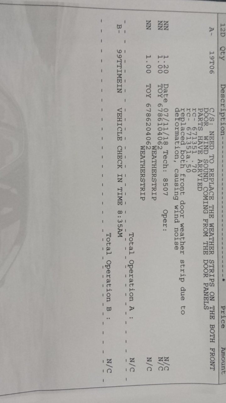

    I bought a used low-mileage '15 TRD Sport from a Toyota dealership last fall and have until September to get any covered repairs in before the factory warranty runs out. I've been trying some different things to mitigate this issue myself...
    Meanwhile, I went into my local dealer today (much closer to me) to have the driver's side speaker replaced under warranty, and mentioned this issue again.
    I played the service advisor TacoMan408's YouTube video, and I showed him the free skipping rope and dollar store foam wire tie (ideal for gardening; soft vines, tender tomatoes, delicate plants) I have packed into both front door seals, gave him the US TSB 0170-16 and politely asked them to investigate it.
    I didn't have a TSB # during my previous visit a couple weeks earlier and he didn't find one the first time I complained about it, though the one I posted seems have been published months prior. He came to get me in the lounge a little over an hour later, told me the speaker was done, and that he would call me when the new seals came in to book an appointment to have them replaced. I assume they will be covered.
    Hope this helps out some one else. Basic warranty period is running out.

    Got mine done today. It took just a bit more than two hours from the time I arrived at service til the time I drove away. They replaced both the inner and outer weatherstripping on the front doors. It wasn't a windy day and I didn't drive on the highway or into a crosswind, but I had to close the door twice a few times because the new stuff is thicker and more robust, and didn't close properly.
    The cabin sounded quieter. Should be good as new, though the rear doors still have the original weatherstripping.
    Good on Toyota to fix this. If your truck is out of warranty, good luck to you.
