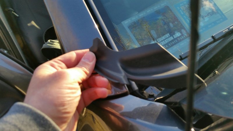

    I was northbound on the highway today with major wind gusts coming from the west. The kazoo noise near the passenger side mirror started kicking in right away. I pulled over and started taping stuff with some electrical tape. I taped the seal on both sides like the previous pictures and I sill got the noise. Then I taped the top of this plastic trim piece at the lower corner of the window and the kazoo noise stopped.
    You can't see it in the bad cell phone pic, but you can see abrasion marks on the top of the plastic that line up with the underside of hood. I think this puppy is vibrating like a reed up and down between the window and hood. I pulled it off and am going to drive this way for a while to confirm the noise is gone.

    Ya know i was looking around at that area of the truck the other day and tapped on that plastic piece and went hmm that could make some noise. The kazoo sounds i could see being made by that hard piece of plastic. Time to isolate it and live noise free!

    I haven't been able to reproduce the noise since coming back from Mammoth. There was a strong head / side wind going at the time. I got it up over 100mph today and no noise? Not much wind today though. I haven't touched a thing but I did notice that piece^ is loose?

    I taped the edge of my window exactly like Pelican did and I still got it to hum. I probably drove the same 8 mile stretch of highway 6 times back and forth yesterday because the wind was just right to get the kazoo noise when going north. Only time it didn't do it was when I taped the top edge of this piece down. If you pop it loose it is only held in place by a plug on the inner side. If air got under it, coming from the driver's side, the outer edge could flop up and down. Like I said, mine even has abrasion/scratch marks that line up with the underside of the hood.

    im going to go check mine now. Ill be stoked if the fix is this easy.
