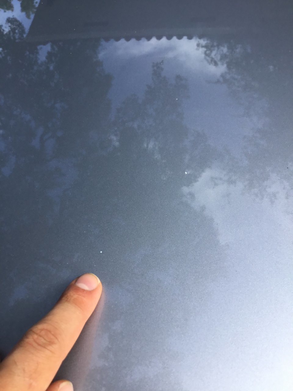

    The first thing are these little white spots. They seem to be all over my hood and top of the Tacoma. I am led to believe they aren't scratches because I was able to scratch one off with my fingernail. However, as much as I try, I cannot get the other ones out. They seem to be pretty flush/smooth with the paint. I have absolutely no idea what these little droplets are. Dried paint from a splatter? No idea.

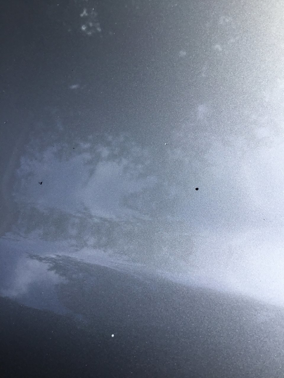

    The next thing are these black smudges. Again, I have absolutely no idea what they are, but they seem to be covering the top of my Tacoma. They won't come off after a wash, and they will not come off if I try and manually try and pick them off. You can see one of the white dots in this picture too.

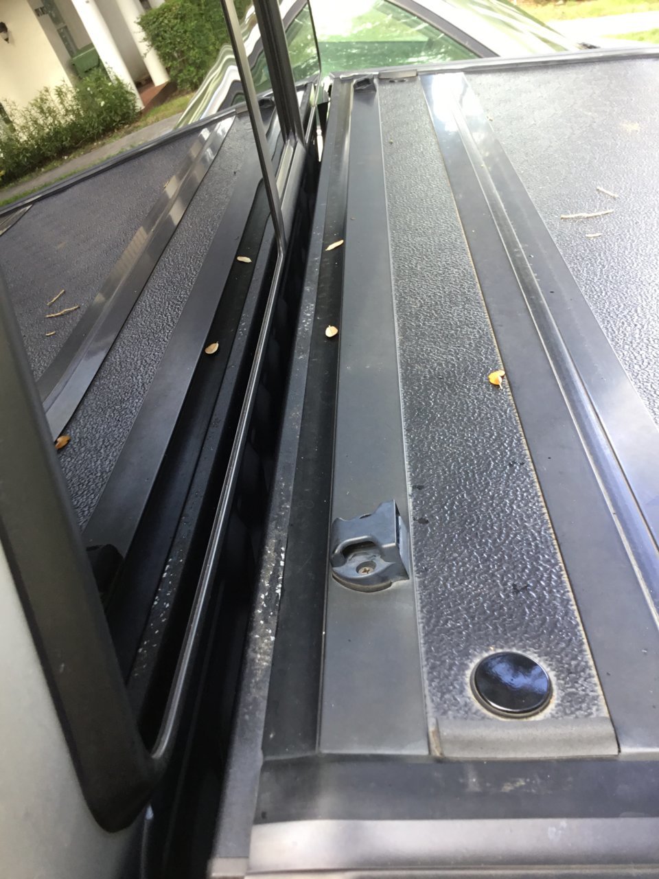

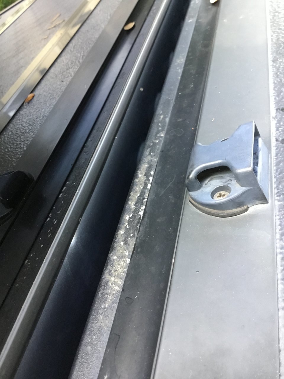

    The last thing is trying to restore the part of the bed where it meets the back windows. The back panel perhaps is the right term? It looks chipped and eroded and looks like he tried to paint it black at one point.

    If the white spot lifted with a fingernail they'll probably come off with a clay bar. Are the black spots tar? Not sure what is a good over the counter tar remover, maybe the Stoner's one. Both products are good to keep on hand going forward. Would recommend claying the vehicle anyway and put some kind of wax/sealant/coating on it.
    Not sure what to tell you on the painted trim, probably not a simple fix beyond just covering it with something.

    It was weird, one spot lifted with my fingernail, the other spots it did nothing. A clay bar? I guess ill google that, but I have never used that before. Is there something I need to do to the surface before using a clay bar? Or just...wipe away? I have no idea if its tar, if i go over it with my finger, its smooth. It honestly looks like a black marker, but I honestly don't know. Could I sand over it and repaint the trim perhaps?

    When you clay the main prep is to wash the paint. Should be plenty of how-to videos on youtube. You will need a product to lubricate the paint such as a rinseless wash solution or car shampoo. Look into chemical decontamination as additional prep for claying. Claying and decontamination will remove bonded/embedded contaminants that will not come off from the strongest soaps or other harsh cleaning chemicals.

    The aluminum bed rail is know to flake and corrode. You can sand it down and hit it with some Rustolem bedliner. It’s got a light texture finish that will look like OEM, and be stronger than the current finish

    I'd try a plastic razor blade on the black and white specs if clay doesn't knock them out. Available at hardware stores. I don't think clay is gonna get them if you can't pick them off with a fingernail. Could be paint drips. Could be insect droppings.
    Just hold the plastic blade at a low angle and gently try to "push" or pick off the spots. Obviously taking care not to scratch the paint, but I think you'll be ok. Low angle and a gentle push.
    If you do swirl the paint a little, use Meguiars ScratchX on a foam applicator pad to clean it up.

    Any specific grit sandpaper you'd recommend?

    Probably 320 just to scuff it up. Maybe 220 in spots where it’s flaking just to knock it off.
