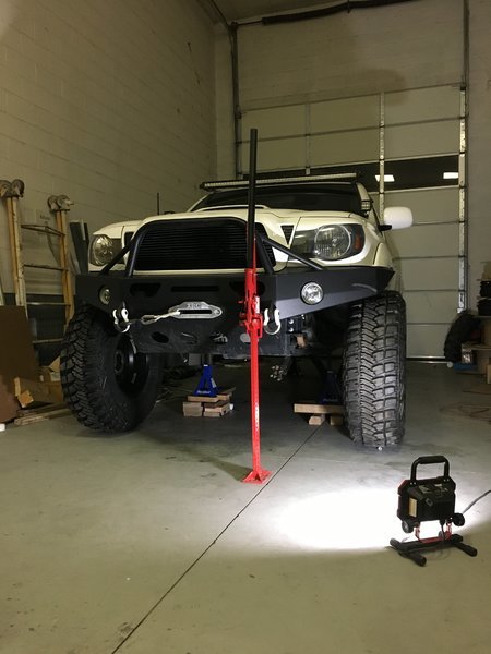

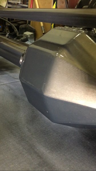

    Building this thread to help whoever attempts this Swap next lol I have the pictures and some of the knowledge so why not.IMG_3631.jpg

    Thanks! It's tacked in place but I will start from the beginning to show what has happened.

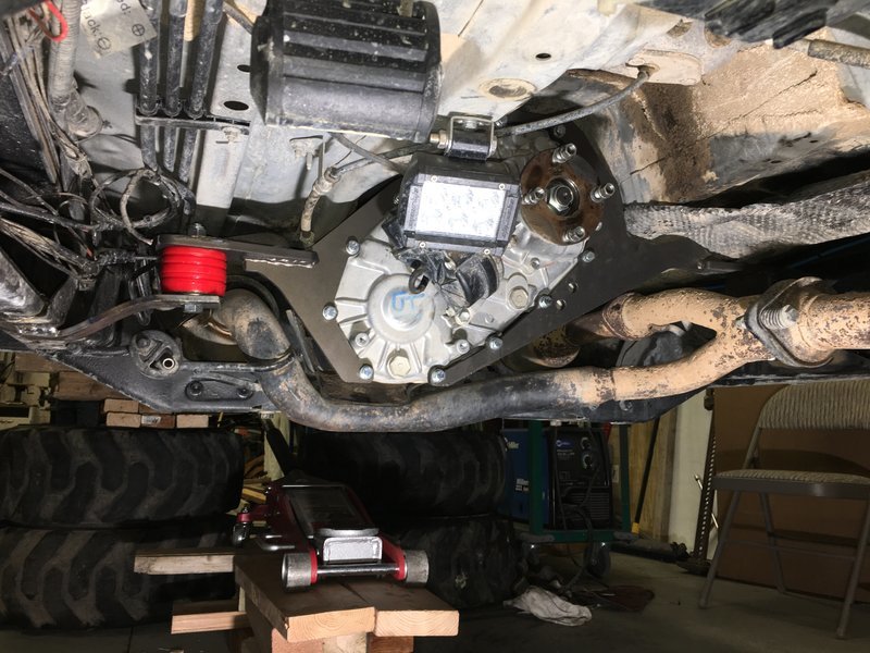

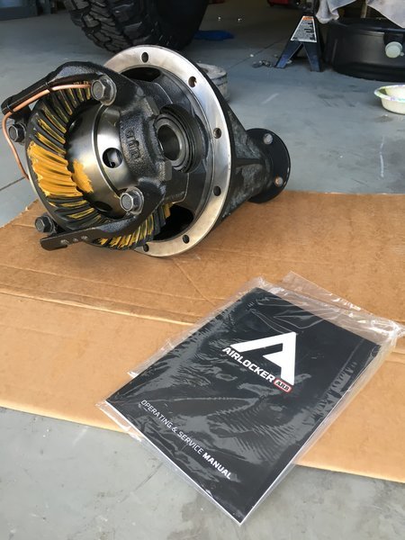

    Alright to begin I ordered everything I could from all pro The Whole friggin shebang. Axle setup around 6,200. Linkage and frame braces 1,500. Gear box with lifetime warranty and steering components 800. Then went to a local shop here in Utah to get the rear 3rd member re-geared to 488 with an ARB air locker about 1,800

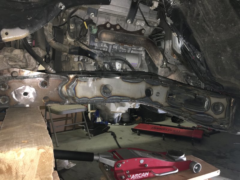

    The frame braces were easy to install, just removed paint and welded everything in. I followed all pros instructions to the T for the steering box plates. I had to cut out some of the body mount and the radiator mount to get the steering box in, it needs to be that far forward To fit everything

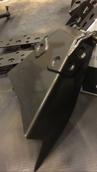

    I went to superior paint supply in Salt Lake City Utah to have them mix some auto paint for me. It's a black acid primer with 3 coats of paint and an activated gloss clear coat on top. I love how it turned out! Paint cost me about 300 for everything put in rattle cans

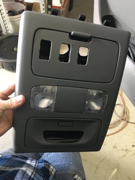

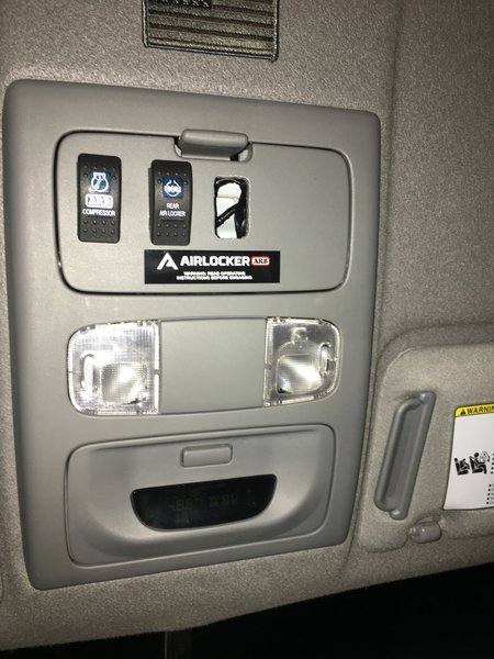

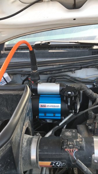

    So the ARB compressor is mounted to the frame right behind the K&N with a 1" square tube. Ran the wiring harness to the sunglass holder for the air compressor switch and front/rear air locker switches. I didn't want to accidentally bump these switches. They make locking switches if you have to put it down lower though.
