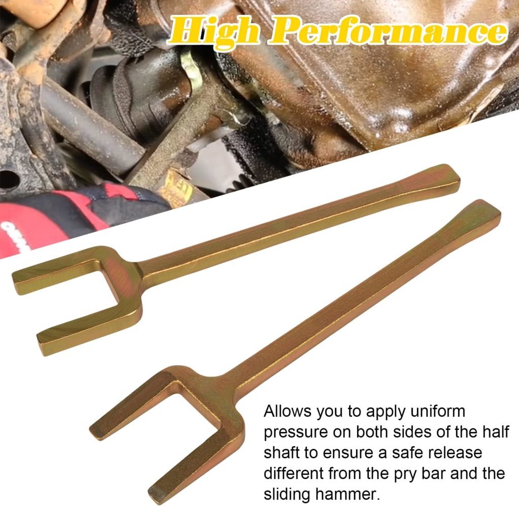

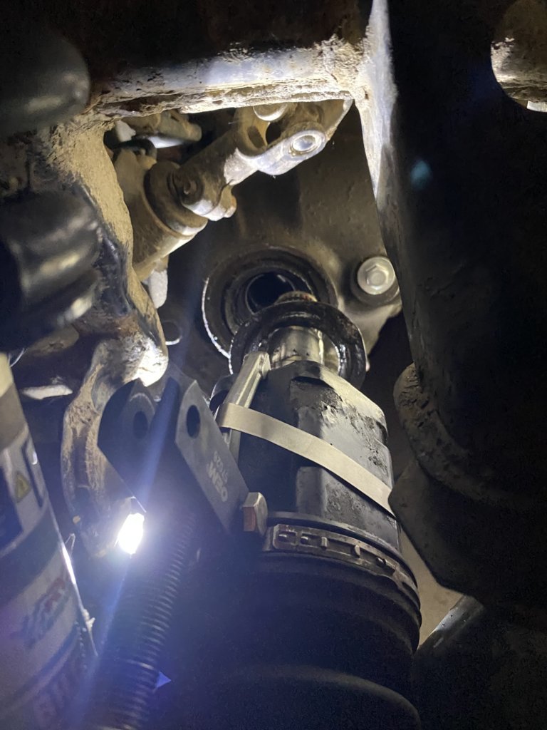

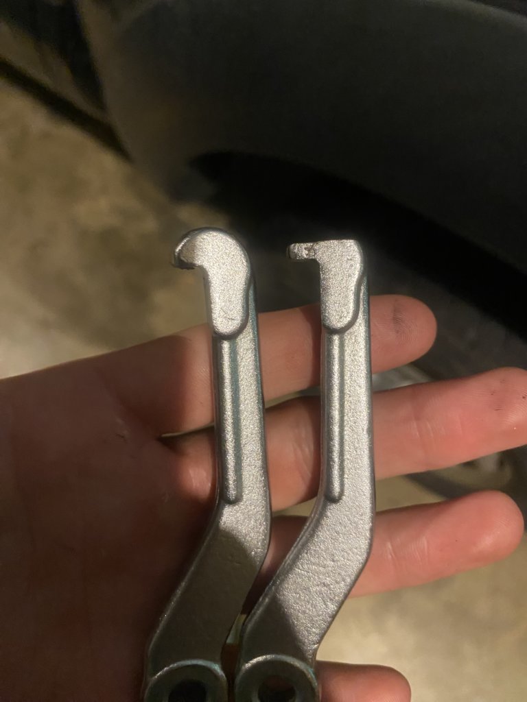

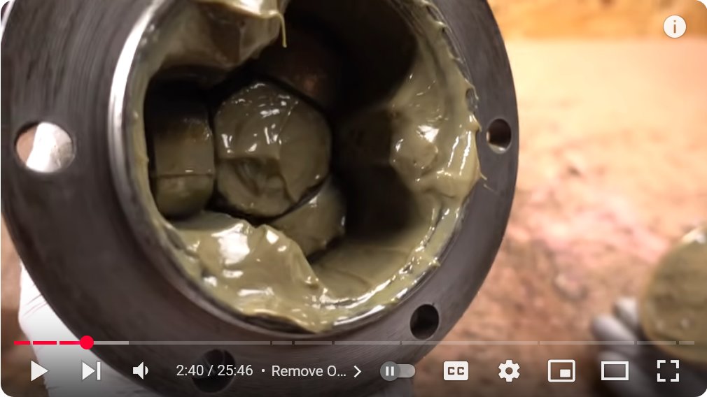

    I recently bought a 2011 Tacoma and while looking under the truck I discovered a rip in the inner drivers side boot. I noticed a grease that looked very much like white lithium grease seeping out. I had recently driven through some 18" deep water on a flooded roadway so I thought it was grease contaminated with water. I pulled the axle and the grease looks very clean and uniform.Not any water or rust in there. I also had and aftermarket clamp on the inner large side of the boot.
    I was searching you tube and came upon a video of a CVJ being dissembled that had the same white grease and was wondering if some aftermarket replacement boot kits had this type of grease. It is a OEM Toyota axle.
    I also was unable to remove the axle from the diff and had to split the boot and slide the axle out that way. No matter how hard I pound on the axle it will not budge. I am thinking that the person who last installed the axle maybe distorted the circlip when installing it. I bought a couple of axle removal tools off of Amazon and will try to remove the inner housing that way. Two fit on a slide hammer shaft( 63mm and 48mm) not sure which size would fit best. Also a set of forks/wedges that you pound in like a ball joint removal tool. I have the ECGS bearing and seal kit I need to install as the inner is pretty sloppy (no noise or vibration yet). I may end up messing up the dust shield but I have to get it out as I want to replace the needle bearing.I just bought the Toyota boot kit but may end up buying a new axle if I distort the metal dust shield and can't straighten it out..White CVJ grease.png removal forks_.jpg Slide hammer removal tool_.jpg
  2. Sep 5, 2025 at 9:58 AM
    bkhlrTaco's
    bkhlrTaco's “expletive deleted”
    Jun 16, 2023
    #426934
    6,369
    Brian
    Eau Claire, WI
    2016 OR AC MGM
    Pry, spin, pry, spin, pry, spin...until you find the sweet spot.
    That fork should work. I use a narrower pickle fork. I've used pry bars before..
    Just gotta be able to get behind it and find that sweet spot. :thumbsup:

  3. Sep 5, 2025 at 10:05 AM
    wdunnlee
    wdunnlee Well-Known Member
    Jun 27, 2024
    #452249
    432
    Will
    Tidewater VA
    2010 Timberland Mica 4x4
    I took the rental autozone slide hammer and used one hose clamp to hold it down. I also had to cut the end of the jaw to fit between the diff housing and tulip.
    mine was super stuck and the pry bar didn’t work for me.
    DTL54[OP] likes this.
  4. Sep 5, 2025 at 10:27 AM
    chasetheCarguy4x4
    chasetheCarguy4x4 Well-Known Member
    Aug 4, 2024
    #454499
    94
    2003 Toyota Tacoma 4WD 3.4L MFI DOHC 6cyl (5VZ-FE) 4SPD AT
    From my experience, if there are any tools you don't have, if you have an oreileys near you make an account with them, they have a free tool rental program where you pay the tool in full price then get it all back when you return the tool.
    DTL54[QUOTED][OP] likes this.

    So I guess the golden Toyota grease for the inner joint must whip up into a whiter opaque looking consistency. Great...now I don't have to obsess about cleaning every last bit of the grease up because I thought it was contaminated with water. Also the large clamp for the inner joint is different than the other 3. So the one that was on the inner joint was factory but just has a different clamping mechanism. Does any one know which tool I would use for clamping that one?

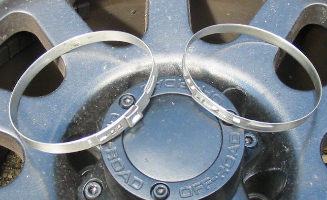

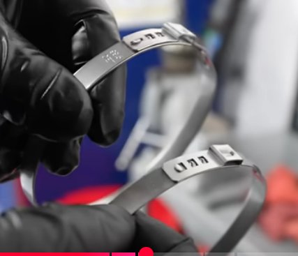

    Here is a picture of the Car Care Nut showing 2 large clamps he is replacing on a Toyota truck. The nextClamps.png Clamps2.jpg is a picture of the 2 I was supplied with my Toyota boot kit. It matches the ones I took off my 2011 Tacoma.

    I did that. Then I took a break to think about it! Then I did it again! I figured if I split the boot and removed most of the axle it wouldn't be hanging down and applying uneven pressure on the circlip. My phase 2 tools come tomorrow and I will try again. I just have to find out what kind of tool works to clamp that band with out the raised hump to allow the crimp.

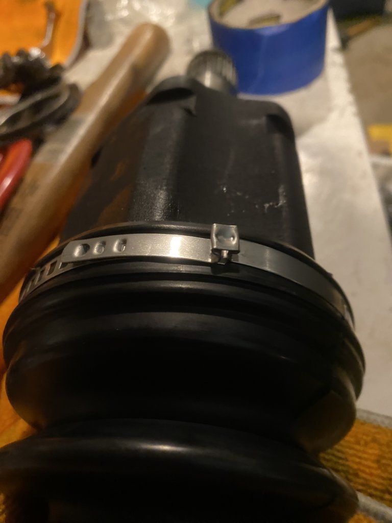

    I see you have the same style of clamp as I do .How did you clamp that? Or did you just replace the axle? I see 2 little tabs that maybe you can hook onto with the jaws of a serrated pliers of some sort and squeeze them together. I just don't want to mess up the clamp.Some times you have one shot .It either works or you destroy the clamp. I do have a slide hammer kit like that so I could try that while I am waiting for my tools to come. Pretty good idea you had there!
  9. Sep 5, 2025 at 12:21 PM
    wdunnlee
    Jun 27, 2024
    #452249
    432
    Will
    Tidewater VA

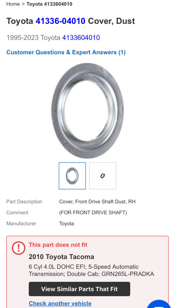

    I assume you are referencing the CV boot clamp not the hose clamp around the tulip.
    I just pried mine off and the reboot kit I bought came with 4 ear clamps instead of the 3 and 1. I don’t have experience with the other type.
    also I got another image of the slide hammer assembly.
    This is the cut I made.
    IMG_3056.jpgAnd it is still completely functional.
    I messed up my metal dust shield real bad on removal.
    ordered this and it just got in, looks right. Despite the warning.

    The dust cover part number was going to be my next question. You must have ESPN!

    LOL :rofl:, I reread your original post and noticed you mentioned the dust shield. Mine was bent to oblivion.

    I just rebooted an axle , ive done 3 so far, that 2nd big clip is a bitch, i bought a tool and still couldnt get past the second notch.
    I bought some of these.
    https://www.amazon.com/Tabazy-Boot-Clamp-Kit-Adjustable/dp/B09BJX2G1P
    Worked fine
    Get a pry bar behind there
    Pry/spin a little at a time
    It will pop

    Here is what i bought I just didnt have the strength to squeeze the clamp all the way closed.

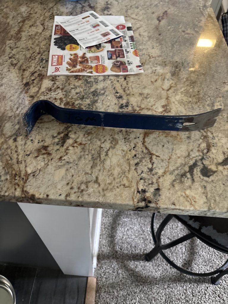

    Those look like they would really hook onto the tabs but yes they have such short handles that would be hard to get any leverage.

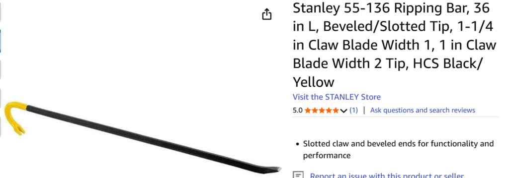

    I stopped by Harbor Freight to look at their pry bars and they had a nice 36" one but I wasn't sure if I had that much room to maneuver under there. I tried a Stanley 36" crowbar I had at home just to see if the length would fit under there and the wedge end would not fit in the gap so I held it about 3" away and jabbed it with some force into the gap and it popped right out! So the overall weight of the bar plus the wedge geometry worked together to pop it out on the first try. I would have never though of using an actual crowbar!

    I just use a pry bar
  18. Sep 7, 2025 at 12:49 PM
    #18
    DTL54
    DTL54 [OP] Well-Known Member
    Sep 5, 2023
    #432889
    66
    2001 Tacoma 4WD ext cab, 2011 Tacoma access cab 4WD TRD Sport
    Stainless steel drain plugs, Hankook tires
    With this I just poked it in once and it popped right out! I tried the the same thing you are showing and it just didn't work. Pry ,turn,pry turn. 15 min later ....no go. Next time just try this. I mean it amazed me when it came out on the first try.
