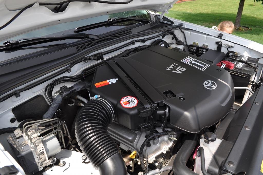

    Had mine for over 2 years now. Keep it waxed... no issues. Don't take care of it... You'll have Issues. Like with anything. It's all in how you take care of it. Not a swirl mark one in the paint... but... I used to "show" cars so I'm a little OCD when it comes to taking care of them.
    The top looks like the bottom. Clean....
