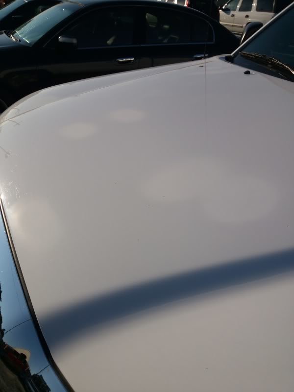

    This is what is happening to my 2011 AC. I've never owned a vehicle that needed to be waxed more than once or twice a year. I'm pretty pissed that I'm now getting circular spots on the hood that are dull. There is also a spot on the side on the door. I've only had this truck 2.5 years and IMO, these spots shouldn't be there. I've got a 1997 white Saturn that was garaged until I got it from my father-in-law about 7 years ago. Since then, I've only waxed it once and it still has a perfect finish.

    This is pretty alarming. I'm not too sure I want to buy super white now.

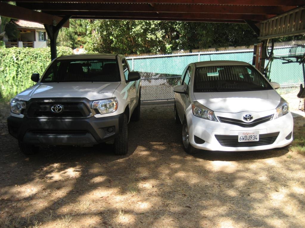

    I read somewhere that the clear coat is mixed in with the white paint. I never own anything except white vehicles. :)
