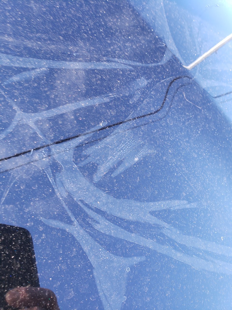

    So at the Toyota dealer to get my inspection sticker and was walking around the lot looking at vehicles. Here is a picture of the hood on a $49k midnight black 4runner. When the white film that is wrapped on the hood for shipping was removed it left these marks. It's not adhesive and the marks are actually where there were bubbles in the wrap and the wrap was not touching the paint. Looks almost like the clear is delaminating. Rubbing with my finger it feels as smooth as the rest of the paint. And no change in marks. This was on a bunch of brand new vehicles. Sales manager was clueless 20181205_101732.jpg

    Wet rag rubbing and a little polish and it didnt change.

    T-SB-0044-16 covers this and how to fix it.

    And there you go. Thanks for that pdf.

    Can confirm that heat gun will fix it, or even just sitting out in the hot sun and they will fade right out.
    (My truck was black so it really stuck out like a sore thumb) my dealer (after I pointed it out to them) wanted to get the truck re-painted.
    DA polishing, clay bars, detail sprays etc. will not work.
    Either heat gun and/or sunlight and I guarantee it will disappear without a trace.

    Had this happen to a motorcycle I'd made the mistake of covering with a cheap plastic cover that didn't breath.
    Scared the shit out of me when I took the cover off. A little time in the sun, and what looked like damage, disappeared.

    My dealer gave my truck to me at night and covered in snow. (Lol now I know why).
    The next day of course it's nice and sunny and so I power wash my nice new black truck.
    And when the sun hits these marks the right way, they look almost white, hits it another way and it looks like a blister in the clear coat or brake fluid stains.
    Front and center all across the front of the hood, and right across the front of the roof. When the sun was out could see 'm from 30' away...
    After over a month of getting the run around at the dealer to even TALK to and SHOW someone this.
    I had to block their doors with my truck to even get their service manager to acknowledge there was a problem.
    Tried to blame me until I showed him the e-mail from the next morning when I got the truck with pictures...
    His solution was to get the truck re-painted.
    No clue what it was until I told him, no clue about the TSB about this, no clue about any of the other TSB's or issues with the truck...
    I won't let that dealer even rotate my tires let alone change the oil.
    I really feel sorry for people that put their faith in some "dealerships".
    Fortunately I still had connections in the Automotive world that had told me what this was and what the fix was.
    Since it was winter I just pulled it into a heated garage and put a couple heat lamps on the affected areas and went on to DA polish the rest of the truck for Ceramic coating while I waited for those areas to "cure".
