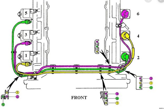

    Are you still getting the misfire code and/or experiencing a rough idle?
    I would try swapping the coils 1 to 3 - opposite of the engine - to see if the misfire moves with the coil swap.
