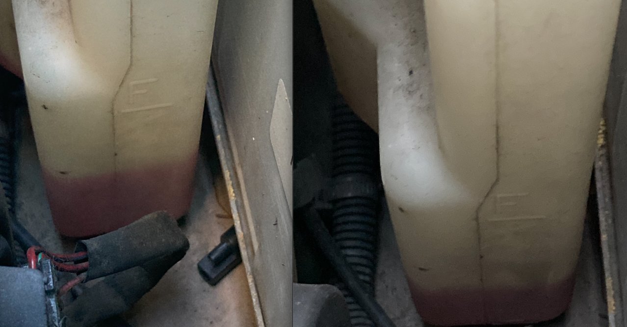

    Hey all,
    Had an issue with my truck the other day, had been driving it for about 45 minutes, stopped to get gas and when I started it back up, it started blasting white smoke out of the exhaust.
    After a few minutes the smoke slowed down and then basically stopped altogether, so I drove home cautiously, watching the temp. When I got home the smoke was gone and when I started it back up, no smoke.
    An hour or so later, I started it up and the smoke was back. Did the same thing and then slowed down again. It's been very hot so doubtful it's condensation. The coolant levels did drop slightly over the course of the day, and the smell of the smoke could have been sweet, hard to tell, but I'm thinking it's probably coolant. Oil looks totally fine, no leaks anywhere, and everything runs fine. Any ideas?
    Screen Shot 2020-07-26 at 10.04.57 PM.jpg Screen Shot 2020-07-26 at 10.05.51 PM.jpg

    as a simple test, on first start in the AM loosen the radiator cap but leave it in the "catch" position. This wont allow the cooling system to build up pressure. Go for a short drive then shut her off and let her cool down, then start her again and see if she smokes or not.

    Crack head and when parked, coolant leaks into cylinder is my assumption.
    Do a coolant leak down test. A compression test might not show

    Most likely a headgasket and not a cracked head.
    But yes, if it is burning coolant, every time you shut the truck off, coolant is leaking by, into the cylinder wall. Every startup results in the white smoke of burning the coolant off.
    Get a test kit like this. The fluid reacts to the presence of exhaust gases in the coolant.

    That’s typically a blown head gasket 99 percent sure.
    It will get worse

    In the pic it is a little hard to tell for sure, but I'm more inclined to think it's a whiter, and less bluer, smoke. White smoke and slight coolant consumption are very common symptoms of coolant getting into the combustion process.

    Or cracked head, but since never overheated(I know it's a dummy gauge and needle doesn't move until it's too late), I'm inclined to think more of a head gasket issue as well

    These are the exact same symptoms when my head gasket went out, yes there was a crack in the head when it was opened up too, so bought an engine in a rolled trunk with 90,000 miles for 1500.00,
    Truck didn’t run hot either when it was like this, FYI,
    Just blowing white smoke on startup and antifreeze running low And occasionally misfire

    Yeah, your coolant is going where it's not supposed to.
    Best case is maybe a blown head gasket, or at worst cracked head. Wouldn't valve seals leak oil, not coolant?
    It sounds like it isn't overheating, so that's a good sign your head probably isn't warped or anything, but yeah, you're probably gunna have to tear the thing apart.
    You can also drain the oil and coolant to see if the two are mixing.

    Antifreeze have a very distinctive smell to it oil not so much. None of us are in this guys yard usually a puff of smoke on a restart is oil leaking past valve seals. If it has a sweet smell to it yeah it's antifreeze.

    Thanks all for your help.
    I had it at a Toyota dealership for 2 days, they pressure tested the whole system, couldn't even get the smoke to come out and said all my fluids were in great shape. So I basically walked away with no info, only to have the smoke come back again a day later. It's pretty on and off, but I still get white smoke upon starting it at least once a day. It's not always in the morning, but almost always after when the car has had at least an hour to cool down. I'm gonna try and keep an eye on the coolant levels, but I'm not really sure what to do next, my guess is it's probably a really small head gasket issue that will get worse as time goes on? Hard to say though.
