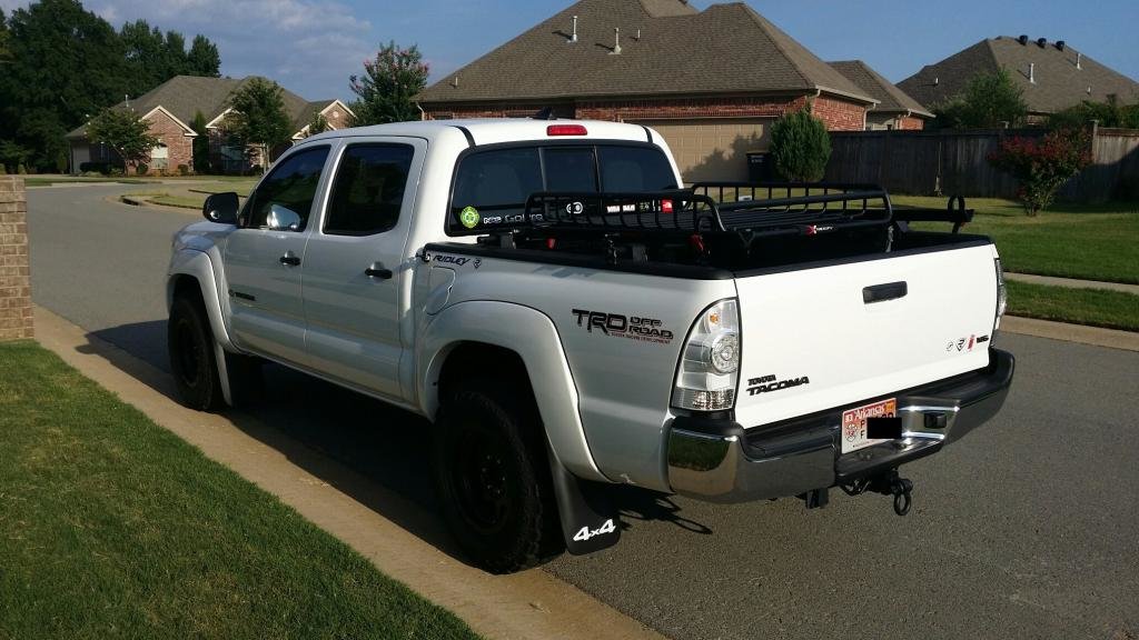

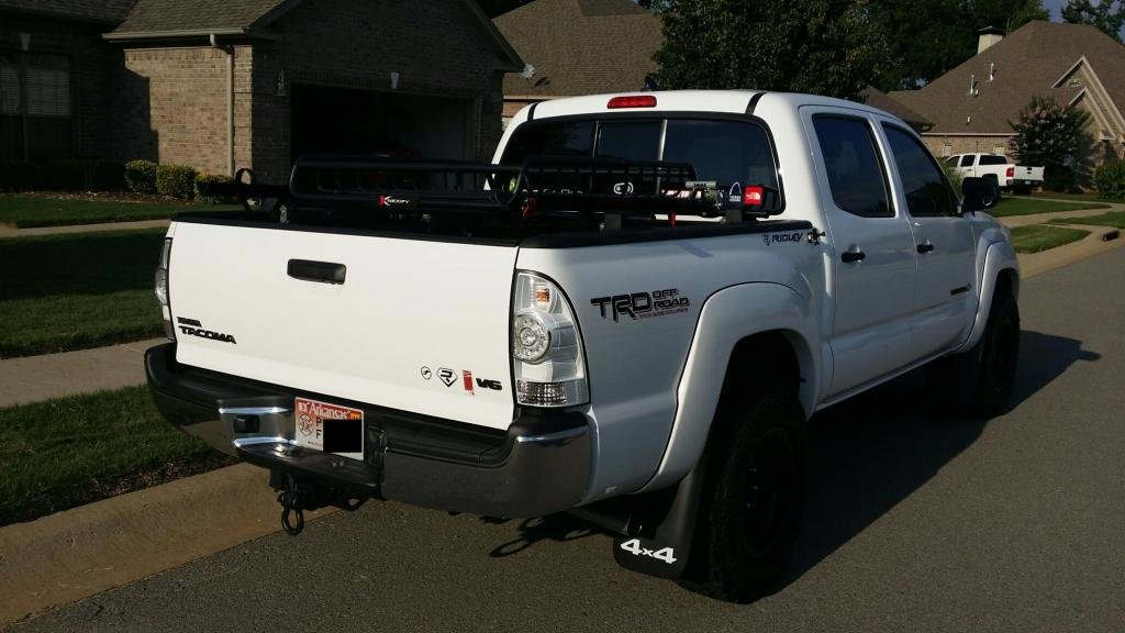

    Couple of new pictures in the sun. Couldn't ask for it to match much better.

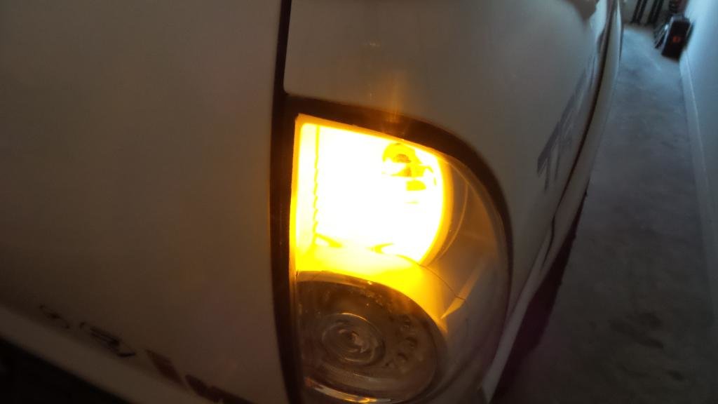

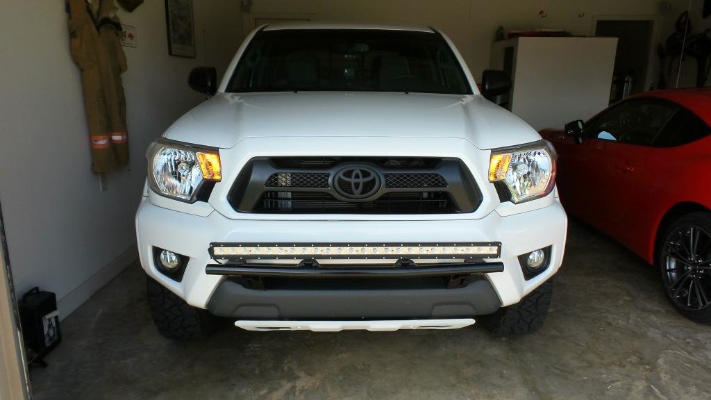

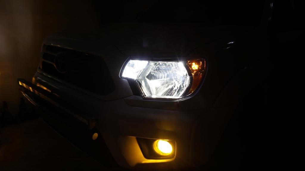

    Ordered LED'S all the way around so the orange bulb will soon be replaced.

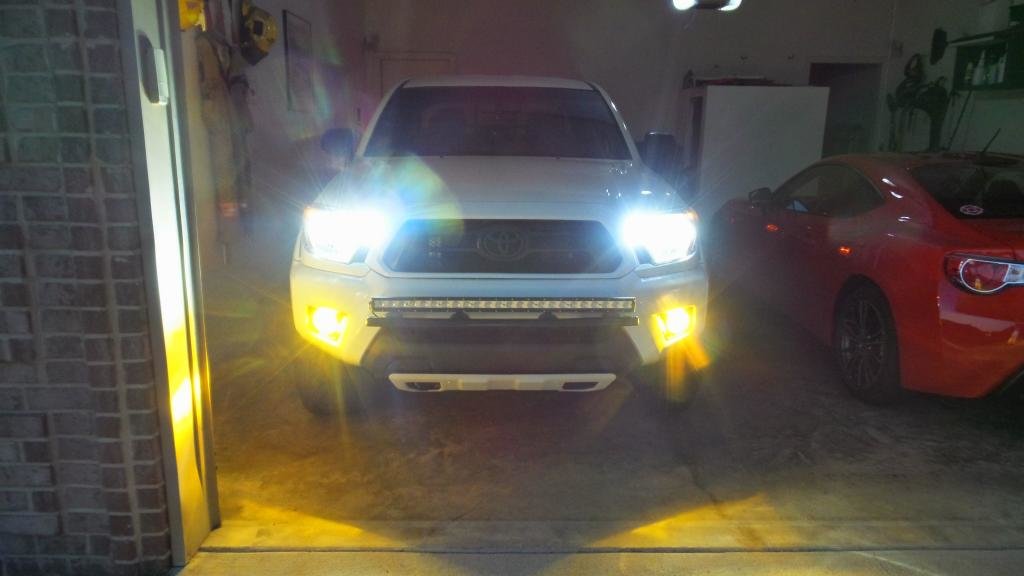

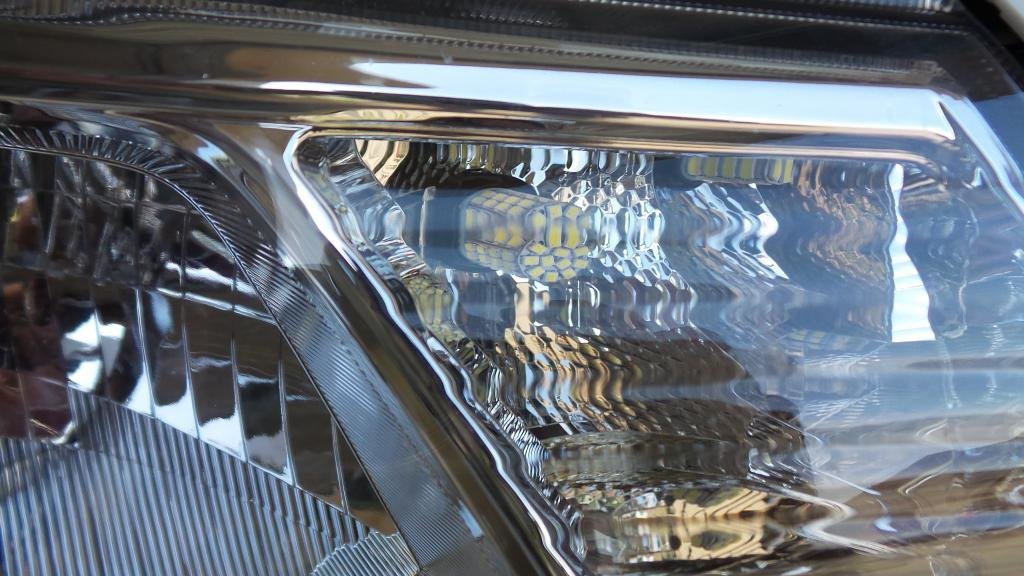

    Installed LEDs all the way around

    Now you're screwed. Once I was running LEDs and cleared housings I never wanted any color back when lights were off

    Yeah, that's why I like these. You can't see them when behind the truck since they blend in. I especially love the front since they are amber / white.

    It's really kind of a long process. You can't bake the taillights like you can the headlights. I had a extra set of OEM lights sitting in my attic since I had bought a set of Anzo black taillights for the 2011 and let them go with the truck. I figured if I screwed them up I've lost nothing but time (which I had plenty of at the time) and some paint.
    You have to cut the lens off with a dremel tool. There is a notch between the housing and the lens and about 1/8" of glue that holds the lens onto the housing. That is actually the hardest part because you have to be careful not to cut into anything but the glue. Once the lens is removed you just tape off everything you don't want painted and go to town. Let it dry and then take a small amount of epoxy and glue the lens back in place and let it dry (24 hrs or so). After that I took some 3M sealant and went around the edge of the housing where it meets the lens and let it dry (24 hrs again). I did this 3 times to make sure there were no leaks so it took about 4 days to complete it. Once you are sure you have it sealed up there is one final step. Tape off the entire outside of the light with the exception of about 1/4" all the way around. Paint that area with flat black paint to cover up where you made your cuts and the sealant showing through the lens and it is complete. I've had them like this for over a year and a half and no leaks and no problems. I "personally" like how they turned out.
    :EDIT: Forgot to mention. Yes I did use primer before painting.
