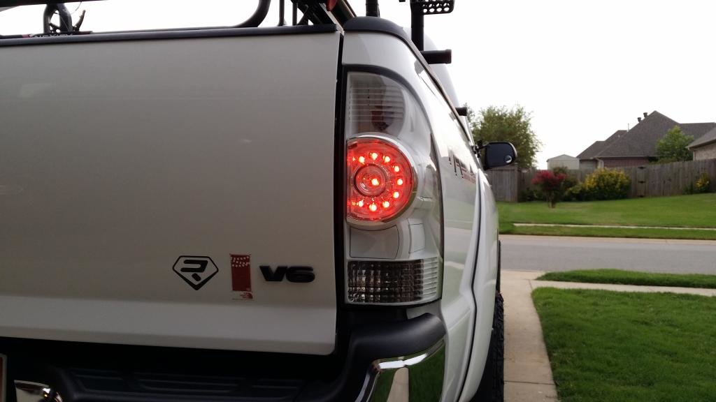

    Here ya go ;)

    Looks crazy man. I like it. Good job.

    I like how the black trim looks going around the light. Breaks up the white between the body and light.

    DUDE! this looks cool, good job.

    Yeah, If you decide to do it you'll have to paint the outside of the lens to cover up the glue and trim marks from where you cut. It takes about 1/4 of a inch to cover the glue underneath the lens.

    Did you mask off anything in the inner parts or did you just spray it. I like how the parts look like they have a line around it like you painted each part ??? Like around the led tail light and the smaller squares under?

    Yes I taped off the LED's, the LED ring, and the back up lights. The prep work is what takes the most amount of time but the result is worth it.

    Those look great.
    I do see some interaction with the your friendly neighborhood law enforcement officers in your future though.

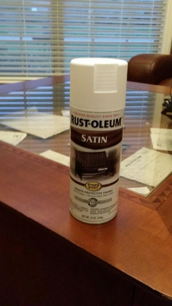

    What paint did you use?

    Primed first then used this. Matches almost perfectly.

    Oh wow, I used krylon fusion gloss white on my headlights and it's a bit duller in person.
    Might try that or order from that website that has the $20 cans that's supposed to match 100%
