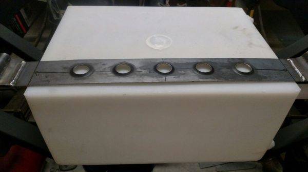

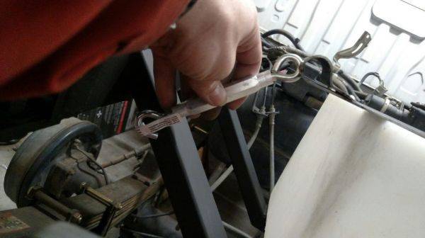

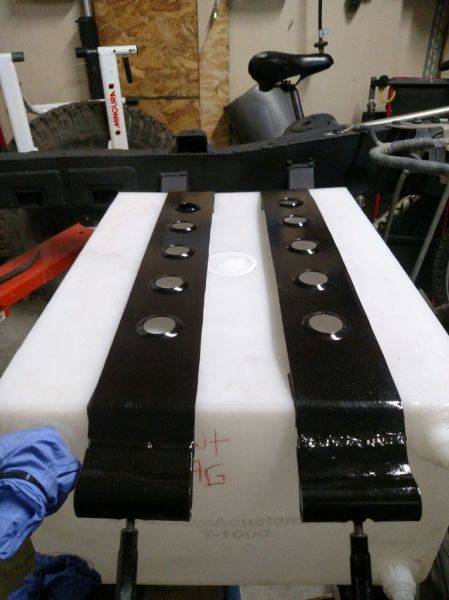

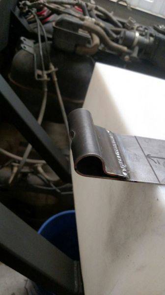

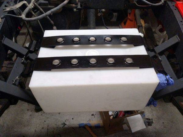

    Water tank straps will be secured by turnbuckles and solid bar in the straps and then wired to prevent them from backing out.

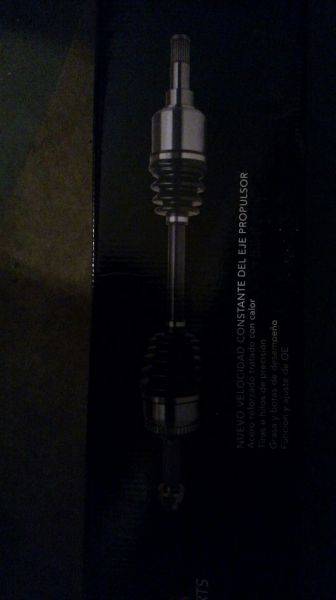

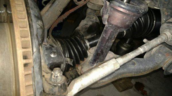

    New CV's for the truck. I havec tried everything to use my OEM parts and just get new cages and internals but I guess this is about the only thing that I can do to get it rolling again. Short of buying RCV axles and I don't have the funds for that.

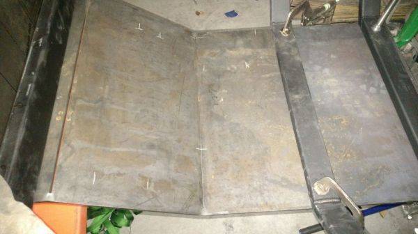

    Skid plate that will have everything mounted to it. Air tank, compressor, water pump and then will bolt under the water tank.

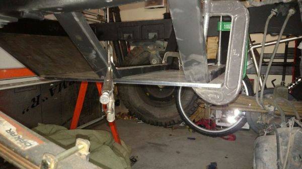

    So I found out some bad news............my passenger side frame is bent at the bumpstop strike pad and is off by almost 3/4 inch. I guess the huge tire carrier on that side isn't such a good idea. :(

    This is the same area that you just finished boxing in? :confused:

    Yep. Didn't notice it till everything was done. oh well I guess i'll just use it till it folds in half????

    Now that it's boxed in wouldn't it be twice as strong as before or more so? Seems more like you are just stuck with the hight difference. That Strictly a guess.

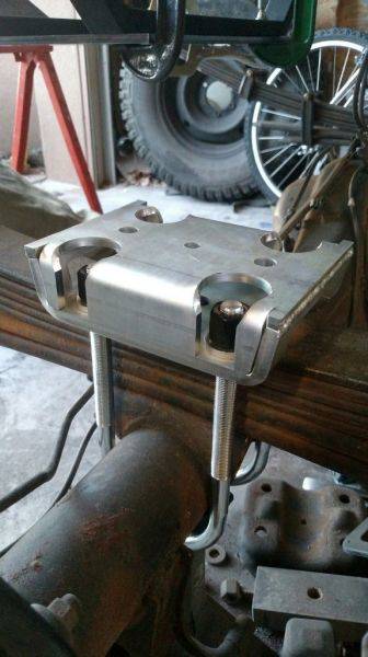

    U-bolt flip from Low Range is beefy. Just need to tighten everything down.

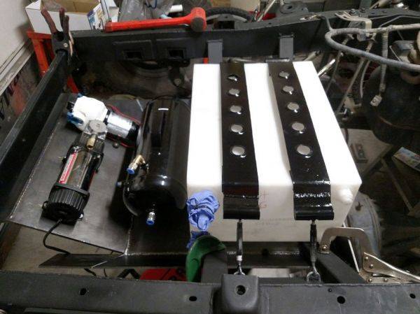

    Small progress........
    Yes I still need to attach the u bolt to the cross members.
    White is air tank, pink is H2O pump, and yellow is compressor.

    Could water potentially effect the compressor and pump during a river crossing since it's in the bottom of the frame?

    It could but the full electrical system will be sealed and the compressor and water pump will not be turned on while under water. But that is a good point that I didn't touch on yet. :)

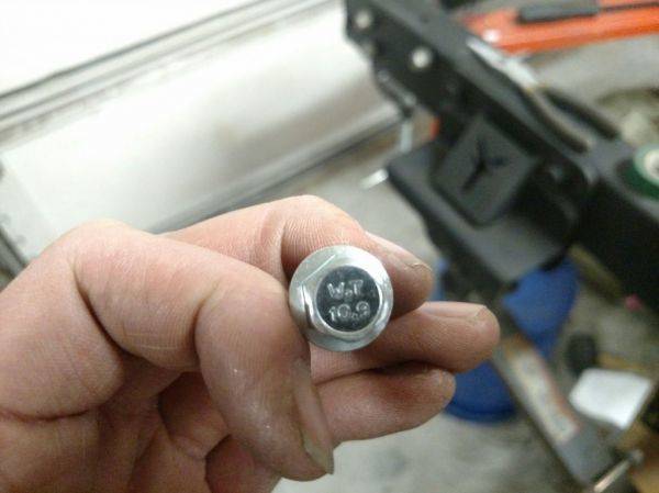

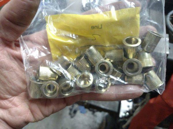

    Got the water tank mounted and some hardware came in from McMasterCarr.
    McMaster Car goodies......:D
    Mounting hardware for the skidplate.

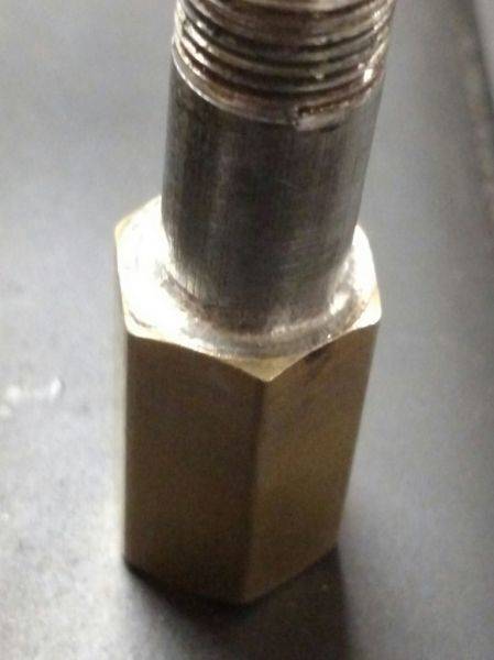

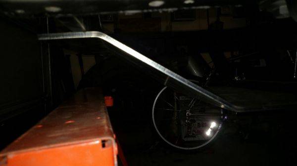

    Had to make my own adapter to go from the compressor to the standard compressor fittings. Should hold pretty well.
    Laid out everything on the skid and was able to snag some pics...
