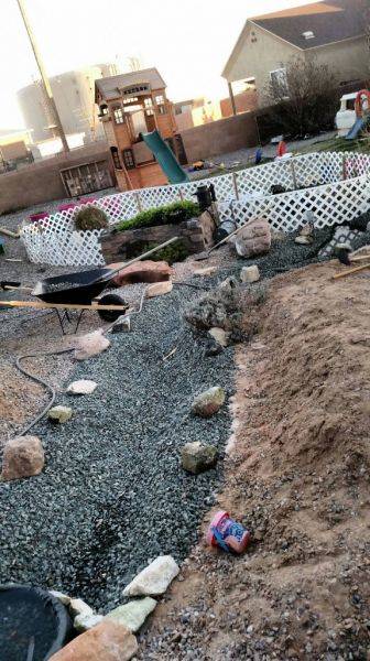

    So I managed to do this to my back.......
    By doing this...........

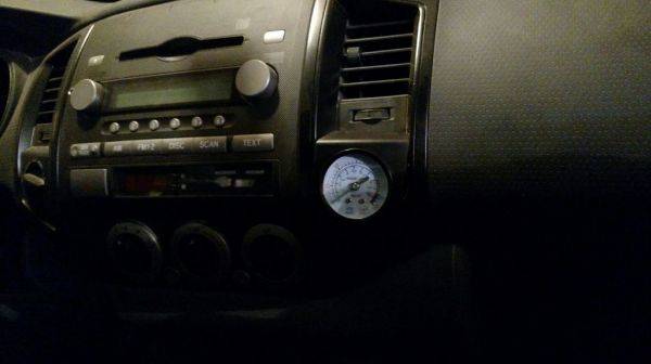

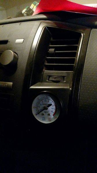

    Oh yeah and I mounted a gauge for the air tank.

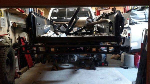

    Bed and fenders are back on.

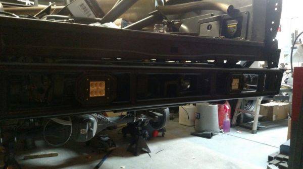

    Rear bumper lights are in.....
    and working. These things are freaking bright.

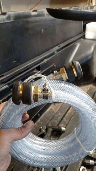

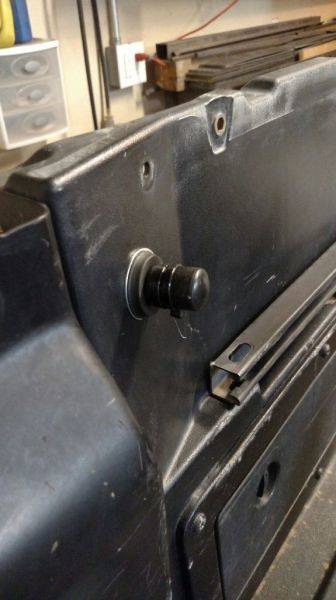

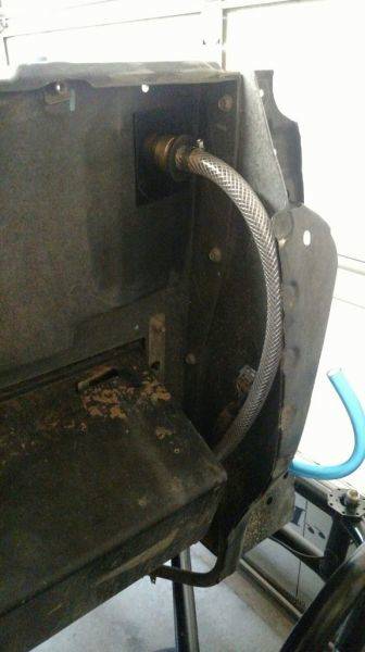

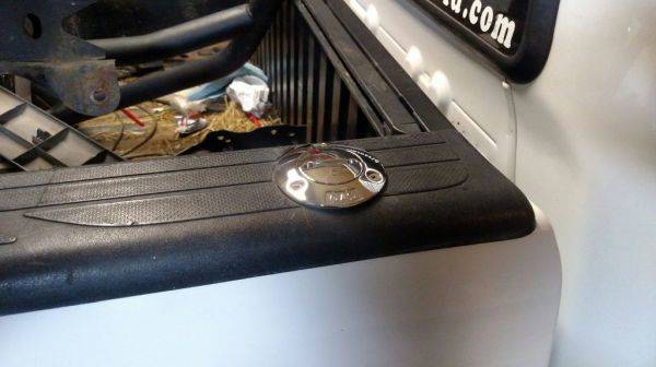

    Water tank till port.

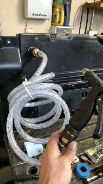

    Shower port and breather hose for compressor.

    Nice work man, that setup is going to be sweet! I might have missed it, but is there a pump for the water or are you pressurizing it?

    Went further back, pump. Any reason you went with a pump over pressure?

    Not really. More of a redundant system. I am going to be keeping come caps with me and if for some reason the pump goes out I can use the air tank to pressurize the system and use it that way. Also wanted to be able to get the last little bit out of it and be able to circulate some cleaning and winterizing fluid when the time comes.

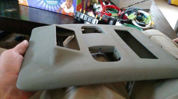

    Upper console switch panel.....

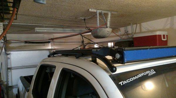

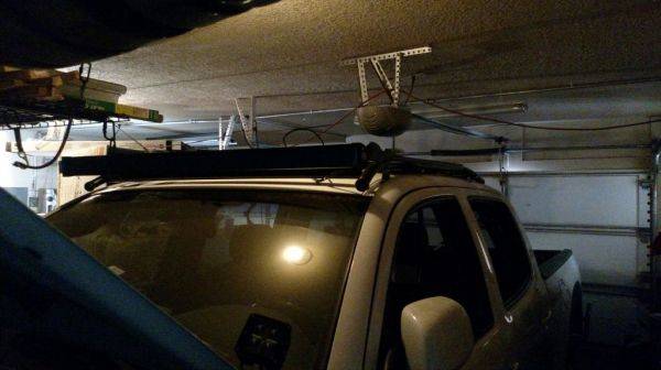

    Roof rack is back on.:D Now onto the wiring for everything. :(

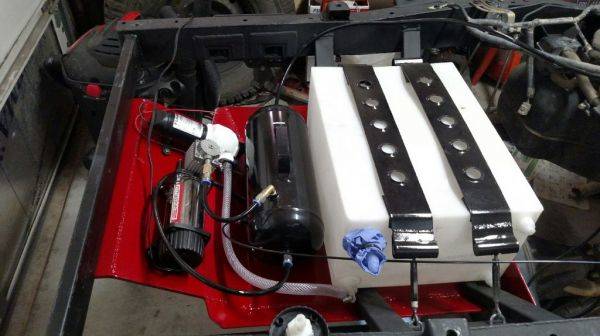

    Dropped the headliner to prep for all the wiring that will get run up there.
    Getting ready for the Dual Battery Install.
    Side view of the Battery tray. Bad pic I know. Stuff getting painted was above it.
    This was above the tray.

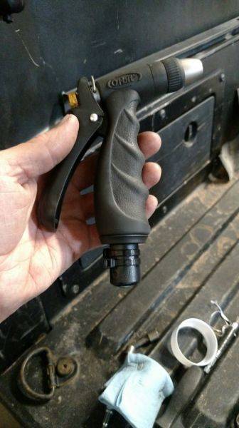

    Just ordered one of these to stick in the @Iggy. switch blank that I got.
