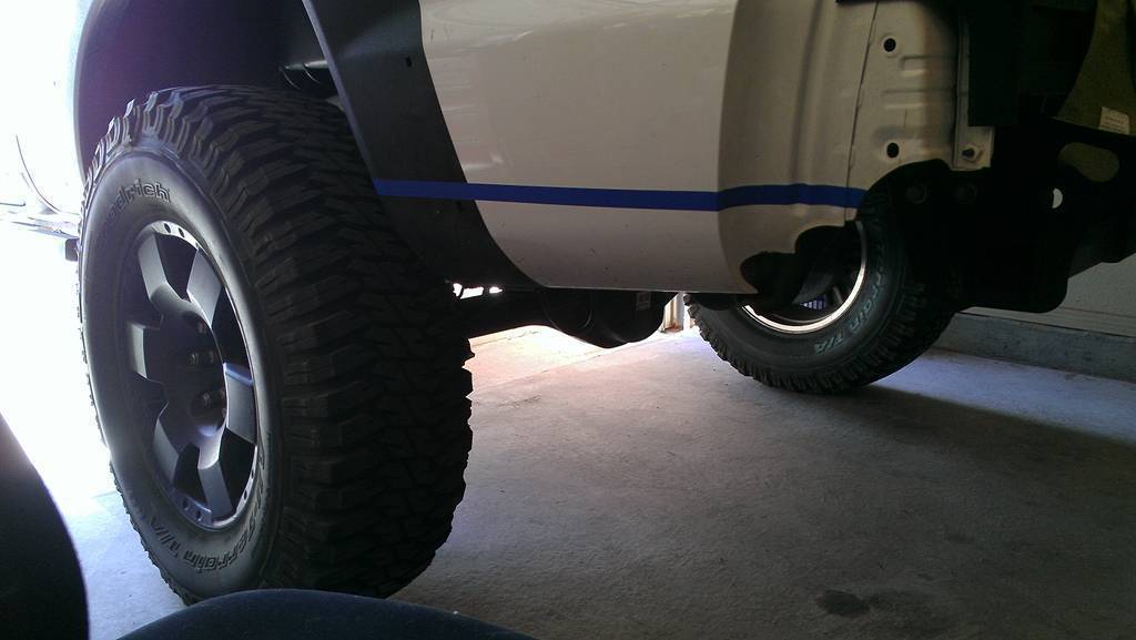

    whitecloud, do you have a rough idea of how much you have in materials for the sliders? Also are you worried that the open square tubing may catch on a rock/tree?

    Each of the tubes are roughly 96 inches long. The ones I build I usually get about 40 ft and end up with about 3-4 ft left over. I do seal the ends of the tubes so that it is a sealed system and they dont catch on anything. I was eventually going to add another brace near the rear of the tubes onto the frame just in front of the leaf spring. But from wheeling with them and landing hard on them many times I haven't had the need to yet.

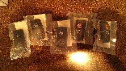

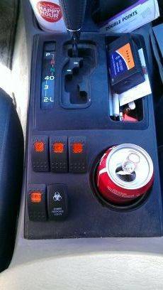

    Switches....:eek::D

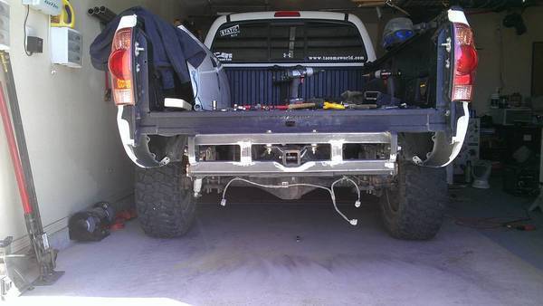

    Got the bumper pulled and the hitch flipped around and no onto the rebuild:cool::D
    This is the basis for the swing away.....
    What do you guys think about putting other ones here?????

    I think you need a least one red switch with a clear plastic cover. Nuclear missile launcher style.

    i like the switches in the center console. Looks like a command center. Where did you get them?

    Those are the covers from the old ones on the dash. You can get the switches and the mounts at http://Otrattw.com/
    The ones on the center console are just sitting there at the moment they do not have anything mounted to them. I was trying to decide if I like the position or not.

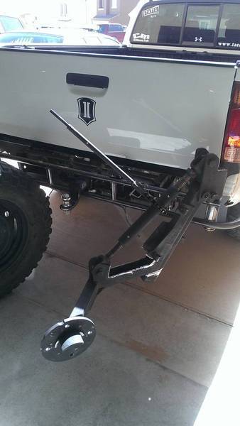

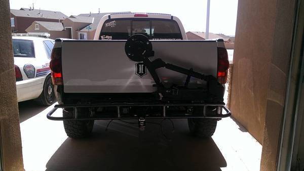

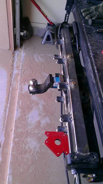

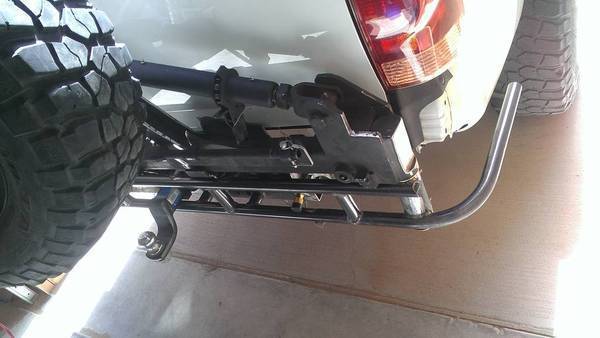

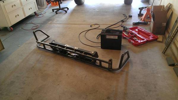

    Progress so far on the rear bumper........
    Start after I flipped the hitch around...
    Added some mounts for the tube.
    Upper and lower tube and the mount for the swing away. Had to grind down a bunch on the swing away to get it to open 180 degrees and have the tailgate still open.
    Swing away actually has a turnbuckle to lower the tire to the ground so that you don't have to pull it off from chest height.
    Pretty centered for the 1st try...
    Had to take a little off the bedsides to accommodate the side supports. Bed side will get a small layer of bedliner to help with the rust. Inside is also braced so that it doesn't move around as much.
    I'll try to post a better pic of the finished one. This is as close as I have at the moment. The curved corners were matched and in as well as a diagonal brace from the front of the bedside pieces to the lower part of the center section.
