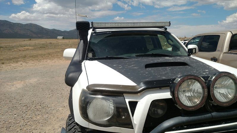

    Finally the snorkle came in and got it mounted. Fitment is pretty good overall and it went together nicely.
    Gramps, G.T. and ERMB like this.
