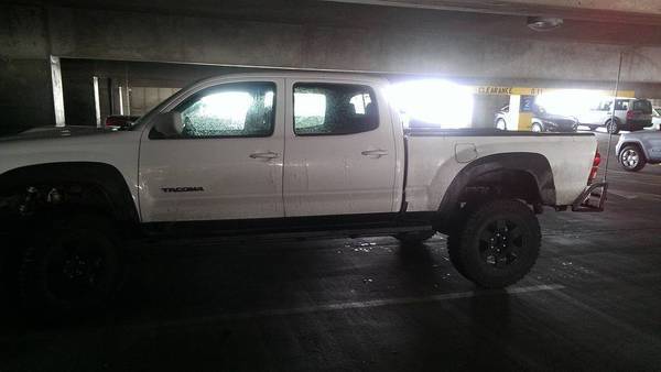

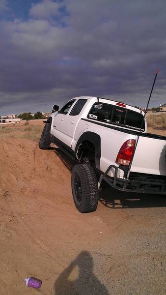

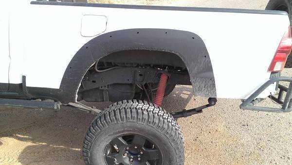

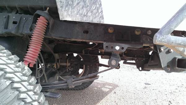

    Some updates.
    Flexing after the shackle flip.
    Full Droop
    Drove it to work yesterday at court and it was a little snowy and icy.

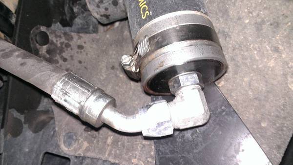

    And my resi is leaking now, and I'm out of warranty.....:(:mad:

    In your opinion is the ato shack flip worth doing??
  10. Jan 15, 2013 at 9:43 AM
    #90
    Whitecloud
    Whitecloud [OP] Cloudy-fabricator of things
    Feb 24, 2010
    #32031
    4,424
    Johnathan
    Albuquerque, New Mexico
    Superwhite 06 DCLB
    ICON Extended travel Coilovers, Custom leaf pack, custom sliders and F&R bumpers, 295 75 17 Toyo Open Country MT's, On-Board air with F+R connectors, On-Board water with quick disconnect shower.Trimmed fenders and body mount chop. LOTS of wiring, dual battery setup, Solar charging system, with some random lights spread around here and there.
    The shackle flips are great I think. It has changed the ride quality and offers better performance. They are a bit of a pain to install due to the rivets but overall are great.

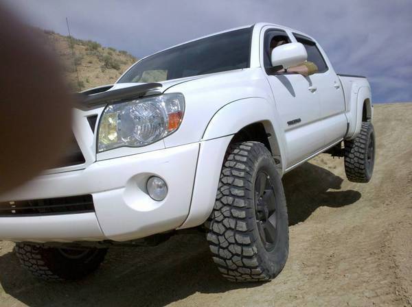

    Before the shocks and flip.
    And after the shocks and flip
    Tires are the same size just obviously different manufacturer.

    with the shackle flip did you have get longer shock or no.
  13. Jan 15, 2013 at 9:53 AM
    #93
    Whitecloud
    Feb 24, 2010
    #32031
    4,424
    Johnathan
    Superwhite 06 DCLB
    Between the two pics above I already needed to get longer ones. Currently I am running 3" over stock. After I put these in I did flex it out in the garage without the shocks attached and the wheels off and I could probably use another 2 inches at least. The droop was actually limited by the brake lines.
    So in short, yes I should probably get longer ones but I'm planning on a shock relocation similar to sytfu510's.
