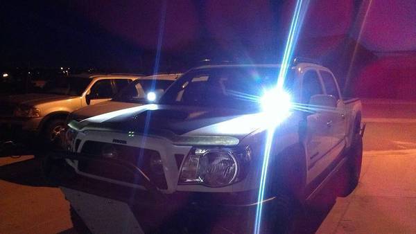

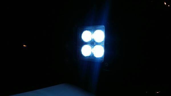

    Finally got some light. A big thanks to Jasper Off Road for some sweet flood lights.

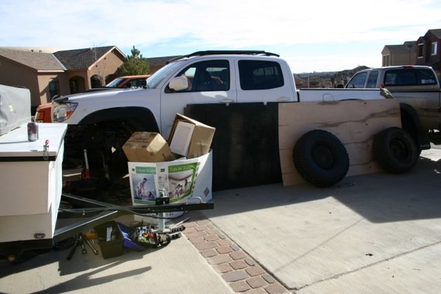

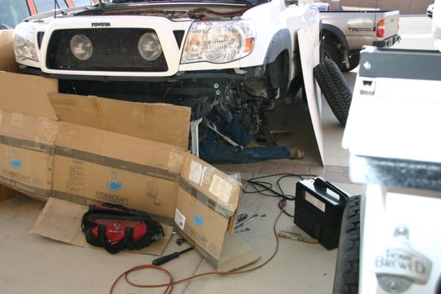

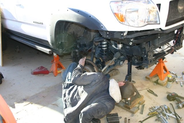

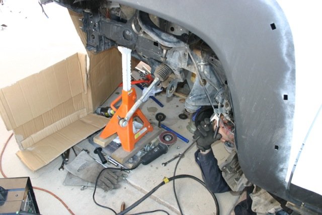

    Front diff dropped and getting ready to weld:

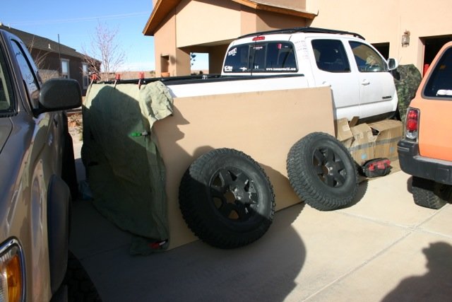

    Wind kicked up and we had to build a skirt around the truck:
    After several iterations we wound up with a nice truck fort:

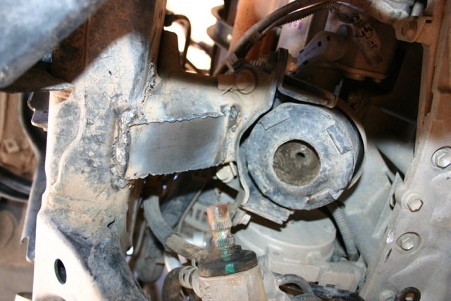

    The motor mount all welded up:
    Getting it back together:
    Took about 7 hours and went smoothly. A good day.

    Nice ass fort. Now for a two story fort. Glad you got it all done in one day

    Hahahahaha those are awesome pics. I wish we could do a 2 story fort. Yeah we were surprised that we got it done in one day.
