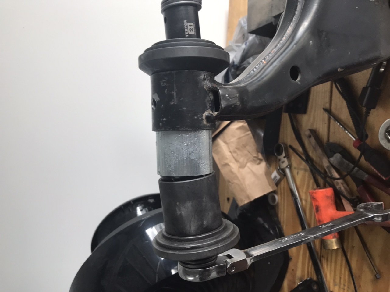

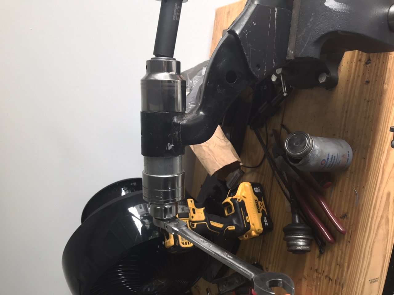

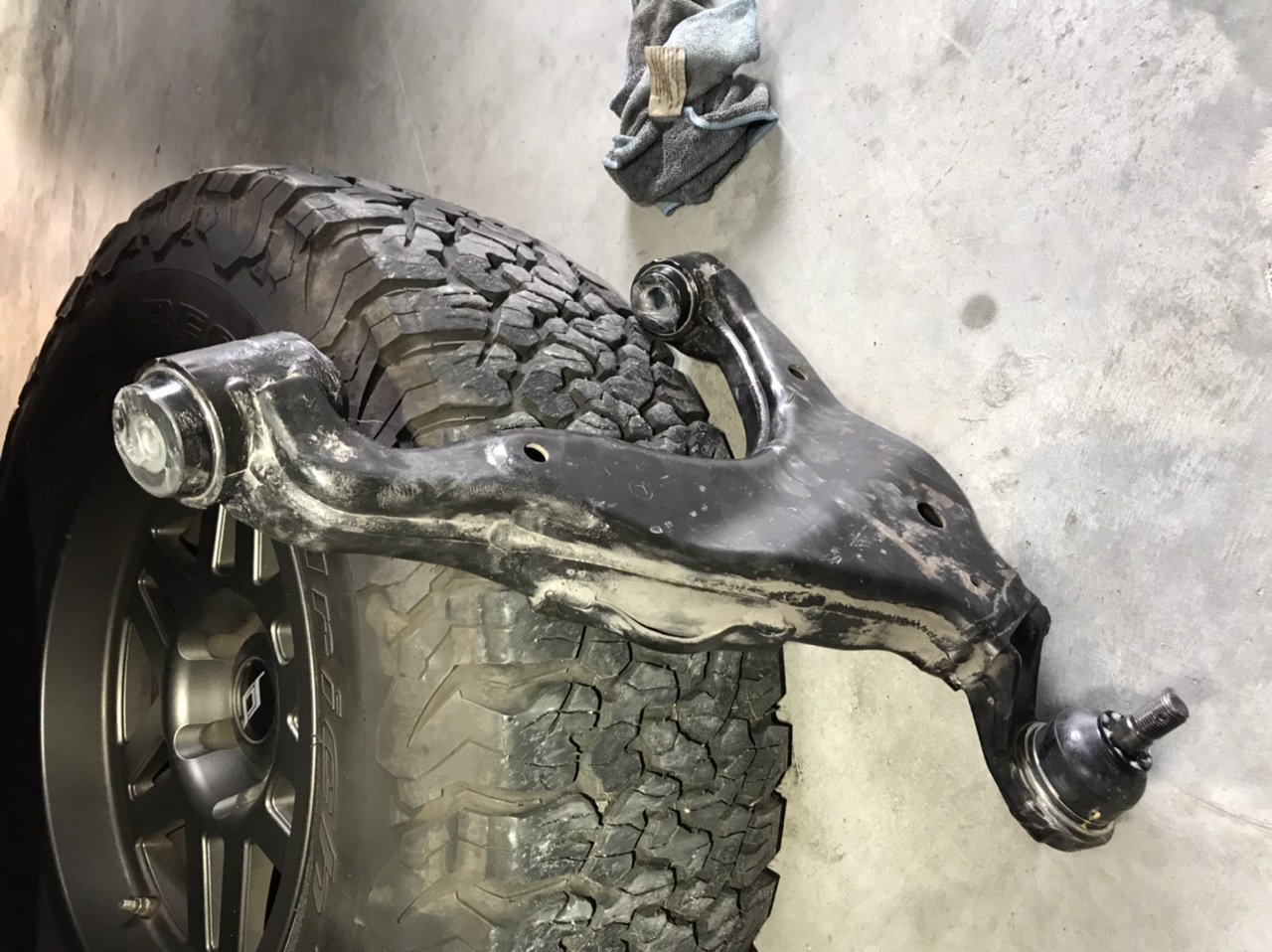

    Just got done with installing these whiteline bushings at home with no press... not impossible but definitely a bit of a bitch. You definitely have to freeze them and need to clean out the ID where the bushings get pressed into. Getting them started it the hardest part, you have to hold your mouth just right to keep the bushing centered for the first 1/2 inch or so.
    Leaving these pics here hoping it helps someone tackle this in the future:
    138D9748-6396-4920-B3DA-48F124513906.jpg D782D830-6776-4925-B755-653507371826.jpg 310FB11B-DC6E-48E4-8780-6611C01C52D9.jpg

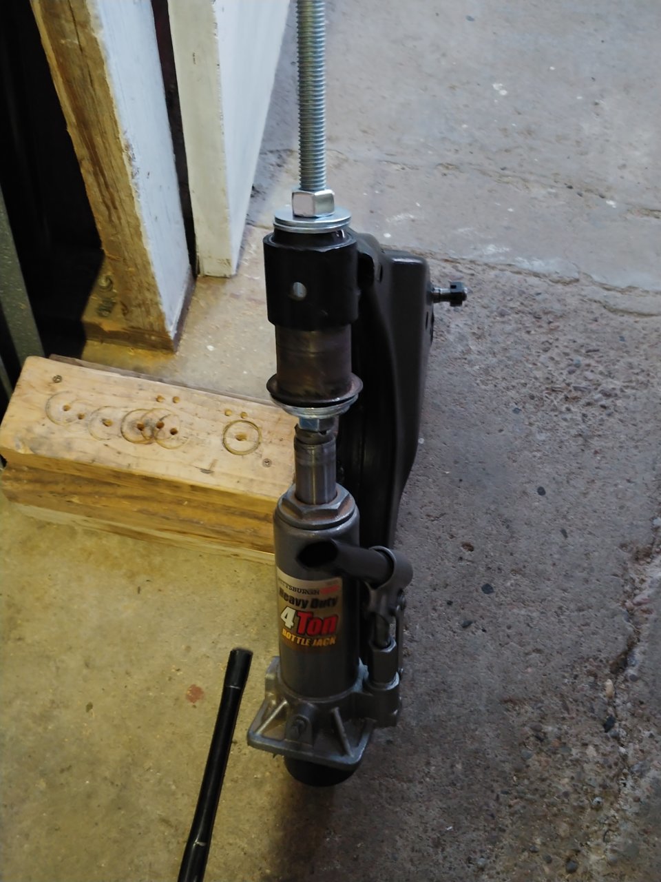

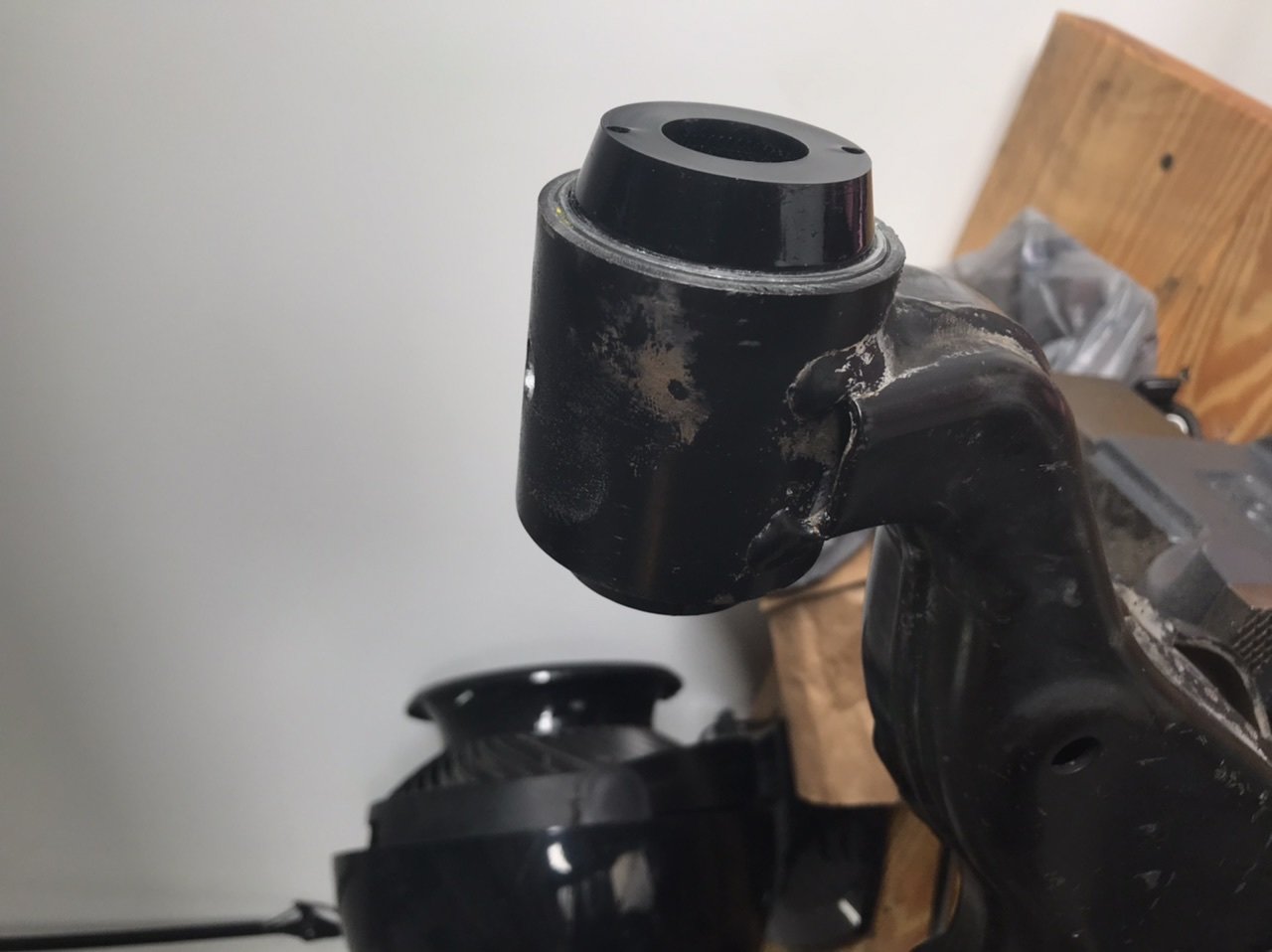

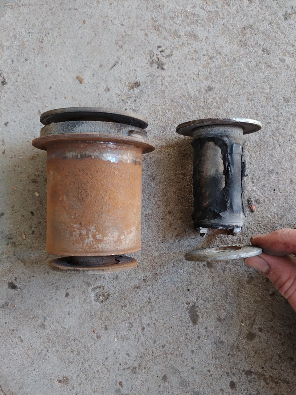

    I did my entire suspension and these were just about the worst part to install.
    I ended up taking the old stock bush and burning out all the rubber so I could use the sleeve to press in the Whitelines. I didn't have any issues with the Whiteline sleeves crumpling or anything.
    I'm happy with the performance so far but I believe I will go another route next time.
    SuperPro maybe. They have complete LCAs or just bush sets. It's all listed for the Hilux though, I'm still waiting on a reply from them as to the compatibility of that product line with our USDM Tacomas.
    I cut out the internal bits like this.
    Used it like this.
    The freezer does help a lot!
