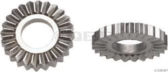

    Did you look into a serrated washer to mimic the OEM bushings, by chance? While I wait for my parts to arrive, your comment has me questioning if that's an option but don't want to waste my time if it's already been discounted.

    The primary reason I disliked them so much was due to the pain in the ass way of greasing them, not the washers. I must’ve been angry at the bushings when writing that comment for whatever reason but I don’t really hate them per say. Just more upkeep and maintenance than rubber.
