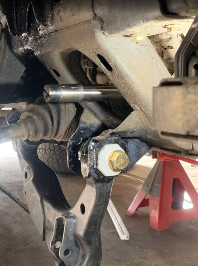

    I have this picture. I wrapped the bushing eyes with some flatbar too. If anyone else does this plug weld where you will drill and tap for the zerk. 2000 psi of grease will find every pinhole in your welds.

    Nice, more solid than mine. I didn’t add any reinforcement, and my zerks are on the inner side of the eye instead of the top.
    Nothing wrong with a little extra grease in there to protect against rust.

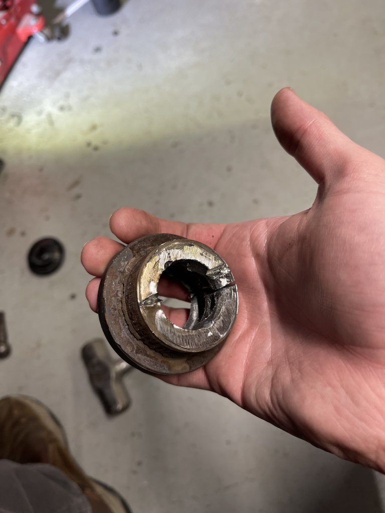

    It was the opposite for me lol pressing out and in the lower control arm bushings sucked big time. I ended up cutting very carefully the steel bushing sleeve, and beating it out. I don't recommend that but it worked. Eventually I made my own bushing sleeve to press the last two bushings out. For the lower ball joints I rented the Powerbuilt Master ball joint kit along with renting the OEM tools ball joint kit. Low and behold not one of those damn sleeves/bushing fit the Tacoma lower control arm. Two days prior I purchased the Vevor 36 piece pull and press sleeve kit and it saved the day! It made quick work of the lower ball joints for removal and install. The threaded rods are suspect but the heavy steel cups/sleeves are worth the price alone. That Vevor kit would have made quick work of the lower control arms bushings also. Im just going to replace the threaded rods with something of better quality.
