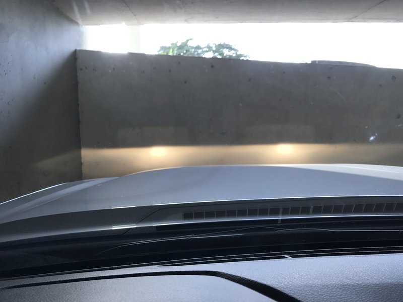

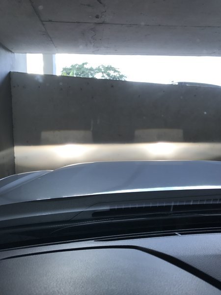

    Hey guys I just did the h11 to h9 bulb swap and I wanted to share it with you..
    What I like most about this is totally oem look with more output
    (Pics taken at daylight but you can notice the difference)
    Bulbs used:
    HELLA H83300052 H9 12V 65W High Performance 2.0 Bulb Kit
    It noticeable the higher output now..
  9. Nov 1, 2016 at 6:16 PM

    How difficult is it to do this H11 to H9 mod, and approximately how much time did it take?
  10. Nov 1, 2016 at 6:56 PM
    #30
    Claudiomartinof
    Claudiomartinof Well-Known Member
    Apr 18, 2016
    #184668
    1,466
    2019 TRD OFF ROAD 6MT
    The most difficult part was to modify the base of the h9 bulb to fit the h11 housing.. I wanted to cut it but in my case (brand of bulb) the base was mettalic and I ended trimming it with a dremel.. you also need to remove a piece of the connector that does not let you connect it to the h11 connector on your truck..
    It took me about 10 mins to modify them and install them.
    Here's the link that explains how to modify the bulb..
    It's pretty easy!!

    That is an impressive difference. Seems like it embarrasses many LED kits I have seen around here.
