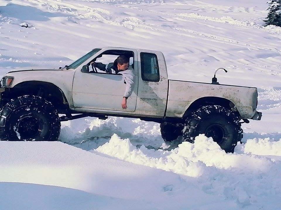

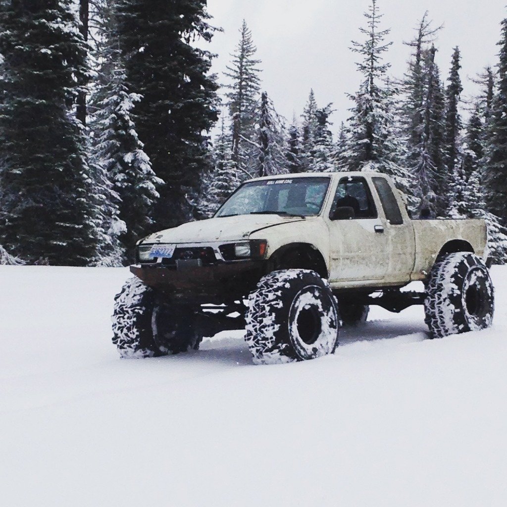

    I drove her throughout highschool as a daily and a wheeler. Senior year of highschool me and a buddy did a SAS on it using basically everything from the Trailgear catalog.

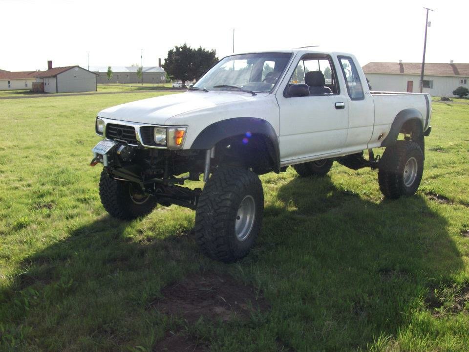

    Now that I had a daily I could turn the Toyota into a full time wheeling rig. The 1st rebuild commenced. Lowered it 3" front and rear 39.5" iroks, Mercedes OM617 swap, Duals and many other things I'm sure.

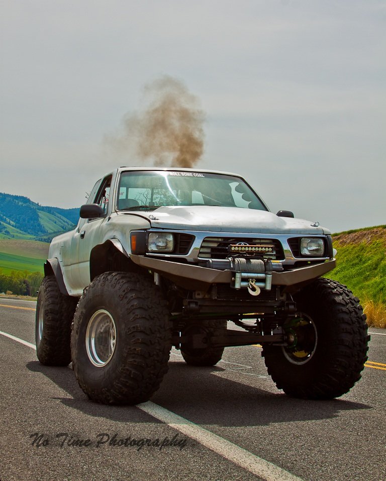

    Traded the 39.5's on 15x12 aluminum wheels for 44" TSL's on 15x14 Bart Super truckers. Wheeled it some like that.

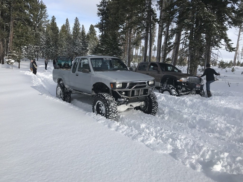

    The mountains were farther away than back at home, and not wanting to trailer it everywhere caused rebuild #3 to happened. Ditched the bobbed bed and 44's for some 37" mastercraft MXT's (awesome tire for cheap).

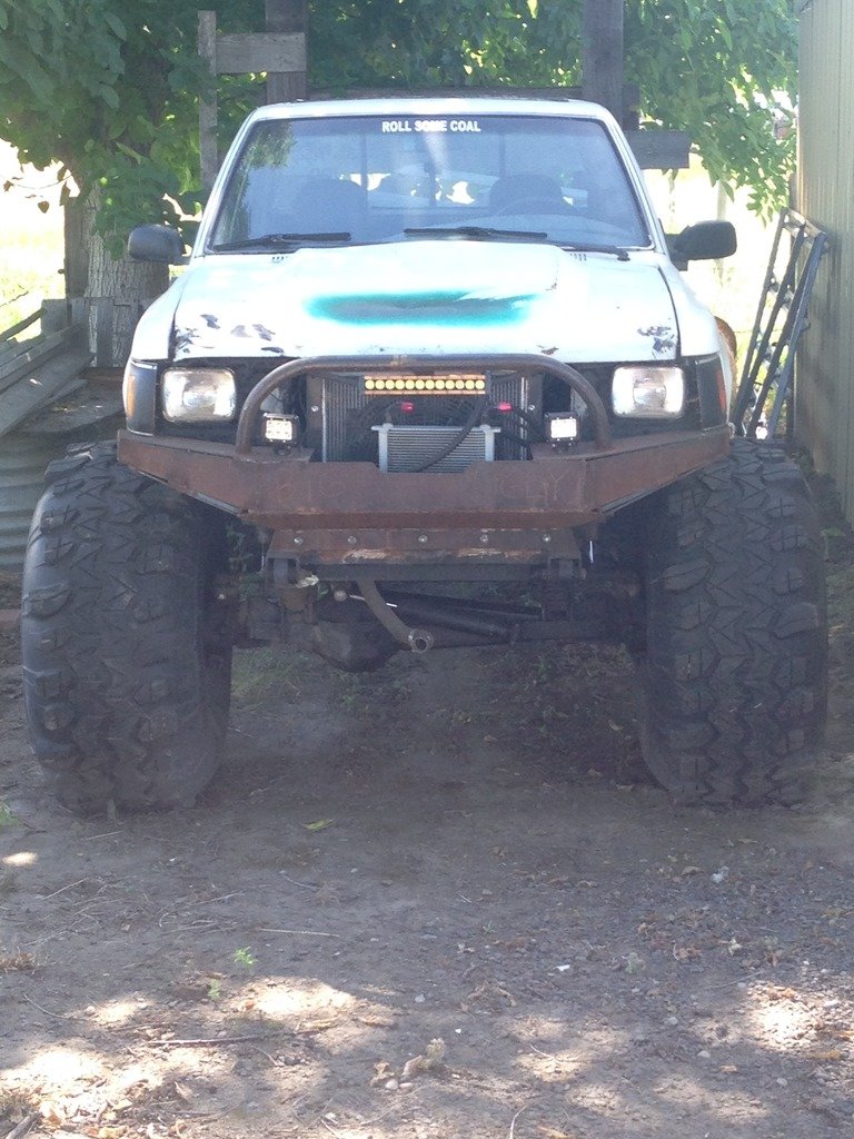

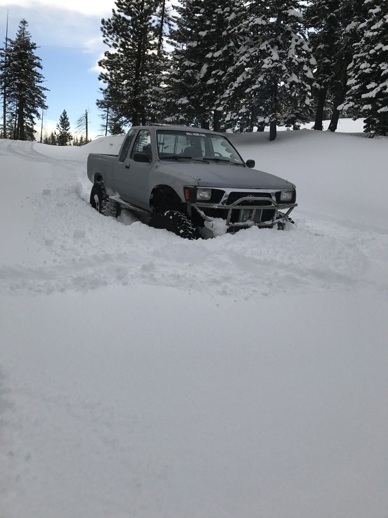

    Started to try and paint it as well. Wheeled it like that till February 2017 when I blew rings out of it on the highway and lost all compression. Parted it out saying a sad goodbye to a good friend of 8 years.

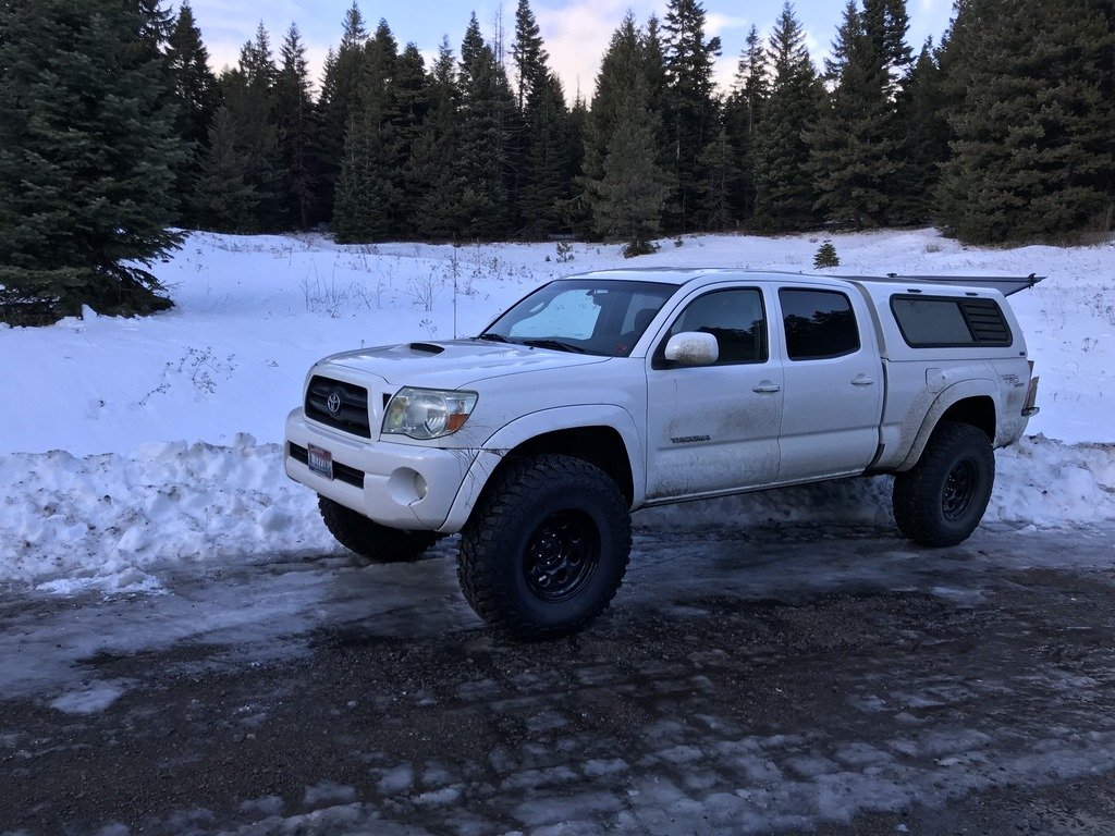

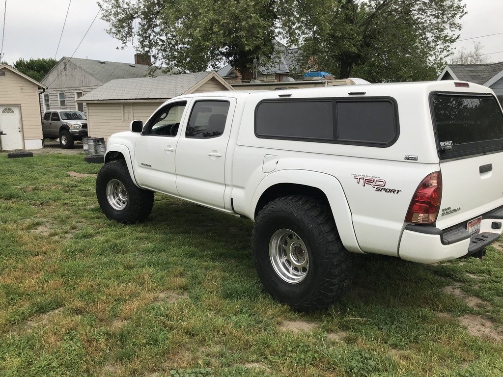

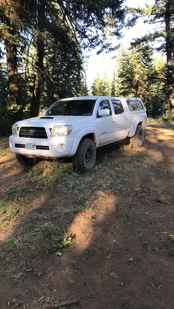

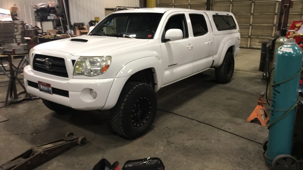

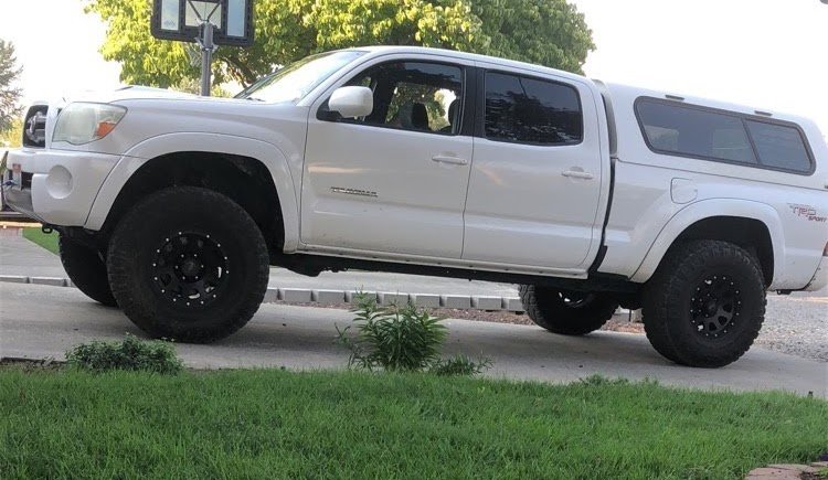

    Which Brings us to July of 2017 when I picked up my first Tacoma!
    2007 Double Cab Long Bed TRD Sport Package with a snug top canopy? (If anyone can identify my top that would be cool). Couldnt wait to get it dirty and take it camping!
    E5A24CBC-A096-437A-9614-7ADBDA1F69CB_zps_9f2a1cb0baef592e06aa3e536a6d2add6c18c588.jpg
    381292EF-C127-4FF0-B4F7-874E14EDE4AA_zps_11728b5ea884c0aea932e02ae5e24ade5c9d530c.jpg

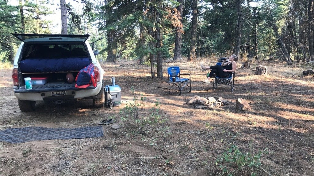

    No camp fire during forest fire season. Also did my first mod! Built a platform for the back, super simple design.

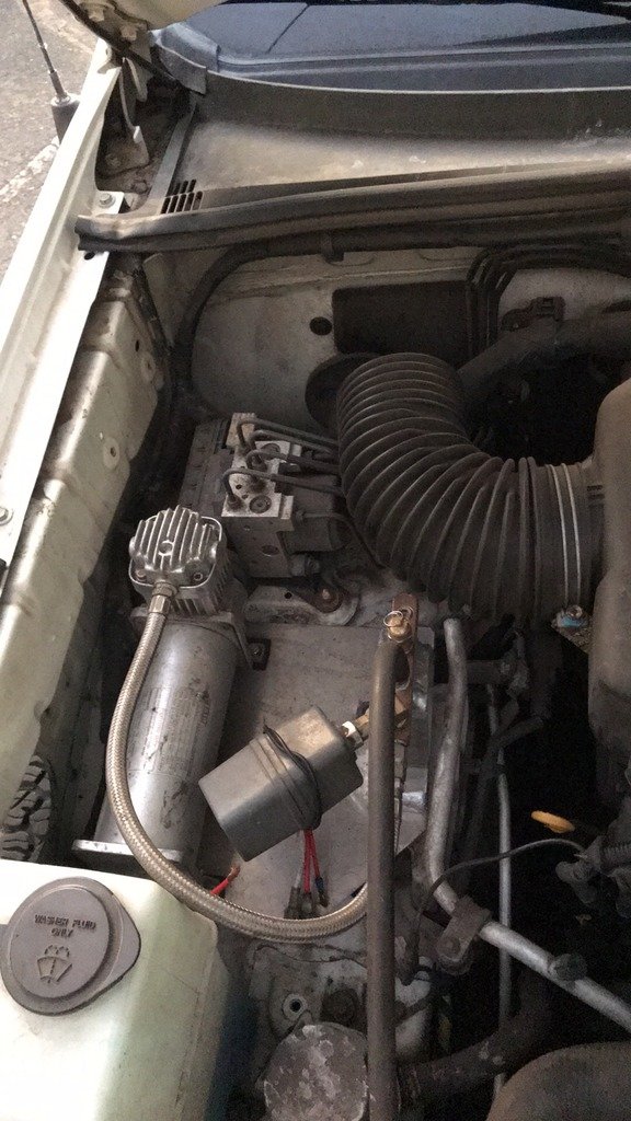

    Wanted to mount my viair somewhere too but didnt want to take up the driver side bed cubby like most so I came up with this. I plan to do a URD true cold air later to fix the intake but so far the filter isnt getting dirter any faster pointing this way.
    652A4965-9B9B-4304-B2FB-E17D3B16E215_zps_bbe92a791db79bf76979b15c2c4fe47eea10f0a0.jpg

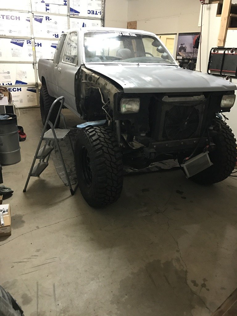

    Got the 37's mounted and some of the firewall clearanced.
    Went and had some fun.

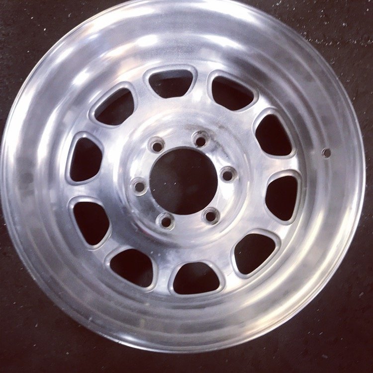

    Here is where the build kinda starts off, I got the tires and found a set of old school Eagle Alloy Wheels that have -25mm offset to keep the tires off the UCA's. I polished the wheels up and played around a little till I got them mounted.
    AD15A938-AC3F-4656-AD6C-2743DEF55241_zps_6eea8360a69139eaa8e3111fa122f22e01bc411a.jpg
    DFEC05E5-0A20-4939-823F-695398EB77F0_zps_e942c43b35e2511fdc1d5e813474d7a80e5d0389.jpg
    A993E42D-B544-4D63-91C1-594C995CAB47_zps_54511628dea5b515bb430dc636a2e8cb28c18f9b.jpg
    F879B45D-D4CC-403E-AAD9-AE1343FE24CB_zps_3e74044ef285461b2200f1ff8e939d89d336ac80.jpg
    1F2FE0FE-09A3-4169-90A7-BA7CC97875DF_zps_e60aa174568979f4b95b6052d2f8c09202821264.jpg

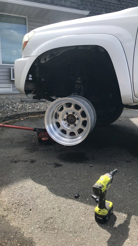

    Then I got them mounted up and mounted on the rig. Looks awesome but lots of clearancing to be done still.

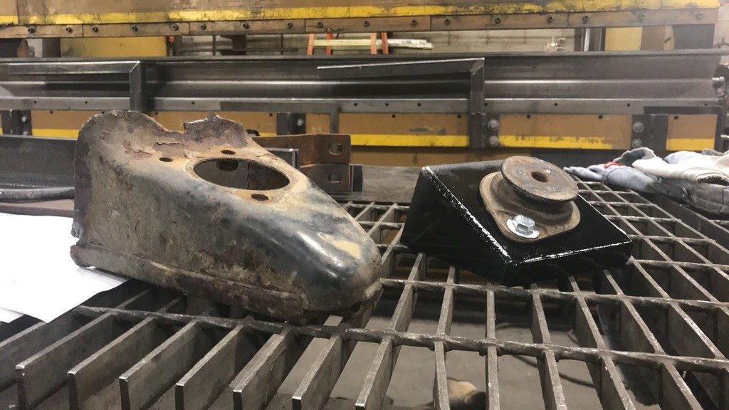

    Also scrapped my rusty stock bed supports after I cut the fenders since they were too short now. Made these out of 1/8" aluminum turned out pretty good I think.
    82CC9F0F-0E55-424A-8E48-7CCC37FD668C_zps_7da7616c19a04aea20e9585b6e182289796142c4.jpg
    214AFC17-583F-4C05-A63D-31C98FF3B7AB_zps_ece159a53517be66ae579fe187c8e2f2978d24c0.jpg

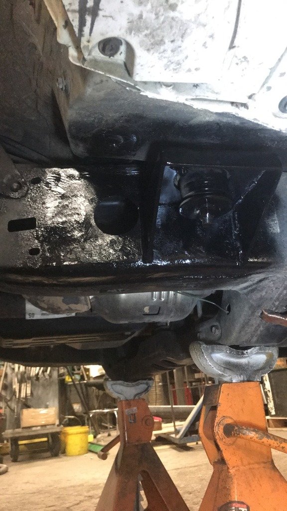

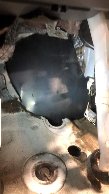

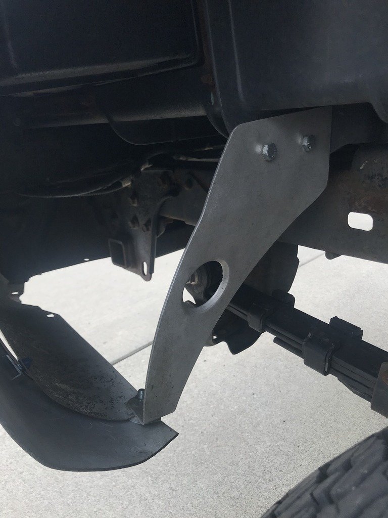

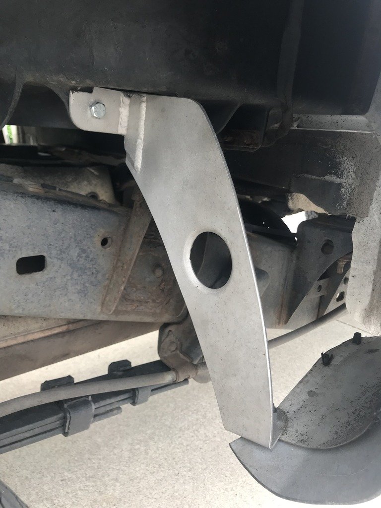

    I’d like to see some pics of the body mount from inside the cab. Did you simply just drill a new hole when you relocated it back some? This mod is next for me so I can stuff some tiny 37s under my regular cab with minimal lift.
  18. Sep 8, 2018 at 10:22 AM
    #18
    whiteyotaguy
    whiteyotaguy [OP] Well-Known Member
    Jun 24, 2018
    #257372
    55
    2007 DCLB Sport
    Not the best pic but ill take more before I finish the tub. I moved my body mount bolt 4.25" back from stock. Little overkill but itll never be in the way again!
    Front hole is the factory hole, well half of it. second hole is my new mount hole. The body is multilayered there so i just holesawed enough to get the washer and a socket through. I think theres still 2-3 more layers of sheet metal before the body mount. so far its holding up good! might add a 14ga plate to the underside when I install the body lift just for piece of mind but im not real worried. hope this helps ill try to get better and more pics soon.

    That works. Thanks for the pics. And holy shit did you tub the fuck out of that firewall. Mine is getting 37s for now, then 40s when i SAS it next year. That will let me move the axle centerline forward some to get it out of the firewall. I will still have to tub it to fit the 37s, but hopefully not as much, lol. Nice work.

    Haha yea I ran out of firewall to cut out. For 37's all I did was the body mount relocate and cut the pinch weld off and pound the firewall back. Still rubbed some but not terrible. body mount is in the way of having fun.
