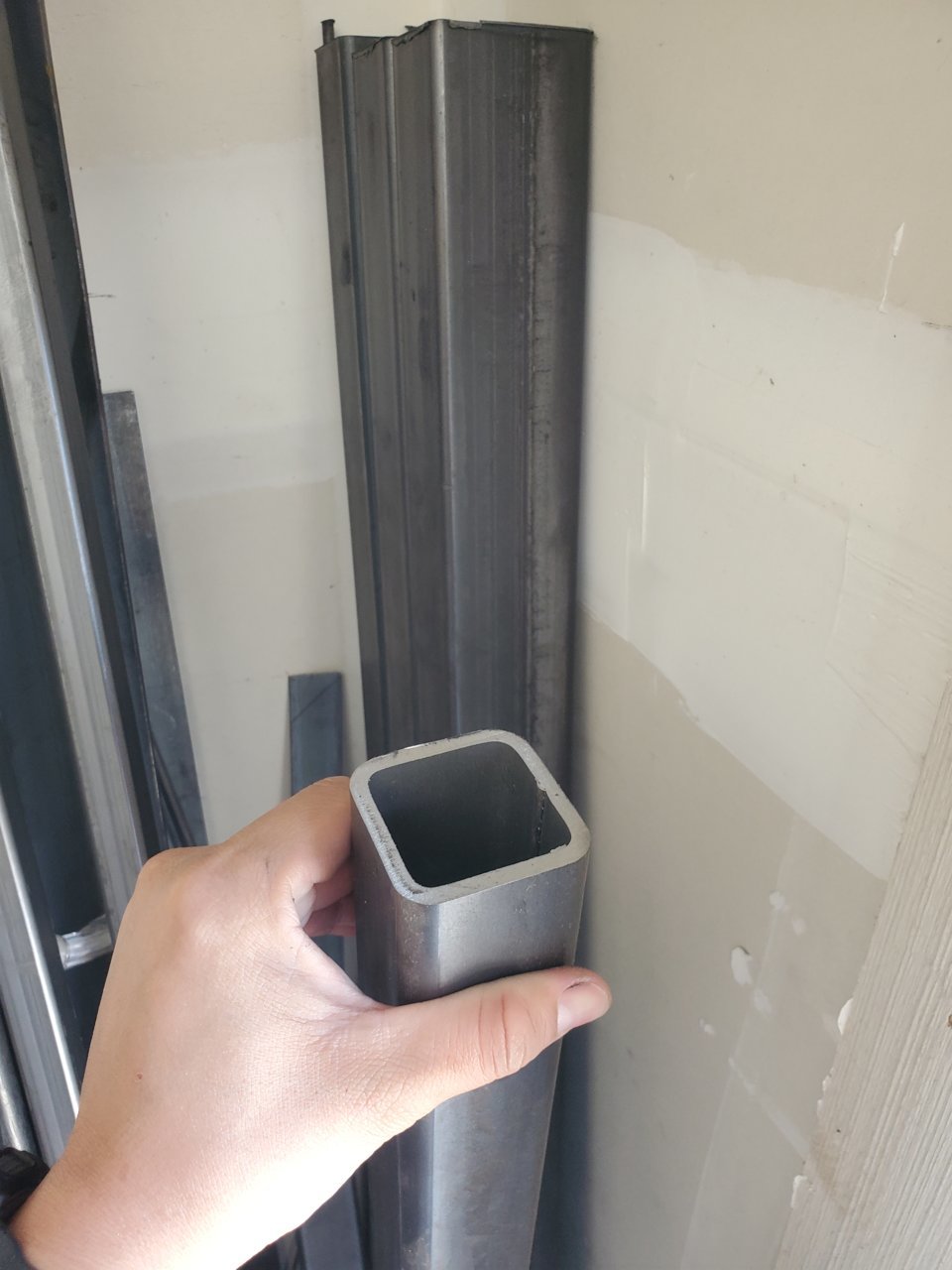

    It's also the way the mount itself is attached to the rest of the bumper.
    All around looks like a bad design, and I'm just an at-home welder.

    My choice in material would have been a 2" square tube at 3/16" thick or 2" x 3" rectangular tube at 1/8"
    Then gusset that thing at each end

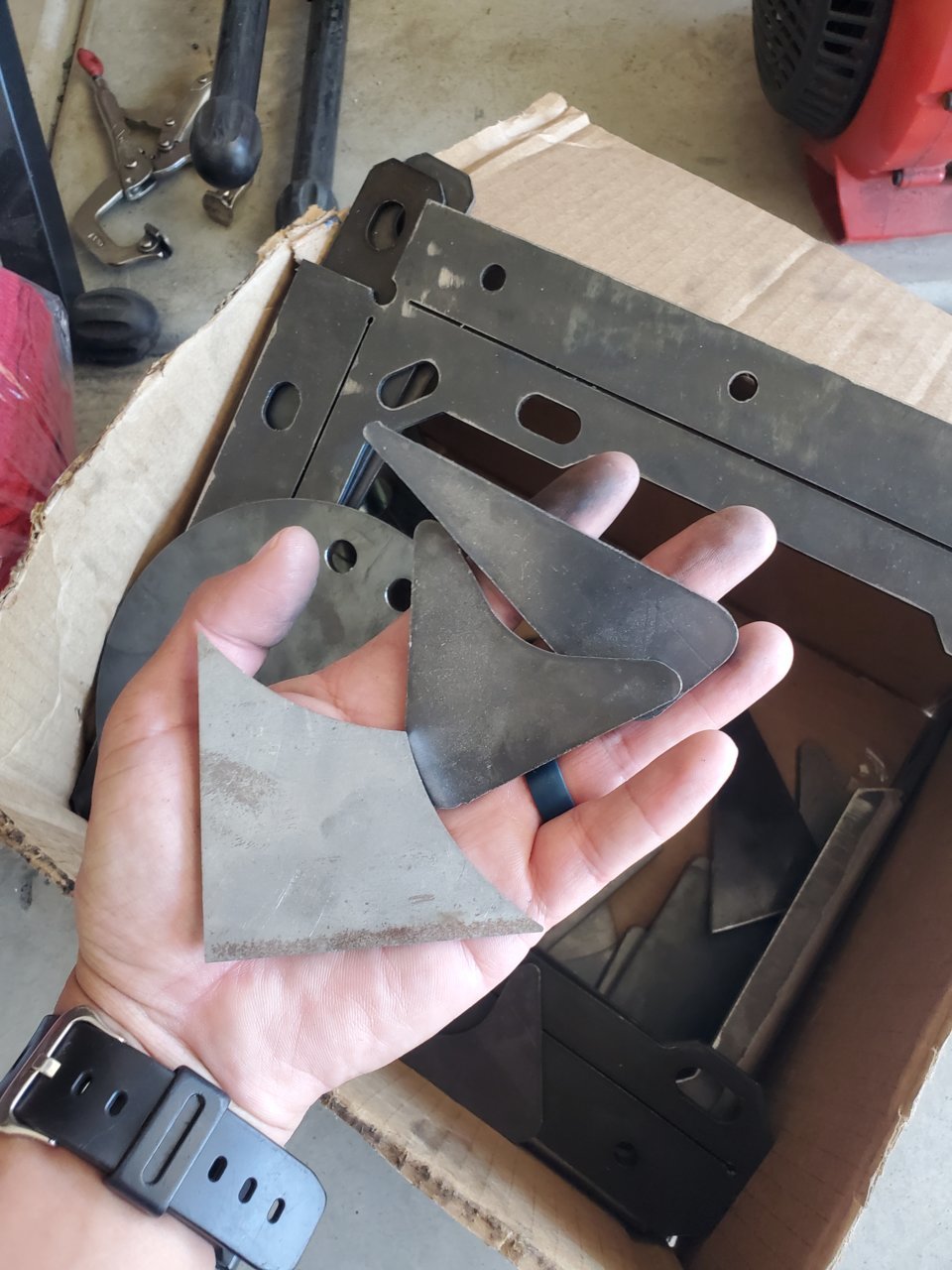

    I think they’re trying to budget on materials by using laser cut plates instead.

    There is no way that square tubing is more expensive than that mount.
    Personally I like the KISS method when doing things like this. No reason to reinvent the wheel.
    Good thing this is an easy fix.
