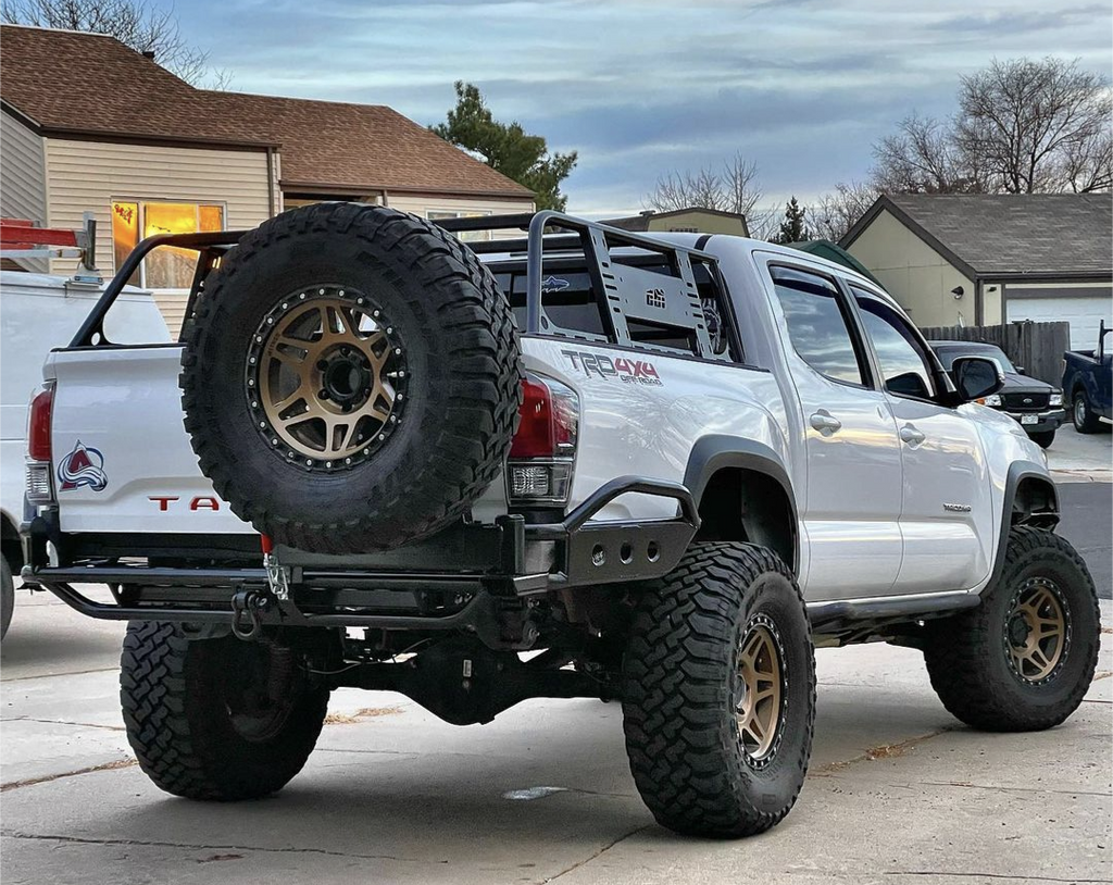

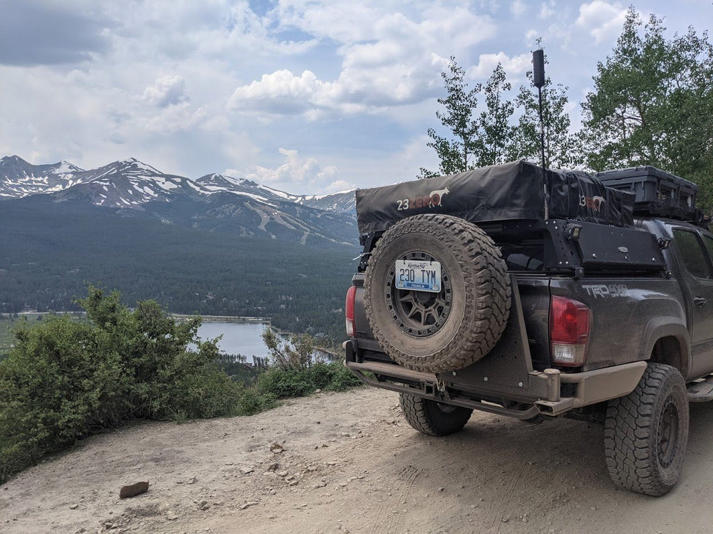

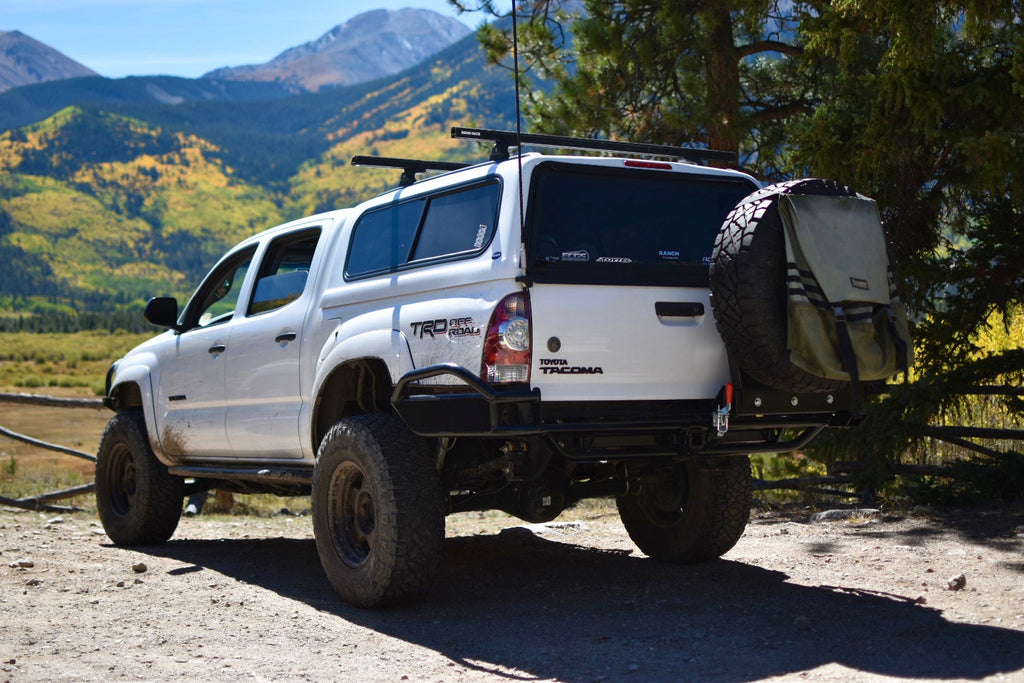

    i'm conflicted at this part. i've avoided ordering a $50 part over questions on build quality. it never ceases to amaze me how few usable pictures these companies can post of these multi-hundred/thousand dollar components that lack pictures to justify the price point or their manufacturing quality, or even indicate all the options within the dropdowns offered. this isn't a 'bleh, warfab sucks!', this is an industry-wide frustration for me.
    here's all the pictures regarding tire carriers off their website that can be used for knowing what one is ordering. there's really nothing to go on here to indicate how the tire mounting plate attaches to the swing arm at all until the unit is paid for, waited, custom-built, and sent out, well after most return windows. skipped here are pictures highlighting the hinge mechanism that they take specific pictures of the pivot assembly.
    overall, this situation really sucks. it sucks for warfab to get dragged around. it sucks for the OP to be spending all this money on something that he had to assume the quality of based on the price point(my biggest frustration here is that this is an industry-wide problem, not specific to any one company). and now the OP is trying to move on with their build, warfab is trying to keep the doors open and new customers coming in, and the same nasty problem keeps rearing it's head to all parties.
    putting myself in this situation, i can see the conflict the OP has. he had to pre-pay to get the product. it wasn't cheap. but he couldn't know of the design until it's already built, delivered, and fully paid for months in advance. and now it needs modification just to exist in a world outside the mall parking garage.
    normally, i try to locate something that fits my needs the closest, and factor in the price of the component with the alterations i need to make to meet my needs vs the better/higher end model that might better fit my needs, but costs significantly more. in this case, the design couldn't be known until money was spent, and the whole thing showed up one day.
    disregarding the whole powdercoating issue and dealing with it only from a fabrication/ordering standpoint, i guess the best thing here is really just to swallow the pill. fix it, make warfab know what specifically you're not happy with, and how you altered the design to better fit your requirements, and move on with your life.
    no one ever said learning experiences are cheap, i guess.
