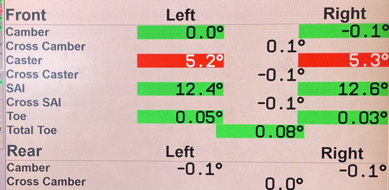

    I have the Blackhawk UCAs. Very well built with gussets. OEM bushings. Greaseable balljoints. Mounting points for the ABS cables. Checked all the boxes. Only downfall is they have at least 3 degrees built in caster and I got pretty much the same #s in as the above printout which caused a rub on the cabin mount. The lowest caster I could get with the camber still in spec was 4*. I have a 2" lift up front.

    I’m still on stock wheels and tires. What is your wheel size/offset and tire size that rubbed? Did you chop the cab mount?
