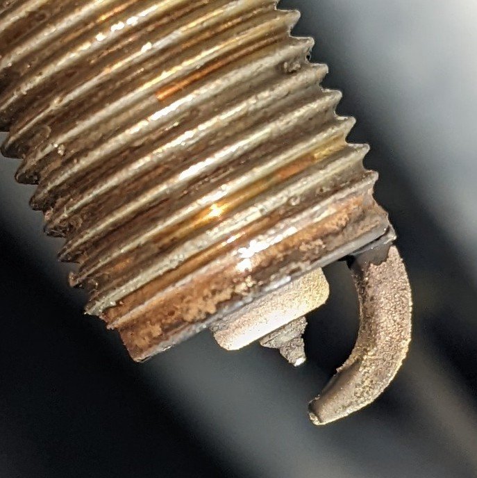

    I ran NGK iridium IX (lower grade iridiums) plugs in my truck for about the last 5 years, probably about 60k miles with zero issues. Within the last month I could tell they were getting worn out, could feel a bit of a "miss" at idle and MPG had gone down noticeably so I changed plugs and went with NGK Ruthenium.
    My gaps were between .055 and .080, factory is .044.
    I've had no issues with the Ruth's so far and did get some MPG back and the butt dyno says a little more power, they're supposed to be better performance than the Iridium IX's but cheaper than the higher end Iridiums.
    Definitely running smoother now than the old iridiums but can't make a comparison new to new given the time passed.

    Bruh yo gaps.
    Gon be like .10
    :bananadead:
