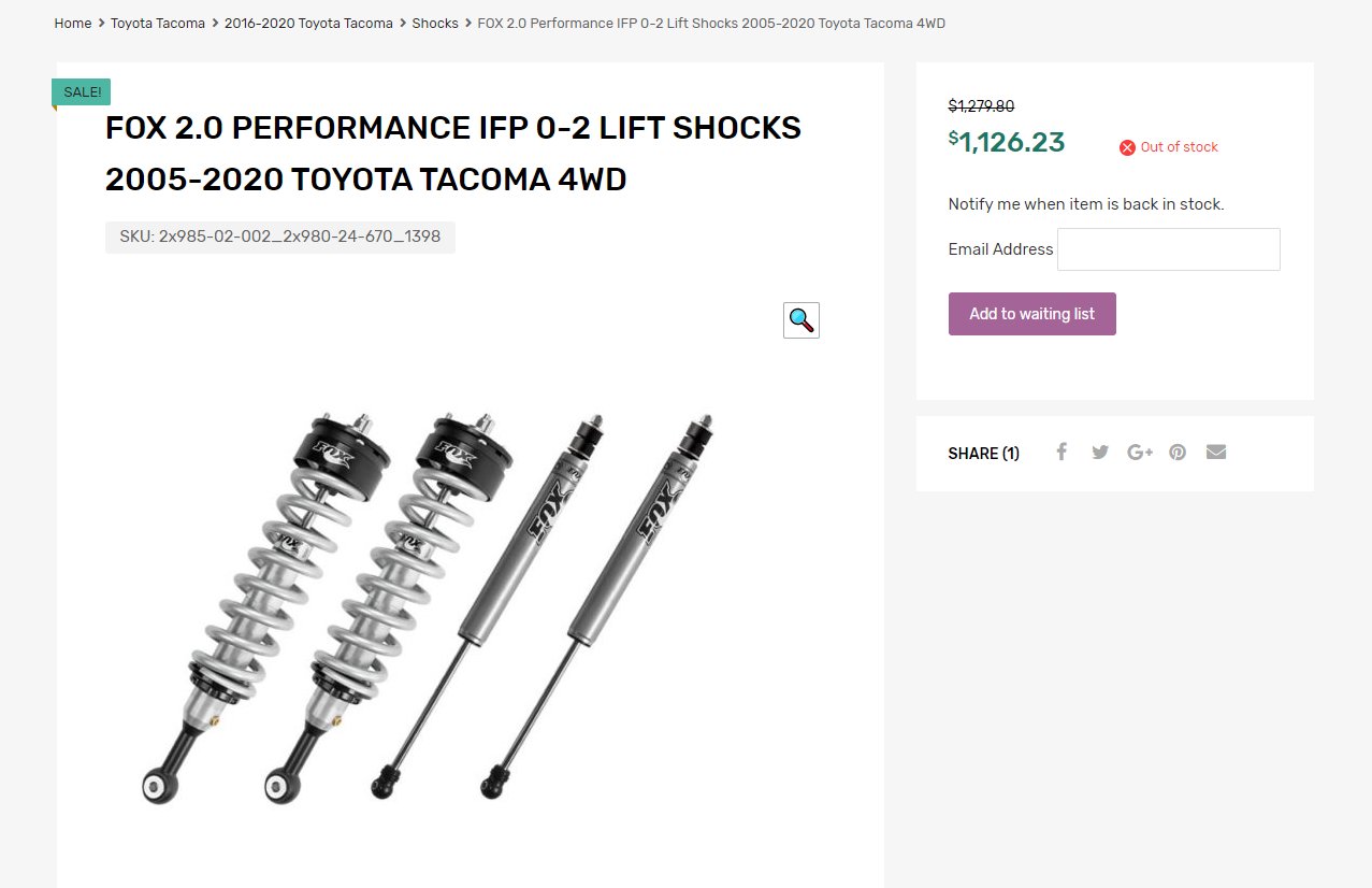

    Finally had a minute to get some prices. Would save at least $1500 and have a really good ride on and off road with this setup. Yes it doesn't have the leaf springs but he can add a leaf kit he wants for ~$500 and still spend $1500-2000 less then the King kit.

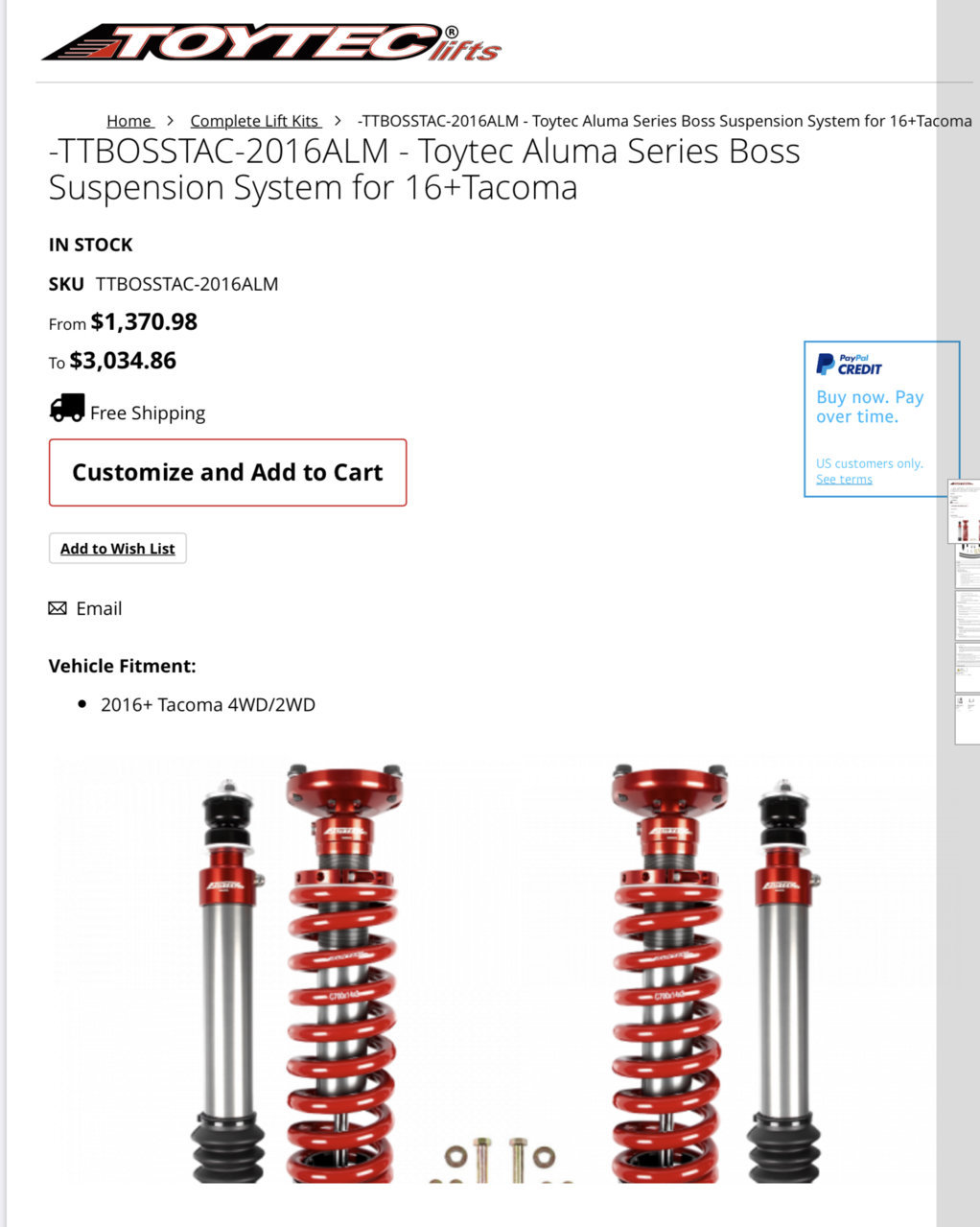

    Toytec 2 inch boss lift
    Have you looked into the Toytec Boss? I have the below and also wheel in Colorado and they do great. I do stick to Moderate rated trails and below with an occasional 7-8 difficult but don't like the stress...lol. Their shop is right here in Denver and their service is great.IMG_1645.jpg
